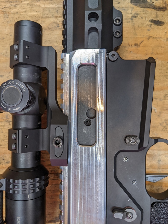

Here's the side plate installed on the upper. The right hand charge model wont have a slot on the side plate. The ambi unit will have slot like the left hand charge model.
i.php
No dust cover is needed at all. A MCR bolt seals the ejection port great. Our own BCG will also seal the ejection port.

It would be interesting if a .625 piston gas block was available, we could test this out with a faxon pencil on one of these 180 platforms. I dont think itd be much less accurate than in its DI form, reasoning being that the bullet should be out of the barrel before the piston starts any substantial travel rearward.
No plans for brass deflector? Also, I like to think dust cover is ideal even if the BCG was to "cover" the inner part of the rifle since whatever is collected on the exposed surface of the BCG is prone to entering the inside if not wiped off before firing, but it might be just me.
Dose the top of the rail on the upper line up with the rail on the hand guard?
Not perfectly. There's a lot of variance between different handguards. But it always gonna be a tiny bit high, but it's close enough that it doesn't matter. We had to make it a bit higher to offer to make the rail to proper spec so all optics mounts work. We are looking at making some handguards for this upper.

You really don't need a dust cover. Keep in mind there's a gaping hole on the other side of the receiver for the charging handle. It's just for looks on a 180. Personally I've never had an issue with dust and dirt ingress running 180's in 3 gun matches in all conditions.

We did some upper testing today. Our upper runs great. ZERO FAILURES.
The production model of the upper will have a brass deflector.
We tested it with both WK and MCR internals.
We also did a snow test. Ran flawlessly.
