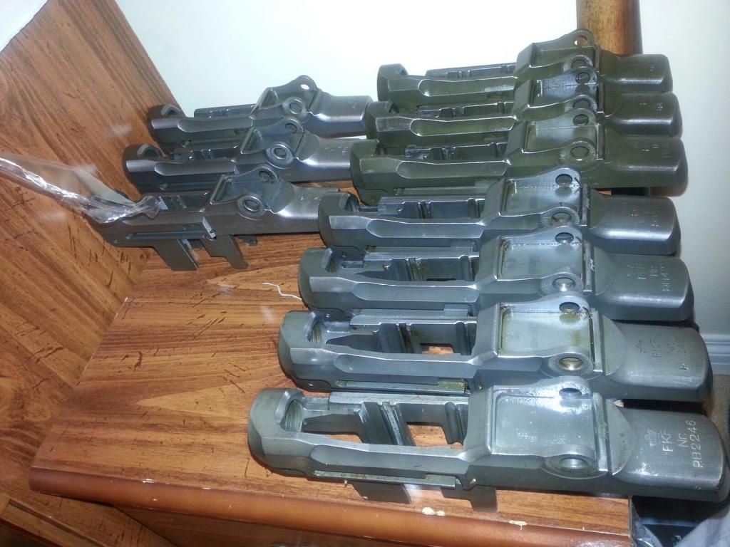

I must respectfully disagree. I bought 14 receivers and some of the Bredas are green; others are dark black and some have no finish at all. Some of the Berettas are green; others are dark and some have no finish at all. But all are free of corrosion and all are in excellent condition and all are wonderfully suitable for building a rifle.
Here are some of my receivers:
Here is another picture of some of my receivers. Notice the different colors:

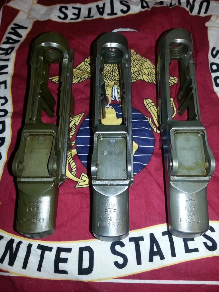

And here's a picture showing some nice green Parkerizing on a Breda. And take note that the other two receivers are Berettas and that they lack finish.

I agree completely with you that the consistency of the finish will vary. I think that Breda and Beretta cooperated in the manufacture of receivers. I have one receiver with a PB serial number and Beretta markings that is also marked "BMR". The "BMR" appears on the right side of the lower receiver near the drawing number.
The different colors of the various receivers just makes it all the more interesting.
The different colors come from being stored differently, they were all parkerised the same during manufacturing. Long term cosmoline storage will cause that green tint....
I've owned quite a few of the ex-Danish rifles incl Bredas, Berettas, Springfields and Winchesters. The Danes did re-park many of them when they were overhauled, hence the color variations in the Parkerizing. Parkerizing colors depend on the type of Parkerizing used, the strength of the solution, the type of surface preparation, the preservation used and the level of wear after parkerization.. The original Breda finish was a somewhat translucent French grey.
You see the Breda "BMR" stamping on the right side of many Beretta receivers over s/n 5000 which indicated that Beretta subbed out a lot of their receiver mfr to Breda. The higher s/n Beretta receivers also show tool/machining patterns very similar to the Bredas.
