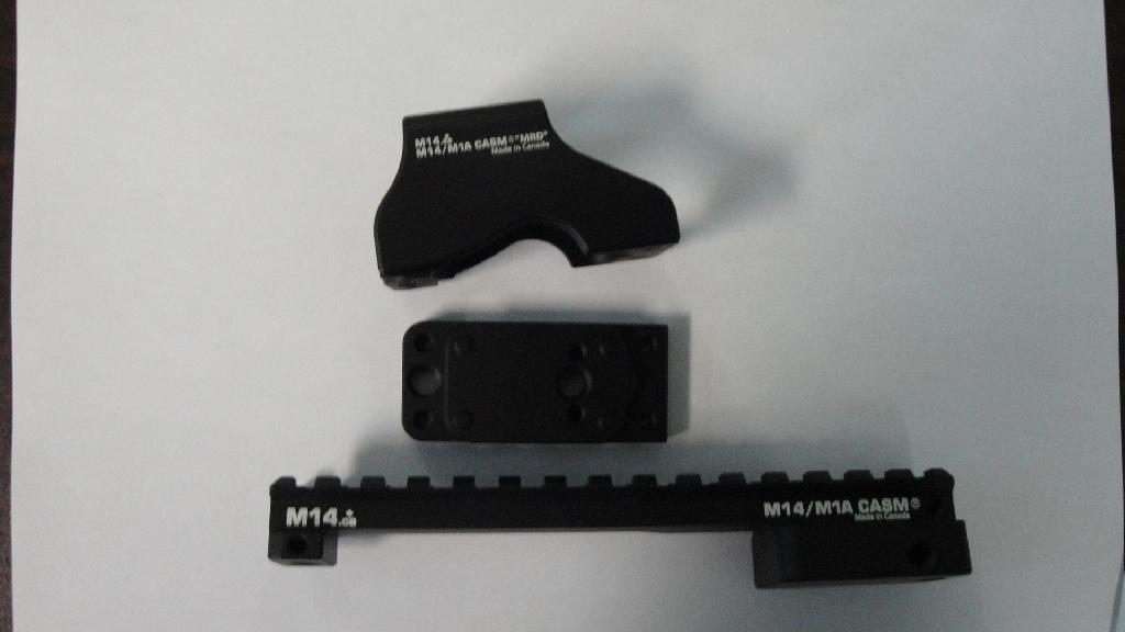

I can't answer questions about the stock in the scope mount thread guys. Call me direct at 250 721 3444 or simply email as below. Here is a photo of the CASM "MRD" scope mount that fits "between" the sight ears of your M14 rifle. The JPOINT series of red dots also offer a built in rear sight notch as a backup to the red dot. This is one cool little red dot mount.
Now, if only my anodizer would get these back to me and if I could fill my current GEN2 CASM (shown here in this photo) backorders as well, I would have a few more happy customers.
First ever photos of anodized CASM Gen 2 scope mount and CASM "MRD" red dot mount.
(Sorry about this photo, it is the anodizing approval photo I received, it is all I have right now).
A photo of the JPOINT red dot mounted on a non-anodized MRD base, no hood present.

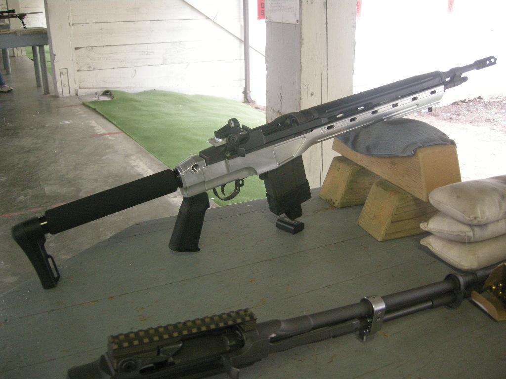

Photo is from 02.12.2012 range session.
In the foreground is a Gen 1 CASM scope mount and a photo of an M14.ca oprod guide.
