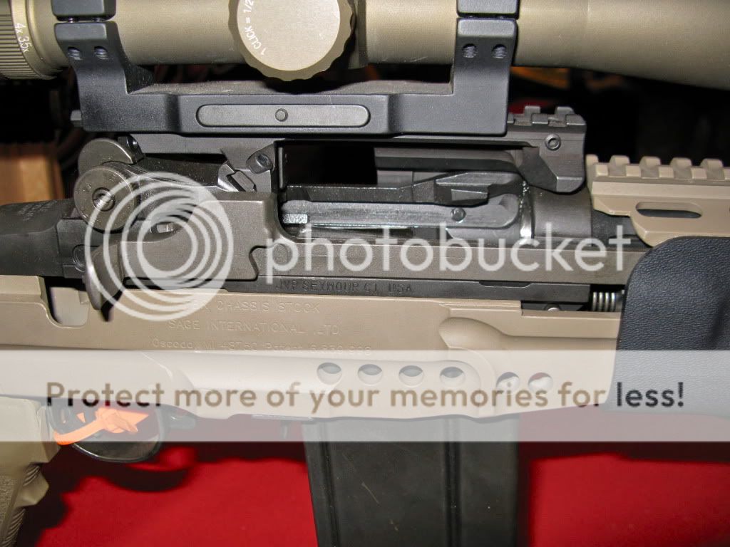

Can anyone ID this M14 mount?
I'm guessing no importing of the gdi G1-OSM mount?
Sounds like a nice piece of hardware.
The G1-OSM™ Gen3 M14/M1A optic mount allows the user to co-witness iron sights without removing the rear aperture, as well as the ability to provide the proper eye relief required for both M1913 Picatinny rail compatible scope rings, in addition to Trijicon® ACOG scopes without the need for additional adapters.
No there are way's of getting them in Canada but you will need a cheek risser just to make it work right. Although if your running a Sage this is a non-issue.
M14 mount in pic
It looks like the Leatherwood scope mount:

I'll know for sure because I have ordered one. Don't like the single piece mounts, too difficult to zero in. Currently have one from McCann Industries.
