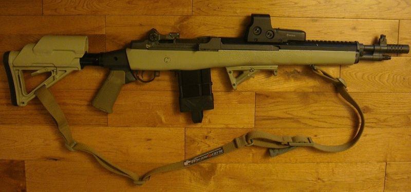

M14s 2500rd Review and a DIY Mod-Stock walk through
My Version:

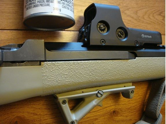

Are you asking what I used my stock ? If so it was Krylon Stone paint with FDE and clear coat sprayed on after.
Hahaha, my wife and I had a lame bet of decorating these old wooden castles. I have no artistic ability at all.... We had a week she worked on hers night and day and kept upping the bet... Last day came she was so excited so in the morning I took my untouched went to the garage, grabbed a can of this same stone paint pilot drilled a couple holes to push in cupcake flags.... And the winner was at vote of 10-1 lol she was pissed at me for a week lol.
That stuff is amazing for adding texture to most things and then just add a coat on top. I also used it on a horse pedistal so the horses could stand on it and not slip off just that and some clear coat worked great. If I am not mistaken you can by a tan based version of the stuff too if you want a little more added color then just flat tan.

I still need to add the CTR stock and MOE grip in OD green, but here it is so far. Muzzle brake is metric threaded by extreme shooting in YWG.
