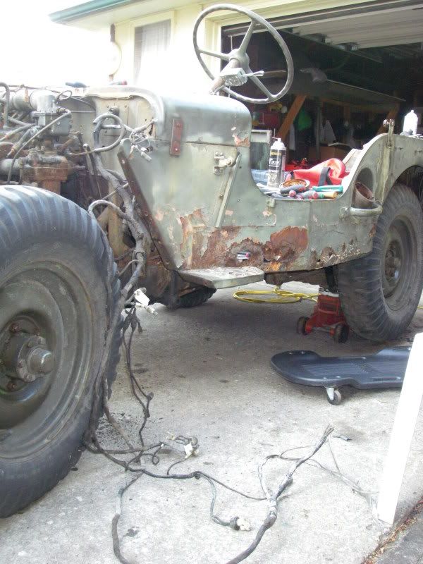

It's been another productive day of skinned knuckles and progress as the strip down continues. Special thanks go out to Artyman for all of his help today!
The tailgate and soft-top bow were the first to go, and then we moved on to disconnecting all ties between the tub and frame.

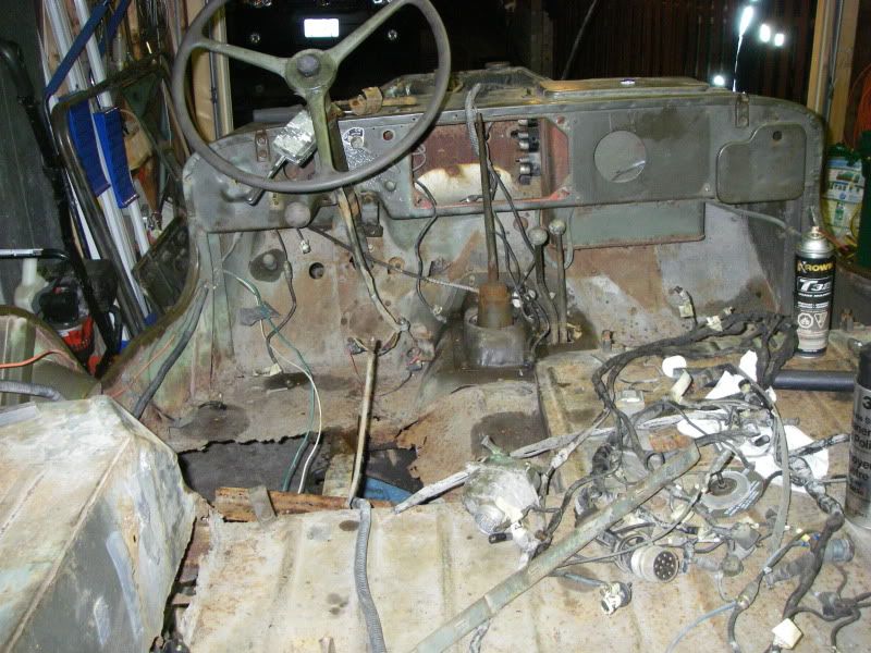

It takes quite a while meticulously disconnecting the connections behind the dash running through the fire wall, and ensuring that everything is labelled.
Wire by wire, the harness is disconnected, labelled, and removed.
Once the electrical bonds were freed, the next parts removed were:
- air filter (bolted to the body)
- parking brake (cable disconnected from brake on drive line, and handle on dash)
- clutch, brake, and gas pedals
- choke cable
- hand throttle cable
The fuel tank was removed and stored, and all bolts holding the tub to the frame were... encouraged to relinquish their posts.

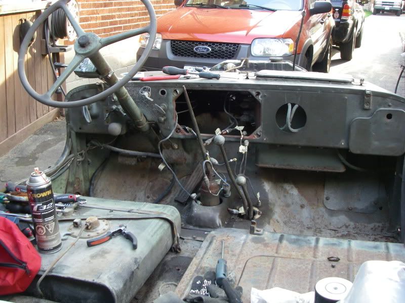

As she sits, the tub is ready to come off. The only thing keeping it on is the steering wheel. We tried unbolting the steering column from the bell housing, but they weren't overly exited to part ways. They began to separate, and then wouldn't go further. Rather than forging ahead with brute force and ignorance, we left them in place to research find the most appropriate solution.
Does anybody have any advice on how to get the steering column off so that I can remove the tub?

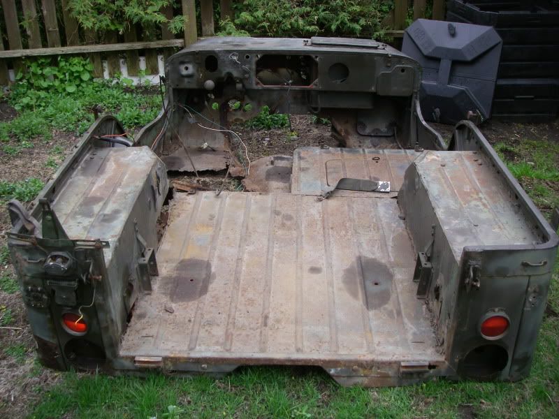

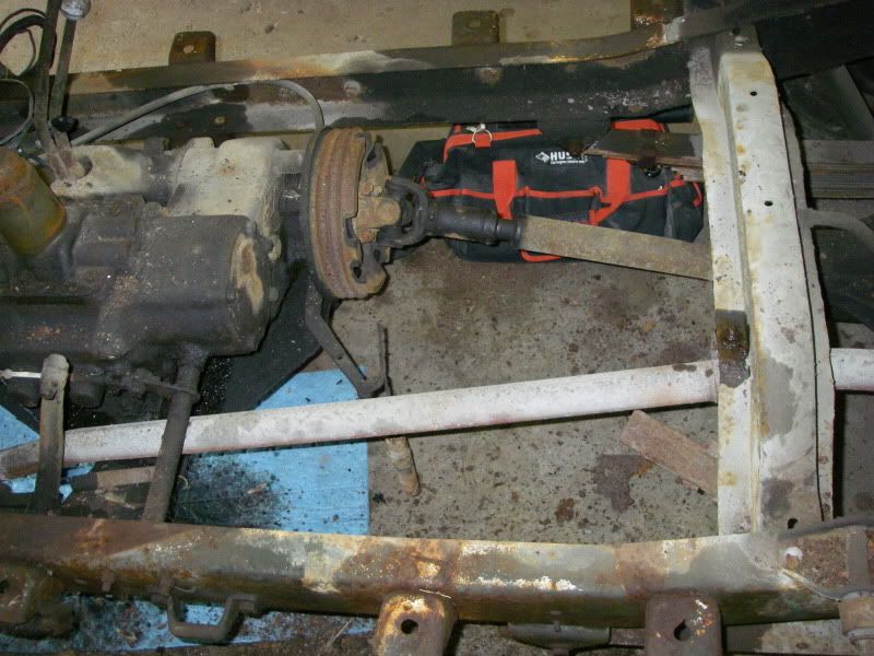

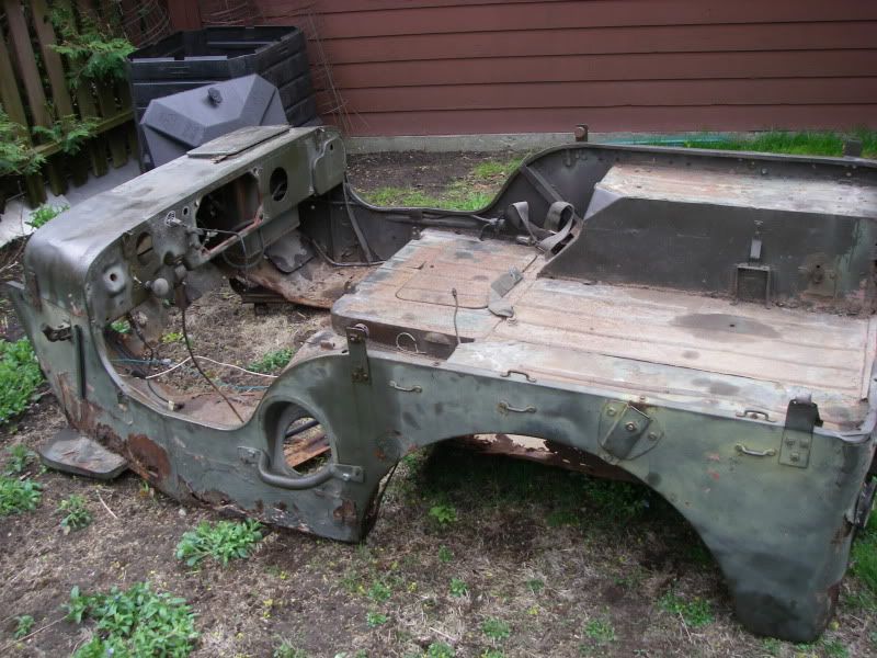

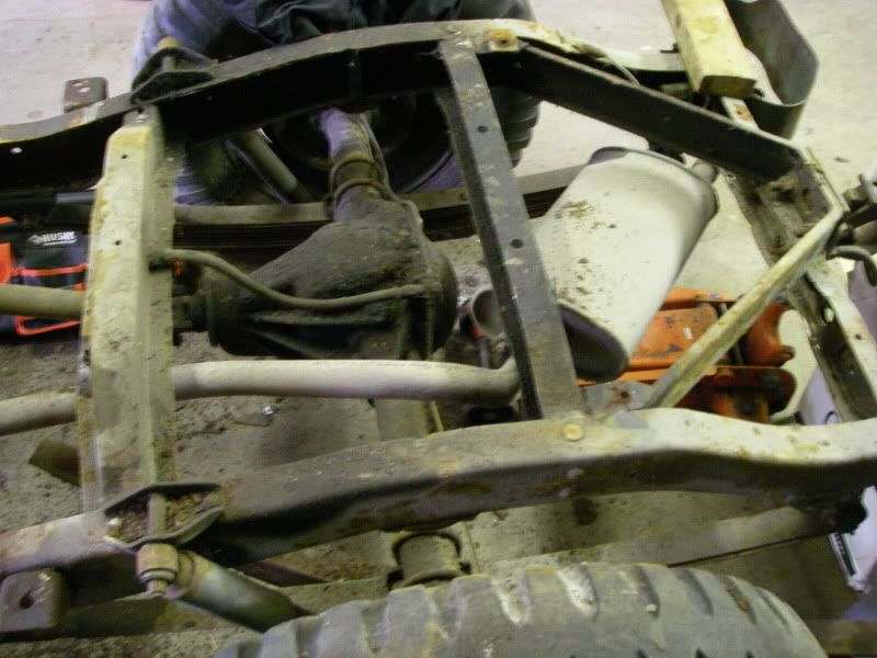

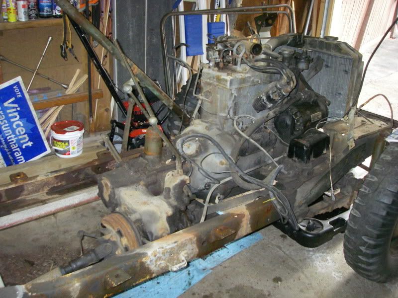

It's been a momentous day! The body is off and we're down to the frame. As always, there are several pictures to placate Claven's viewing hunger :D

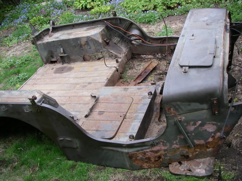

The day started with removing the steering wheel. Next we removed as many of the bolted floor pan sections as possible so that the body could come off. We lifted the tub off and got a close look at just how rough of a shape it's in..
Giving it the once over revealed the full extent of the rust damage, large swaths of bondo, and several assorted riveted patches, I have arrived at the conclusion that a new tub is in order.

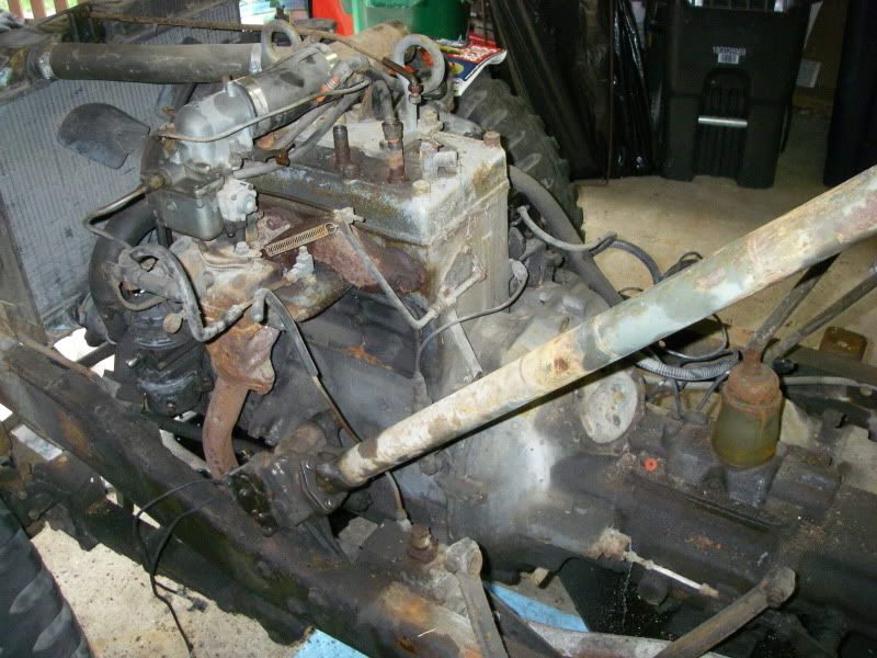

With the tub off, we get our first good look at the frame condition. It appears to be in remarkably good shape despite the condition of the tub.

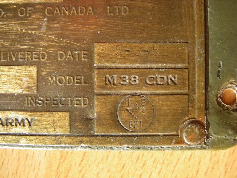

Progress has been swift. I set the goal of having the body off by her 60th birthday, which if I read the data plate right is in only a couple of days! :dancingbanana:
