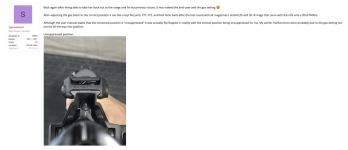

Right off the bat, the "unsuppressed" setting doesn't cycle the rifle unsurpassed at all - the manual screenshot is here:
https://www.canadiangunnutz.com/for...-mk15-first-impression-canada-review.2582085/
Maybe it is really for launching rifle grenades?:cool: I was suspicious because the rifle was shipped in the "suppressed" setting, so I brought the hex key with me. So that cut down some of my range time to unscrew the hand guard and change the gas setting to "suppressed".
After putting the gas setting in "suppressed" that the rifle ran with some hiccups - It took about 15 rounds for the rifle to "break in" and then it ran without any issue for the next 160 rounds.

It seems the gas settings shown in the manual are inverted. Another user had the same issues with suppressed vs unsuppressed, with the vertical position being unsuppressed in reality. For reference: https://www.falfiles.com/threads/brigade-manufacturing-makasi-fal-ar-hybrid-rifle.485006/
Hmmm, and so on the suppressed setting the gas imparts less pressure on the piston and without the can present, there's insufficient gas to work the action?
That makes sense as it indicates the gas flowing from the barrel into the gas block. When it's turned to the other position, it shows as the gas being blocked.
Depending whether they re-size the gas port for NR barrel or just slap on a longer barrel and drill the gas port the same, the extra barrel length and dwell time on the NR version will make it cycle with more authority.
That's also what MAC's video shows. The large gas port (unsuppressed) is in use when the slot is oriented vertically. Turn it 90 degrees and the small gas port is used.
That's what I immediately thought as well. A suppressed setting cuts the amount of gas/pressure being fed into the system since the suppressor (unless it's a flow through design) adds pressure into the system. Would make sense that was GT thought was unsuppressed is actually the suppressed setting and vice versa.
