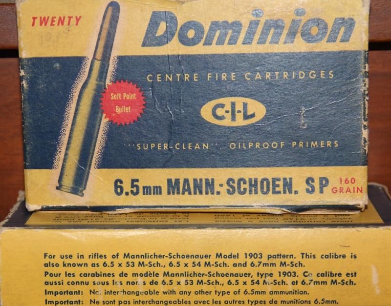

I have a couple of very old boxes of Dominion ammunition for the "6.5mm MANN. SCHOEN."
On the top flap of the box it says:
"For use in rifles of Mannlicher-Schoenauer Model 1903 pattern. This calibre is also known as 6.5x53 M-Sch., 6.5x54 M-Sch. and 6.7mm M-Sch.
(then in French)
Important: Not interchangeable with any other type of 6.5mm ammunition."
So somewhere, at some point in time, some people/manufacturers also referred to the 6.5x54 as the 6.5x53
(then in French)
Thanks 1899 ... that's VERY interesting ... particularly the 6.7mm M-Sch ... I hadn't seen/heard that before!
The interesting thing about that ammo is that Dominion made their 160 gr RN bullet .262" diameter. I remember because I used them in several 6.5X55 rifles, and had to remove the expander ball from the sizing die to hold the bullet. They came in flat 50 packs, and the plastic tray could be used for a 22 Hornet case holder when reloading. :)
