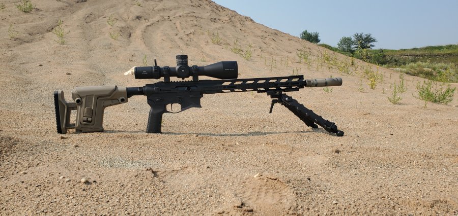

I just finished a 22ARC MRA Renegade build and am having extraction issues on very light loads. (Hornady brass) I just started some test loads at the very low end of Hornadys load data and already noticed sticky extractions. May need to look at other brass.
We have no idea why our rifles do not like Hornady ammo. All Hornady ammo seems to stick in our chambers. I am guessing it must be something to do with the brass. The Renegade and Maverick run well with PMC, Federal, Barnes, Nosler, and Remington from our experience.

The intresting part is, I'm running a 22ARC barrel & bolt from Faxon. It's not an MRA barrel. But I'll try find other ammo than Hornady, it's a bit challenging with 22ARC, seems Ike no one else makes it.
