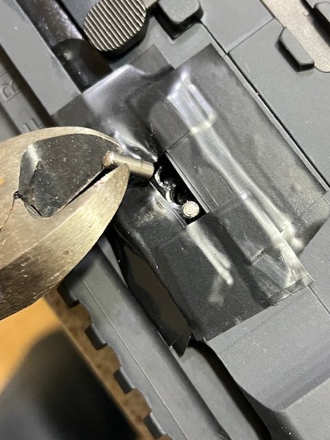

FAQ: The dowel pins that align the charging handle on my MRA rifle are stuck in the side of the bolt, how do I remove them?
  • The first step is to apply heat, for example with a hair-dryer to loosen them. Then we suggest using a diagonal cutter to grab the pins rather than needle-nose pliers, and using a prying action against the receiver. HOWEVER to protect the rifle use a couple layers of electrical tape to separate the rifle from the tool you use to pry out the pins.
