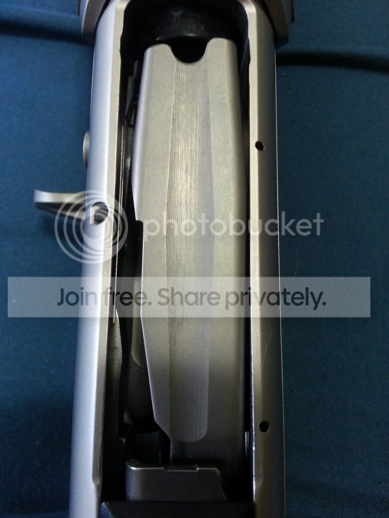

Old pict:

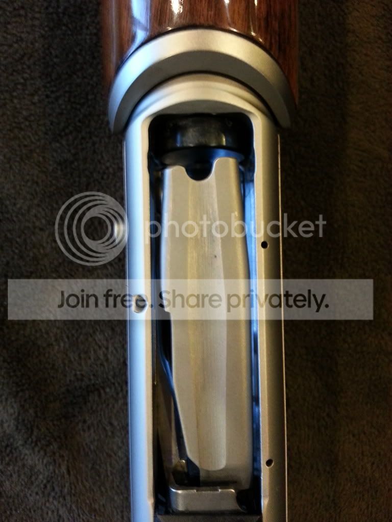

New pict:
Yeah your right it does seem to be further into the receiver. The bolt is also nice and shiney now haha. I'll let you guys know how it goes on Saturday.
That looks right to me .the second picture looks like all the maxus I have looked at .with the carrier tight to the inside of the receiver . best of luck hope it run the way its suppose to for you now .
To me the right hand top of the receiver has been ground back, the carrier has been replaced and it sitting now forward by a fair amount. Scribe a line from the end of the carrier to the right side of the receiver and is is pretty clear.
