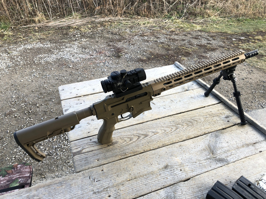

Here is mine..
Brigand arms "blade" handguard
Odin works CQS stock
12.5" Balistic Advantage 6.5 grendel barrel..
Triggertech Competition trigger.
StrikeEagle 1-8 in Aero Prescision mount.
Luth AR grip
Light weight brake with blast shield (colonel Mustard)
( HK 5.56 mag, just for a picture)
Beautiful rifle.
Do you mind to tell me how much she weight with or without optics?
Thanks

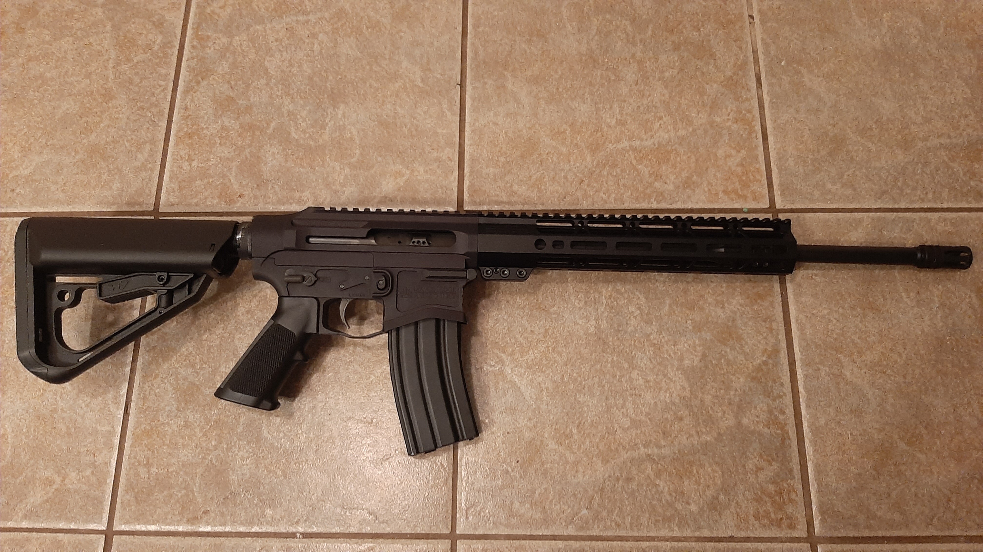

My Renegade arrived today and I got it mostly built. Just waiting for the brake I got off the EE to arrive. Bonus #1: the lower is threaded for a tensioning screw. I was able to scavenge the one out of my Aero lower so the fit between the upper and lower receivers is nice and tight. Bonus #2: the receiver is milled for a short throw safety. I wasn't sure about that one but my Radian Talon ambi 45/90 safety works great.

Just completed my Renegade build. 16" DPMS barrel in 5.56 with a MRA handguard and muzzle brake. Geissele Single Stage Precision trigger, 2 Lbs 10.8 Oz 10-pull average. Topped with a Burris RT-6 mounted in an Aero Ultralight mount. Weighs in at 7 Lbs 6.9 Oz as pictured with an empty magazine. This will be my 3-gun rifle for 2021.
