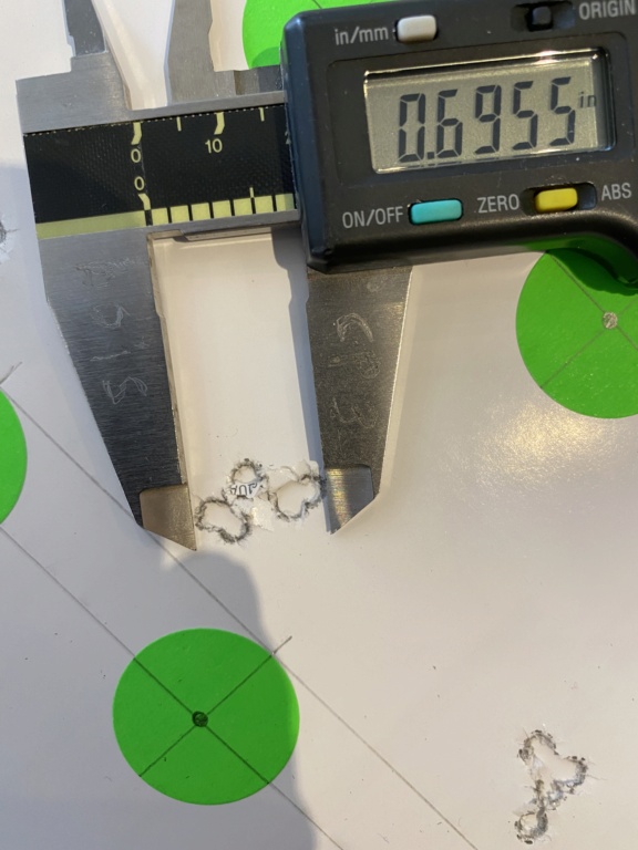

Groups were measured farthest edge to farthest edge then .218" was subtracted from that number.

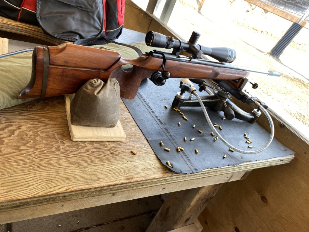

I was shooting my Norinco NS522 with SK standard and a cheap Simmons 6-24 on it. Didn't take a picture of the rifle at the range, so here's one from last summer.

Thank, yes, the biggest issue is the nut behind the trigger. Oh well, just have to keep trying. Having the target board at 50 yards vs 50m would make it a bit easier too, but that's how my range is set up. Thanks on the stock, I made it last summer. The one it came with wouldn't sit very well on the sandbags, so I figured I'd have a go, and laminated some 3/4" birch I had in the shop.

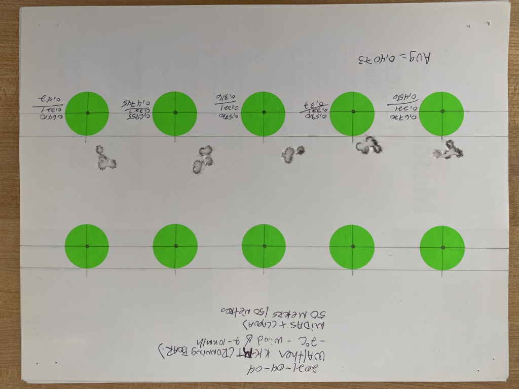

Walter KKMT Running boar
Nice sunny day, shooting time.
I give a try to last Walther I got, I like Walther rifle they have a little something special. I came close to forget set-up picture rifle was ready to go in carrying case :)
I think Running boar was made in 1984 but not so much information even on RFC for this specific model.
2021-04-04
-2 celcius
Wind 5-10 East so slightly from my right to my left
Rifle : Walther KKMT Running Boar ( not sure of the official name)
Scope: Leupold VX3 6.5x20x40 EFR
Front rest: Bald Eagle cast Iron
Rear bag : Armageddon heavy
Ammunition: Lapua Midas +
Group: 0.456, 0.37, 0.316, 0.4745, 0.42
Average: 0.4073
Distance: 50 meters

I keep it at ambient temperature usually over colder temperature I use SK Biathlon or Lapua Biathlon that have proven more stability through my rifles below 0C and we are kind of in the range of temperature where I started testing Center x and Midas again. I expect also to see tighter group with better condition and tighter SD. We are kind of please( excited I should say) to get this warmer weather to shoot :) but still cold in fact.
Congratulations Sigp226. Great shooting, especially for -2*C and some wind. Did you do anything to keep the ammo warm, or was it just sitting at ambient temperature? I ask only because I suspect the groups will tighten up even more when the lube and powder in the ammo are 10*C to 15*C warmer.
