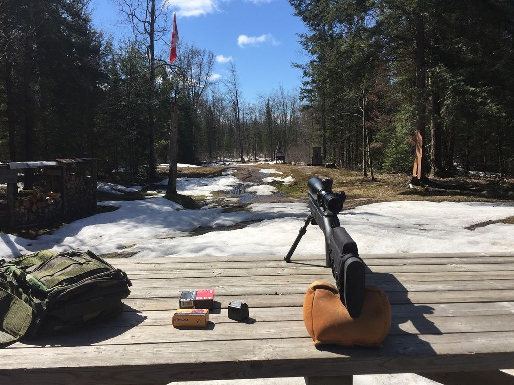

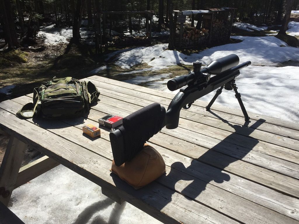

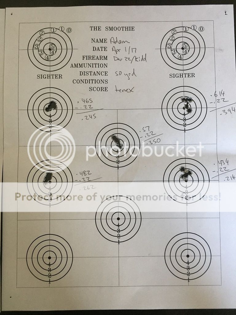

Rifle is a dar 22 receiver, all kidd internals, dlask 16" xtreme barrel bentz chamber and Titan stock. I had 3 types of ammo today. eley rem eps match, eley tenex, eley match biathlon. I am submitting 2 targets that were back to back. Scope is a bushnell elite tac 6-24x50 with milldot.

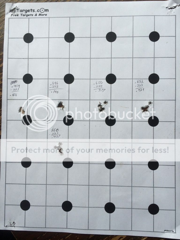

I went to the range today armed with an inch/pound torque driver and a box of Eley tenex in an attempt to dial in my rifle for the next fun shoot at our club. I don't normally buy ammo that's more than $10/50, but I guess that's what it takes eh? I have found it to be the most accurate ammo I've tried in my gun before and wanted to take the ammo out of the equation as much as possible while dialing in my action torque so I splurged. (Thanks for the tip yodave)

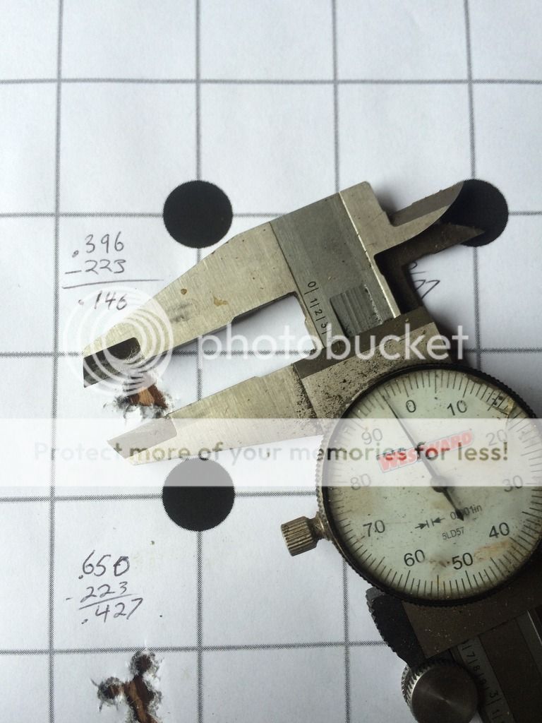

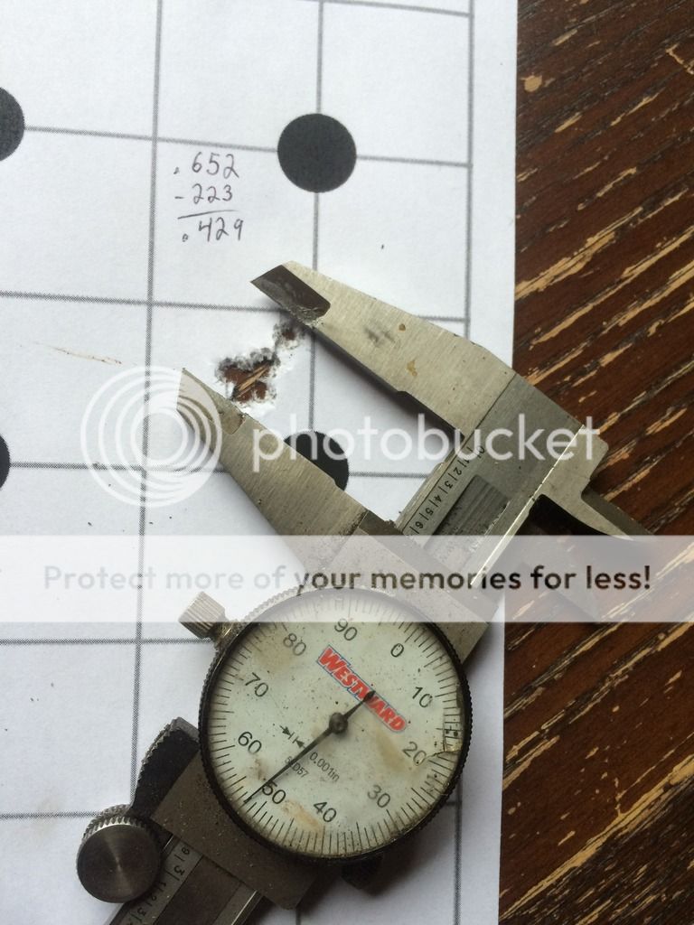

I absolutely F'n crushed it! Lol I wasn't even purposefully attempting the challenge as I had given up hope a while ago. But after the first two groups I knew I could have a chance here. I feel the combination of the right ammo, the right torque on the action screws (15 inch pounds), the right windless conditions, and the right target (I could line the crosshairs up with the dots quite easily) combined with a huge stroke of luck made this happen. Although I've always known the gun was capable.
Group sizes;
.146
.186
.377
.427
.429
Average group size .313.

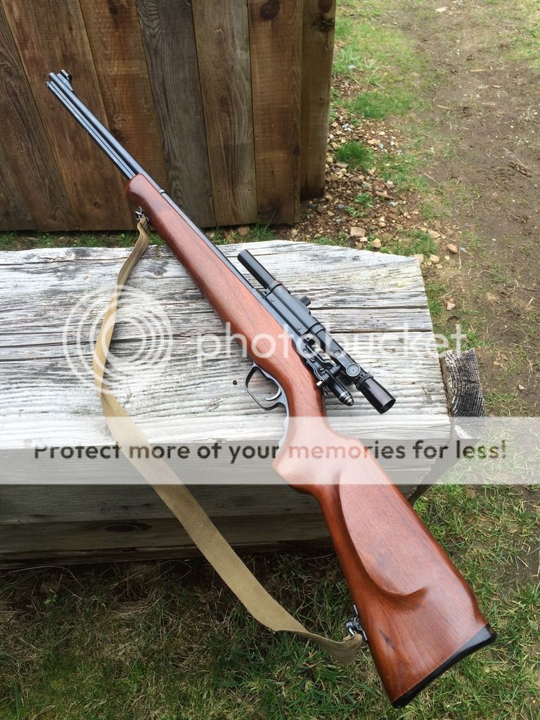

Rifle is a Mossberg 146-b which I loaded single shot, trigger set to 13oz. It's so dark in the rifle shed I had to take it out to the baffles to get a good pic of it. It just wasn't showing in pictures, but it was shot from a bench with front and rear sandbags.
Please excuse my filthy verneer from work. It's old. It's seen some action.
I honestly believe it was a fluke. A stroke of chance like the golfer in caddyshack who played his best game ever in a thunderstorm.
And sadly it'll probably never happen again as $25 for a pack of 50 rounds of tenex is just ugly. That hurt. But it has certainly inspired me to put a higher power scope on it and take it out further. It's pretty useless at 100m as it is.
