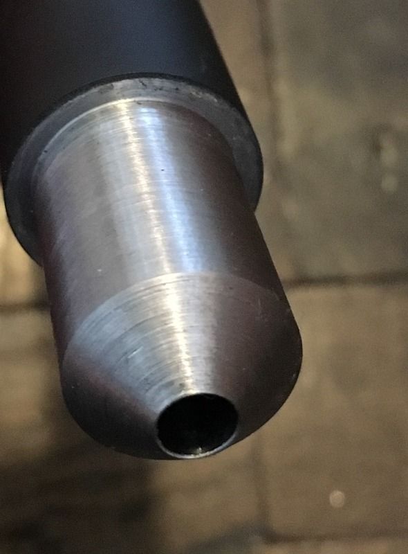

Thank you for that, it has been re-crowned about 20 times now, lol. I think I'm going to try cutting down the other end next and see if I can copy it. Then maybe try threading the muzzle to 1/2-28.
Took ya 20 tries to cut a good crown? lol good thing you're getting some practice before doing a usable barrel ;) Another thing to try on the chamber end is a cone breech setup which allows indexing/timing of the barrel and then it is glued in. Seems to be the way to go when building a 455 with a Shilen or other custom barrel that's not a "drop-in" like Lilja.
I think the first one was fine, I just did a bunch of different types, 11deg, recessed, seeing what the moves were for each. I've never had any formal training in machining, it's all new to me. I will find more info on the cone breach, thanks for the tip.
