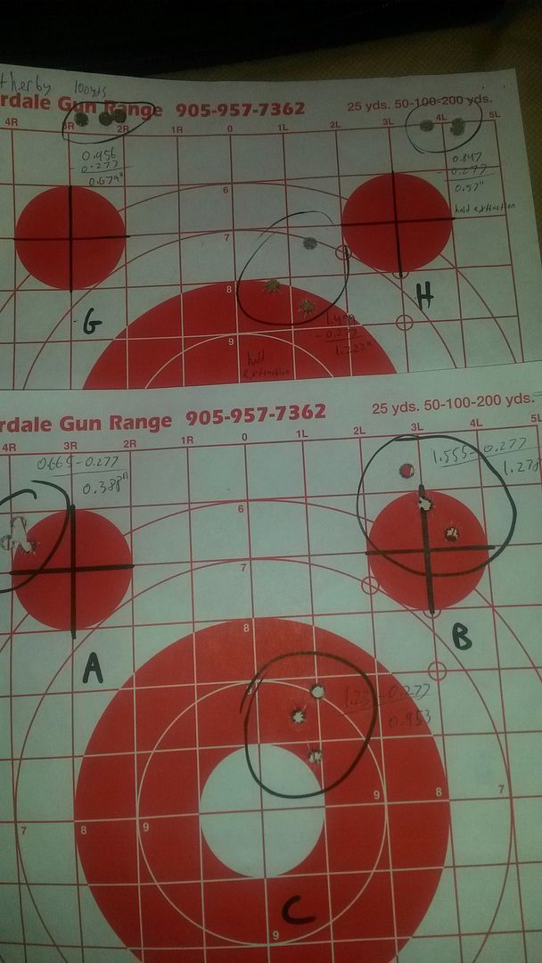

Speaking of load development it has been an exercise in frustration. I should have had this challenge licked long ago but I cannot get a consistent load for the rifle. When first shooting factory loads I got a box of winchester silvertip that would have done the challenge, bought another box and not a sub MOA group was to be had out of the whole thing! Thus inspiring my reloading adventure my first crack at it was very encouraging. Load A: 43.4gr IMR 4064 130gr SST for 0.388" group, B load: 45.1gr 1.278", C load: 46.8gr 0.953". Bottom target on my overlay.
Another ladder of loads top target. F load (can't find the target I shot it on): 43.6gr 0.444", G load: 47.3gr 0.679", H load: 47.8gr 0.57" now getting into hard extraction and flattened primer, I load: 48.3gr 1.222". So I went through two nodes of good accuracy while working up the powder but the higher charge was a little much so I settled on the lower charge "F" load. By now I only had enough bullets to load another 20 rounds as I was also developing another rifle from this batch and set these aside for my hunting. I have 11 remaining after zeroing and confirming performance so I couldn't do the challenge with them even if I wanted to.
I bought another box of the 130gr SST from a different store and did up my "F" load for a challenge attempt. Groups were: 1.442", 1.222", 2.202", 1.846", 0.970". What the frick eh? When I finally bought a bullet comparator the base to ogive measurement between boxes of bullets was not the same so my original loading to same OAL based on nose of bullet was flawed. I loaded to same COAL to ogive and got better groups but not the good groups like the first box of bullets. So while the rifle will shoot just about anything in the range of 0.75" - 1.5" which is very acceptable hunting performance, it's true sweet spot is extremely narrow and like a unicorn to find. I'm crying that I spit nearly half the good box of bullets out of my dad's remington 7400 :( and I'm not to sure what I can do reloading wise to make it easier to find a good load than dumb blind luck.

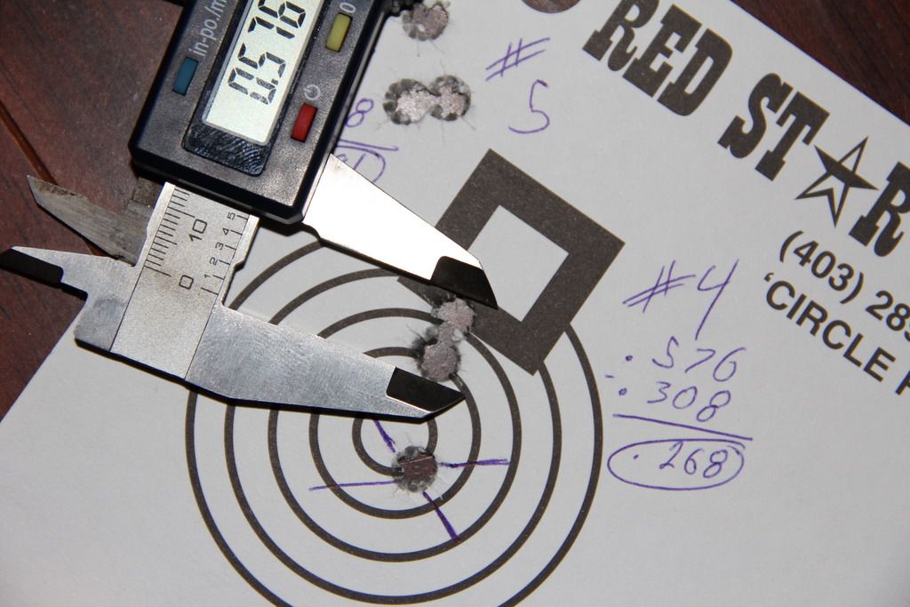

Well, tried the challenge to FINALLY! I'd like to think I passed lol. Maybe the OP will give me some leeway due to my extra group :p Haha
But according to rules it'd be a failure due to myself, not the rifle. I pulled on the 2nd shot(Hole with the X through it) in my #4 group, so I took a fourth shot to make up the .268 group. Also that is the reasoning for the extra #5 group, just to show it was me and not the rifle lol. I'll be back!

#1 - .664
#2 - .576
#3 - .571
#4 - With my flier: .962 Without: .268(My tightest group)
#5 - .491("Actual" tightest group)

Sorry there Brappp, the extra group is fine, but the bigger one is what disqualifies it.
That's crap and not in a the spirit of your test... the gun is obviously capable. The shooter pulled a flier yet shot extra groups. Is this test the capability of the rifle or the shooter? Just saying it's your test so your rules but I think his rifle passed your test!
