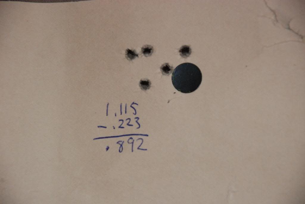

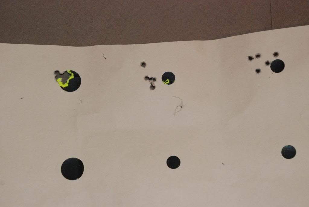

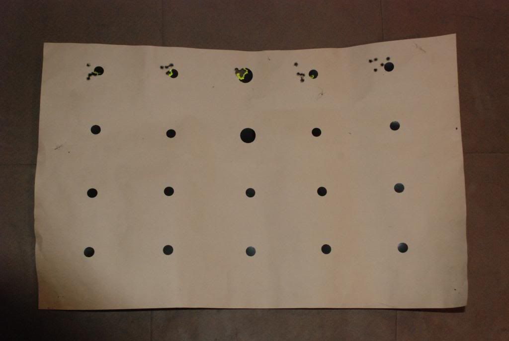

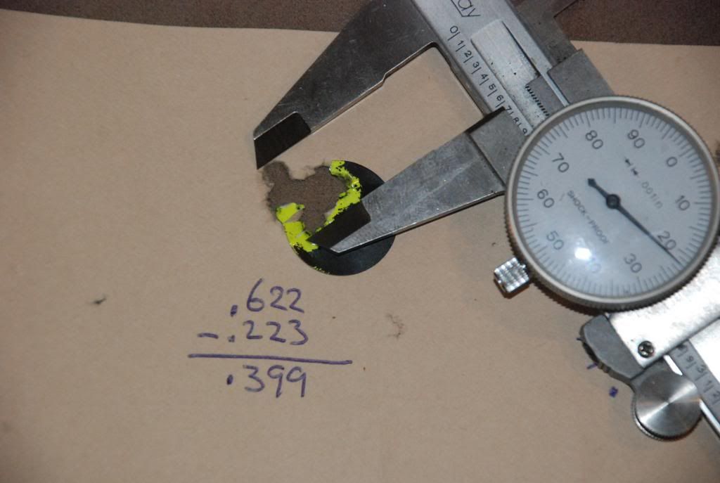

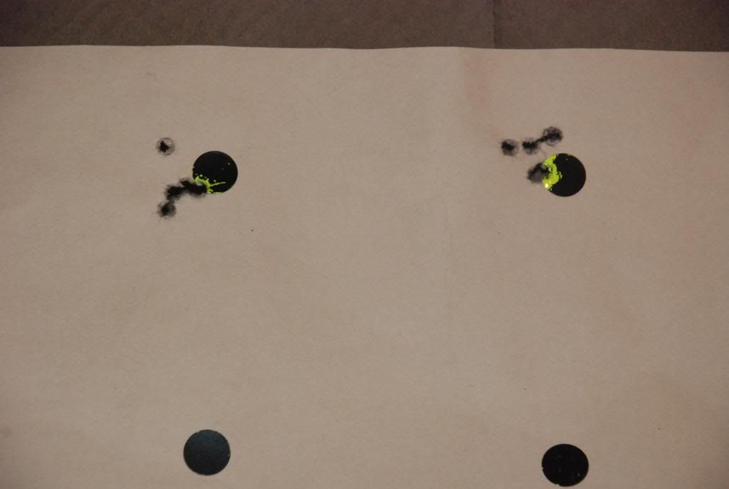

Ok I was out for another try the other day. Another failure but I'm getting closer evey time. I'll get there eventually!
Groups were:
#1. .692
#2. .477
#3. .399
#4. .927
#5. .892
Shooting the new AR again.

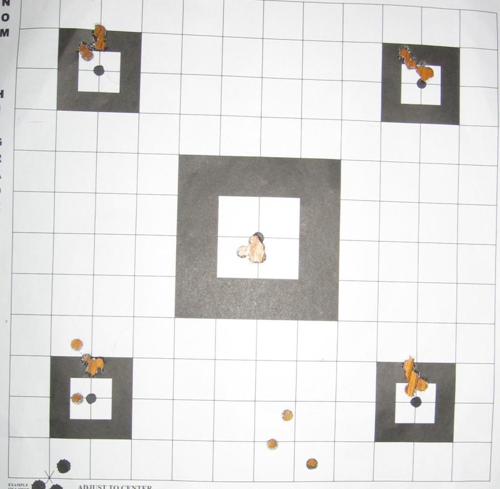

So I didn't pull it off, but I'm so pleased with the first group I'm posting anyway (as this rifle will likely have to be pawned before I can fire 5 more groups of the now refined load). Also the conditions were less than ideal, I had to shoot at one of my employers gravel pits as my range membership has expired and no extra cash to renew. The snow was a little deeper than I thought where I had to shoot from (down in the hole as the boss says), about a metre.
The rifle started life with a bit of a handicap, the chamber was very rough. I didn't send it back because it looked like it was going to shoot better than 0.75" at 100 yds. I was at the range to test my final loads and went to warm the barrel up a little with some loads that didn't make the grade. When I had to tap the bolt open !!!!!, what the hell, that load wasn't on the ragged edge! I fired one more and had the same result. What I discovered is that if you let someone else fire your rifle make sure you look at the ammo first, turns out it was a little corrosive. This is the first time I fired it since I polished the iron oxide out of the chamber and throat. I'm pretty happy with the results.
First the rifle.
Now the target.
The center is approx 0.400",
top left and bottom right are approx 0.600",
bottom right is approx 0.900",
bottom left was rushed as my balls were on the snow with only two thin layers of cotton between them, approx 1.300", but remove the called screw up and it's 0.750".
The load is 178 A-Max,
IVI brass,
Winchester primers,
H4895
The charge weight was center, 38.3gr, two right 38.4gr, and two left 38.5gr, COL 2.800"
:D Too bad we aren't counting best three!
