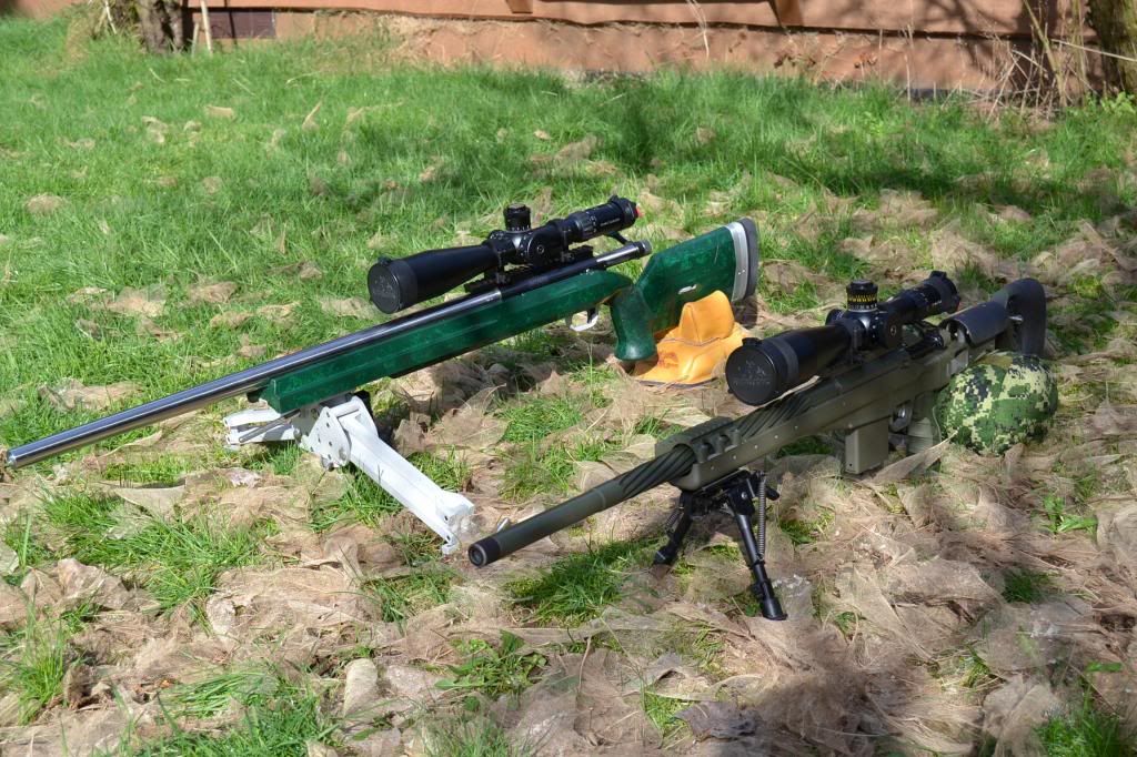

First off I used my PGW Coyote topped off with a S+B 12-50x56 1/4 MOA P4F and propelling a 155.5 Berger over 45.8 Varget with Norma brass and FGMM primers. While a couple of groups were under half MOA the remainder averaged about .7 MOA so back to the drawing board.

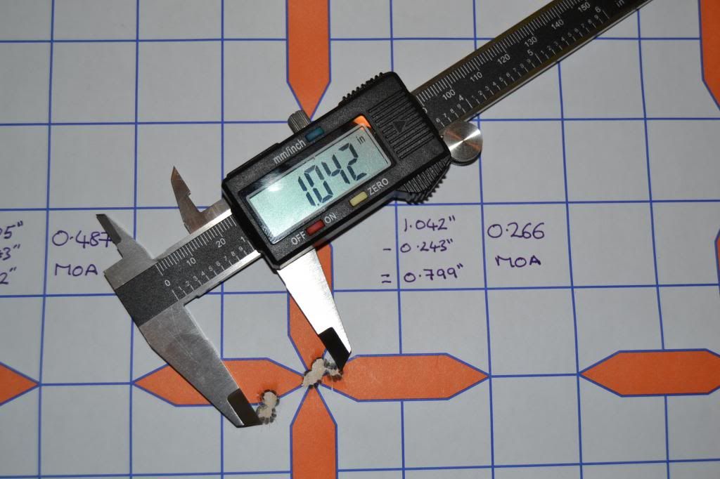

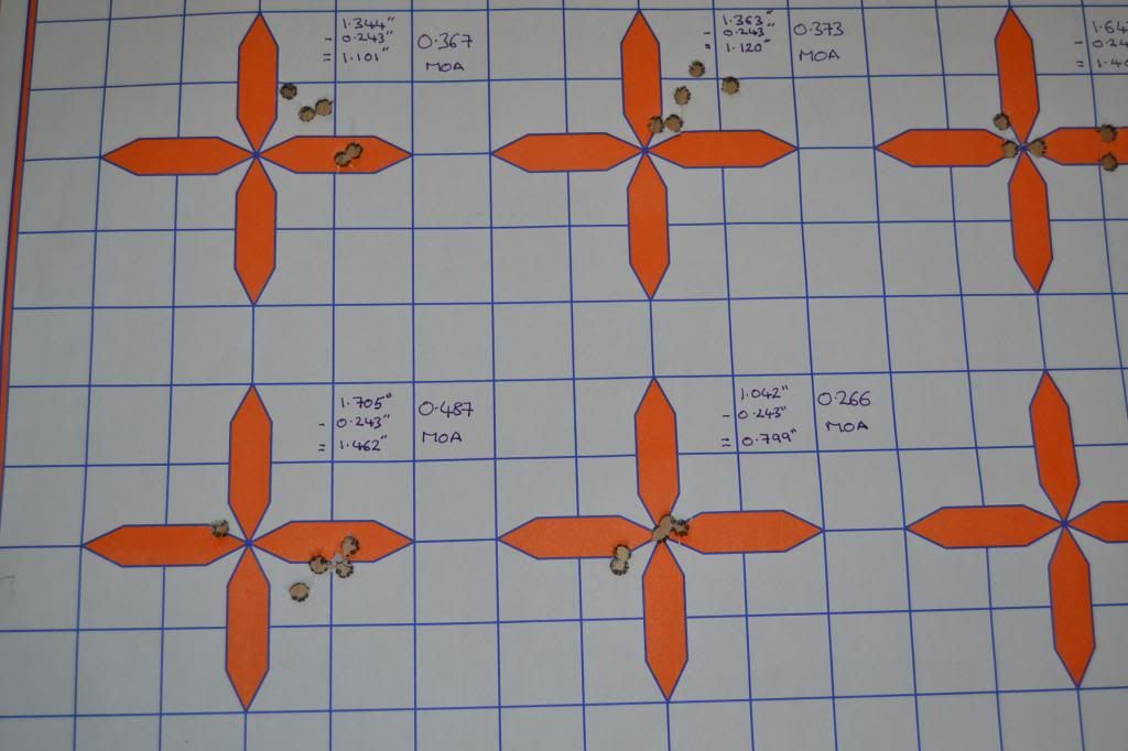

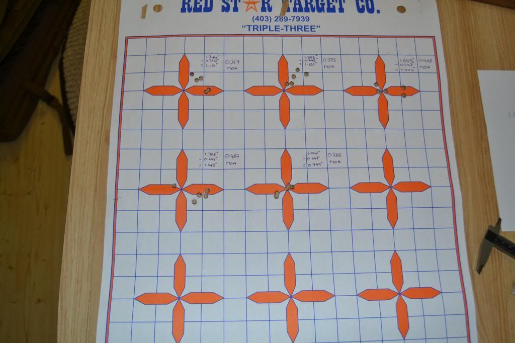

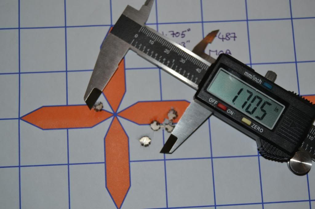

Next up was the rifle I used in the "under 1/2" at 100 Yards" game - Barnard with Kreiger barrel glassed with a S+B 12-50x56 with 1/8th MOA P4F - but with different ammo. For the 100 yard competition I used the Berger 105 VLD's but I feel that the 108's perform better overall so that's what I used today: 108g Berger BT over 30.2 Varget housed in Lapua brass and CCI primers. The results are as follows: EDIT: Numbers in Post redone following proper math - original numbers in pics were rough arithmetic with the simple inches divided by three calculation - proper math brings the size in MOA down which is, of course, even better :)
Target 1 1.101" (0.351 MOA)
Target 2 1.120" (0.357 MOA)
Target 3 1.404" (0.447 MOA)
Target 4 1.462" (0.465 MOA)
Target 5 0.799" (0.254 MOA) Saving the best for last :)
For those interested in mean averages, I calculate this to be : 0.374 MOA

Whole Target To Show No Additional Holes etc
Closer Look At Target
Close Up Of Largest Group
Picture Of Smallest Group

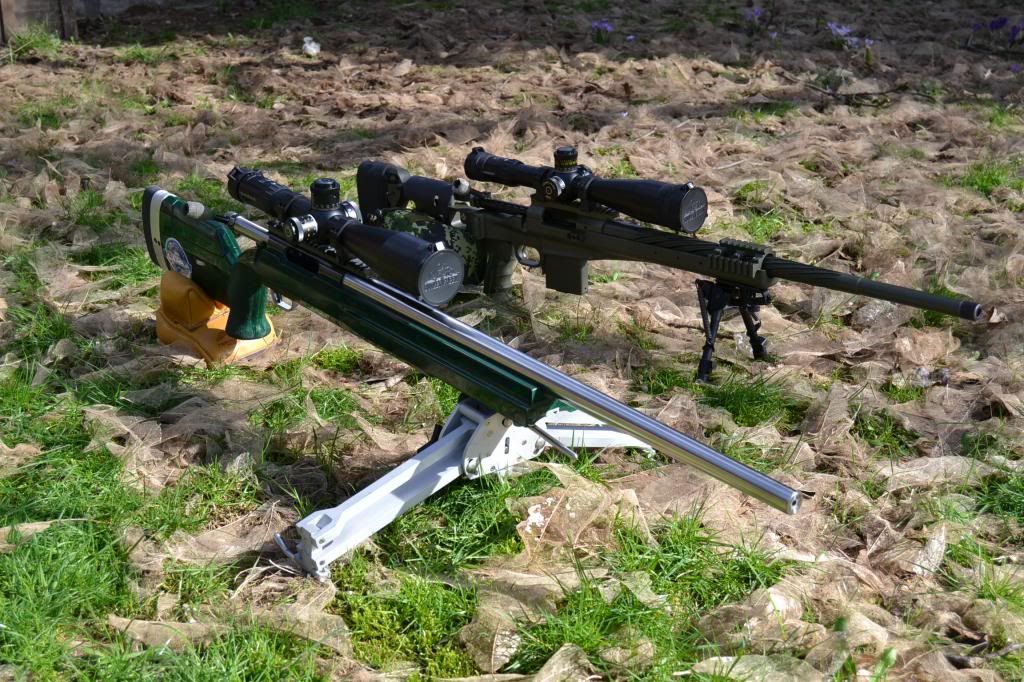

The Rifles I Used - Coyote and Barnard - As Equipped At Range
UTG - This was really hard and I appreciate you organising these games. I for one feel that this improves my shooting more than regular practice sessions as in introduces a type of ( good ) stress similar to what one can expect at a match.

Nice shooting Tomochan! Congrats on being the first to complete the challenge. I will update the original post with your successful attempt. The only thing I noticed that you did wrong, is your calculation of moa. I could be wrong, but for example on your first group. 1.101 ÷ 3 ÷ 1.047=.351moa. You are more than welcome to change your numbers if you wish. Thanks Rod
Ah, yes, thanks Rod - I just did inches divided by 300 x 100 as near enough. Using the proper math the MOA is, of course, smaller ( which is nice ). Since there may be a bragging rights issue down the road I will redo the math to make it better for me :)

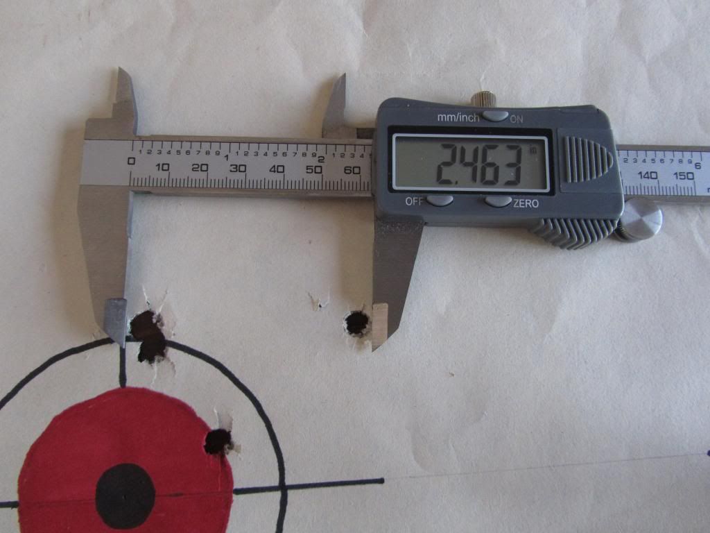

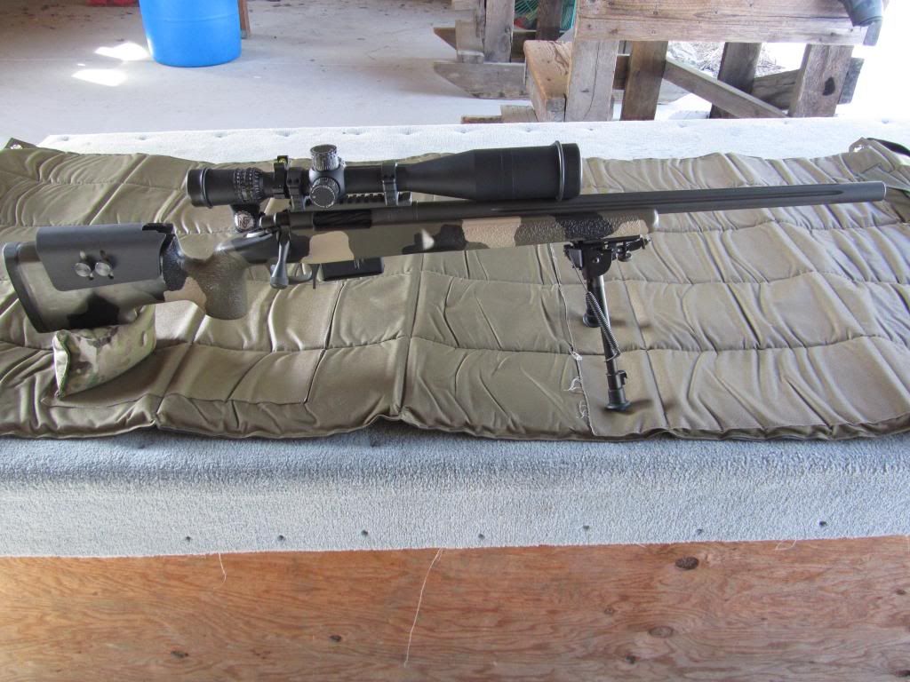

I had some time today and some loads ready to go...why not give it a shot? I've never shot in any competitions or had any training per se, but I'm always learning and improving and having a great time in the process!
Nice sunny day with some light swirling winds at the PWA Range (Pemberton Wildlife Assn.). I was shooting prone off a Harris bi-pod.
I did not pass the test today, but had a blast and learned a thing or two...forgot to load the bi-pod on target 4 and shot #1 went way high...lesson learned!
The rifle is a G.A. Precision Crusader in .308 with a Nightforce 5.5-22 x 50 scope.
I was shooting 175g SMKs over 42.5g Varget in Hornady Match cases w/ CCI BR-2 primers.
I've only tried 168g and 175g SMKs in this rifle so far...if any of you "experts" out there could suggest some other bullets/powders to try I'm all ears...

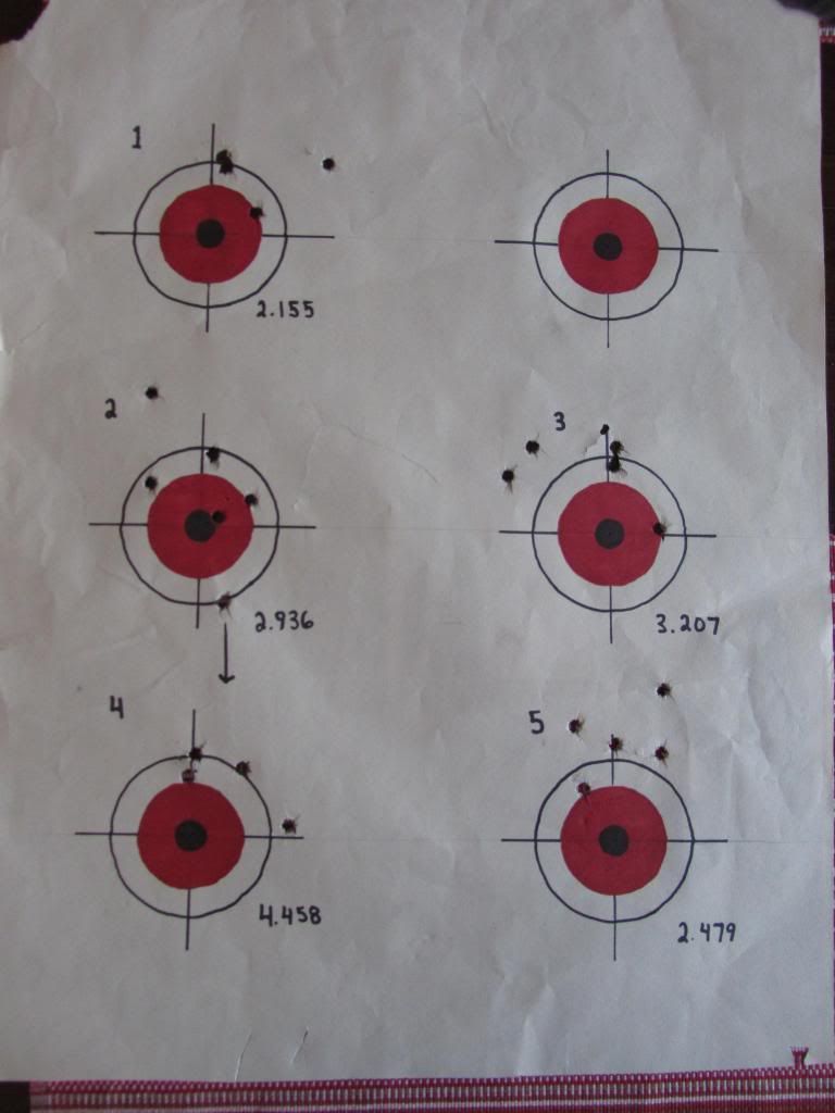

I was pretty happy that I managed to shoot 3 out of 5 better than MOA at 300 yards...the first 3 shots on target #1 are one ragged hole...I will try again for sure!
Target 1: 2.155" (.686 MOA)
Target 2: 2.936" (.935 MOA)
Target 3: 3.207" (1.021 MOA)
Target 4: 4.458" (1.419 MOA)
Target 5: 2.479" (.789 MOA)
Average: .970 MOA
Here is the rifle
Here is the target
Smallest group
