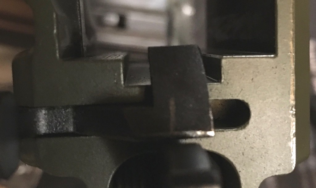

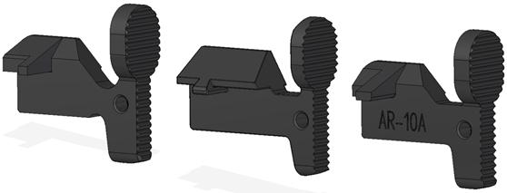

Do we know the type of bolt catch style required?
I have notice some rubbing on the exterior of the upper receiver not allowing the OEM part to fully seat.
