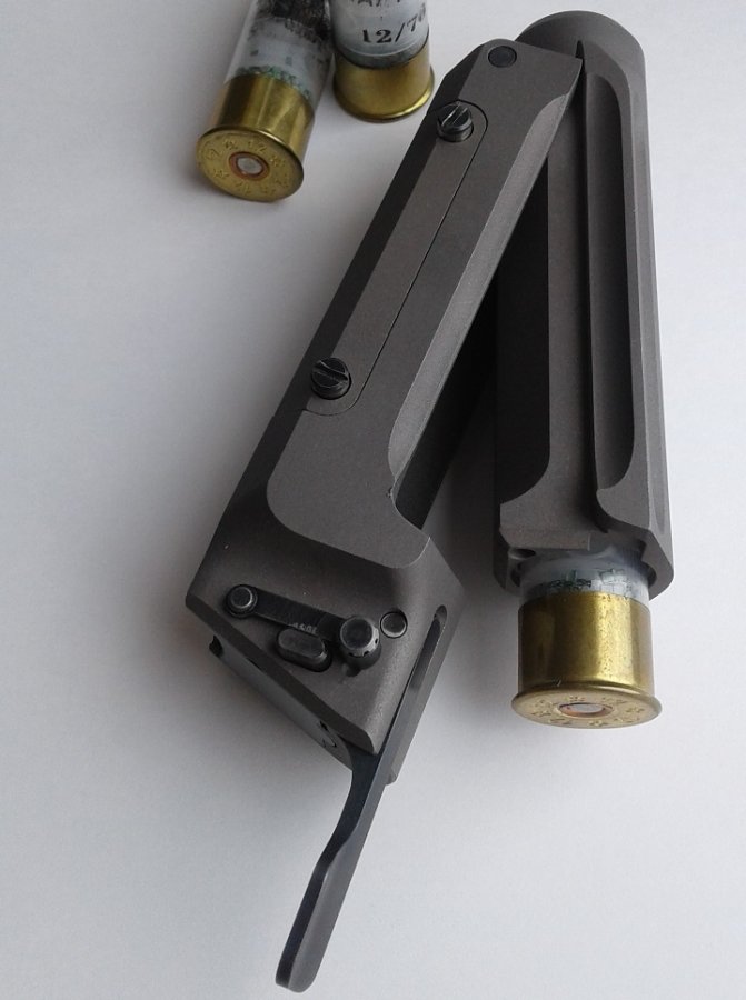

First iteration of Monoceros, Behemoth's parent, with receiver and barrel made from titanium alloy... in 2019. Manufacturing nightmare even for the simple "brick" design. Not doing it again))).
Is the "barrel" portion steel on the aluminum version? I can't see how aluminium wouldn't be more than strong enough especially with steel bushings on hinge points, even if dropped while attached to a rifle.

Depending what are the priorities. Here's what we think:
- aluminum provides better corrosion resistance - the gun in survival role is likely to be exposed to humid conditions for long periods of time,
- the firearm is single-shot and will have less rounds fired than semiautomatic, hence the lifespan priority,
- aluminum alloy that we are testing is about as strong as the 4140 steel used in the original design, but any aluminum is easier to scratch (and is also easy to touch up). Steel bushings and inserts in critical places will maximize lifespan,
- when mounted on a rifle/carbine, the less weight the better as it affects the overall weapon balance,
- we are planning to produce a stock that would turn it into a very compact standalone firearm with a weight of around 1kg for aluminum receiver option, an ideal outdoorsman survival firearm with different caliber adapters, red dot option, etc.,
- use of aluminum instead of steel will reduce MSRP a little (the main cost driver, however, is production volume),
This is our reasoning, but WE REALLY WANT TO KNOW YOUR OPINION!)
