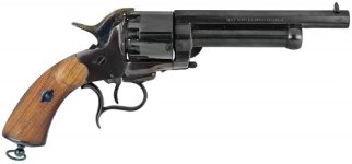

That pistol with the under barrel shotgun is reminding me of a Lemat revolver. Nine shots of .44 cal and a 20ga shotgun made way back in the 1860s
