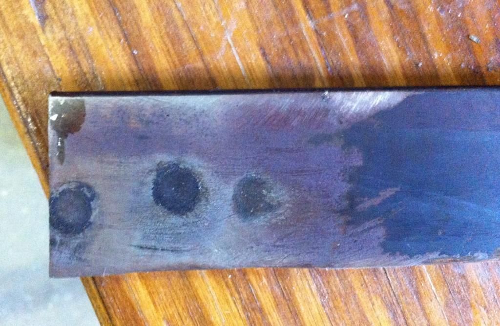

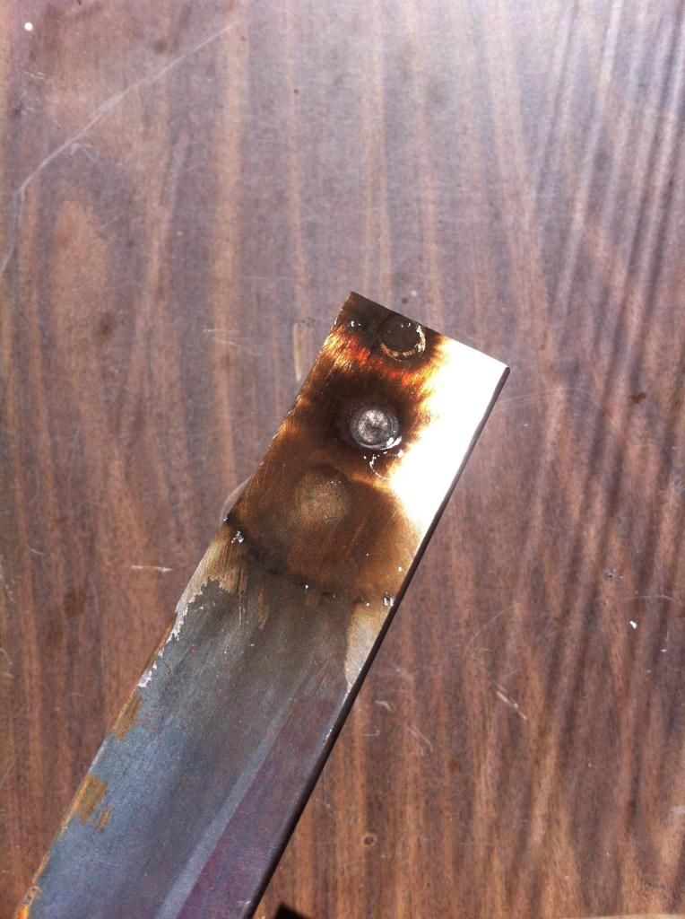

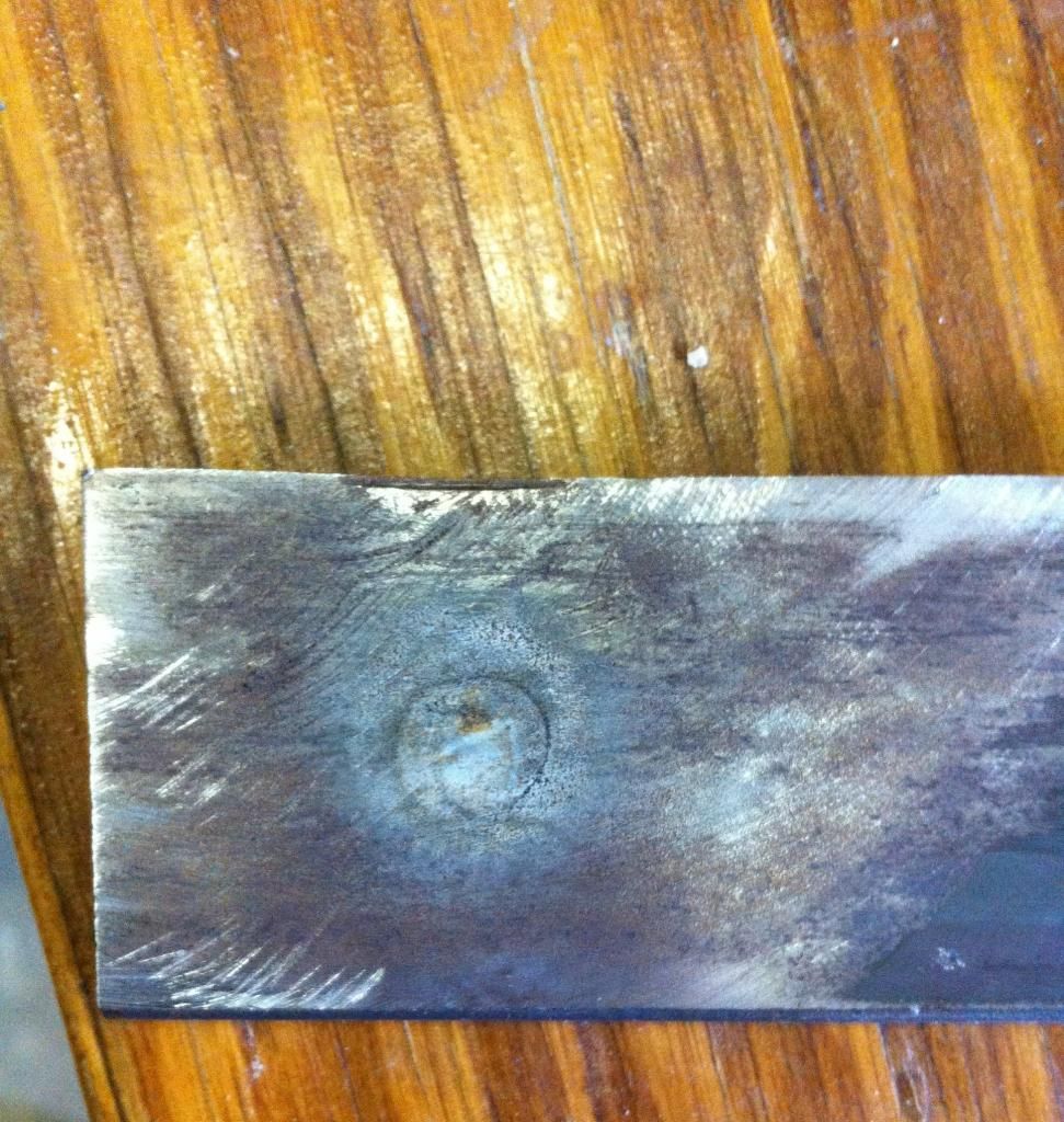

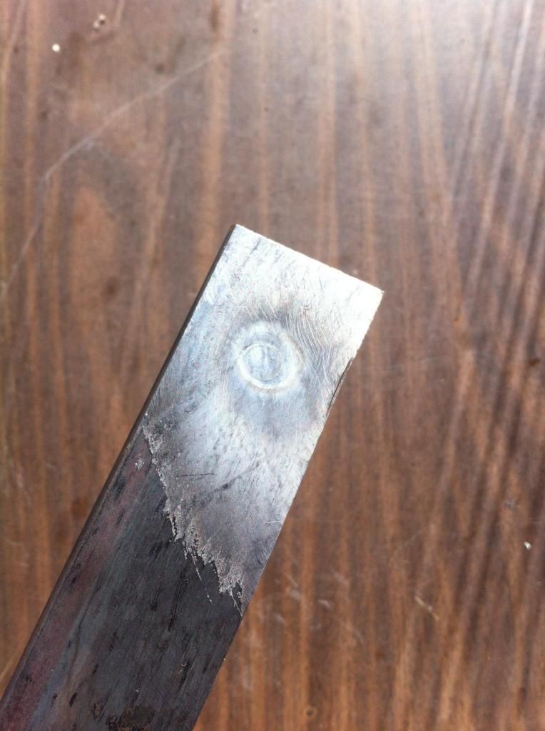

results are in...
here is my nail that had no primer strike on it
here is the non corrosive MFS
this is the definitely corrosive 60's milsurp
this is the new batch of " non corrosive" from Canada Ammo.
This is after 24 hours. It has has been cool today (18°c) and rainy (this test was kept outside, but out of the rain)
