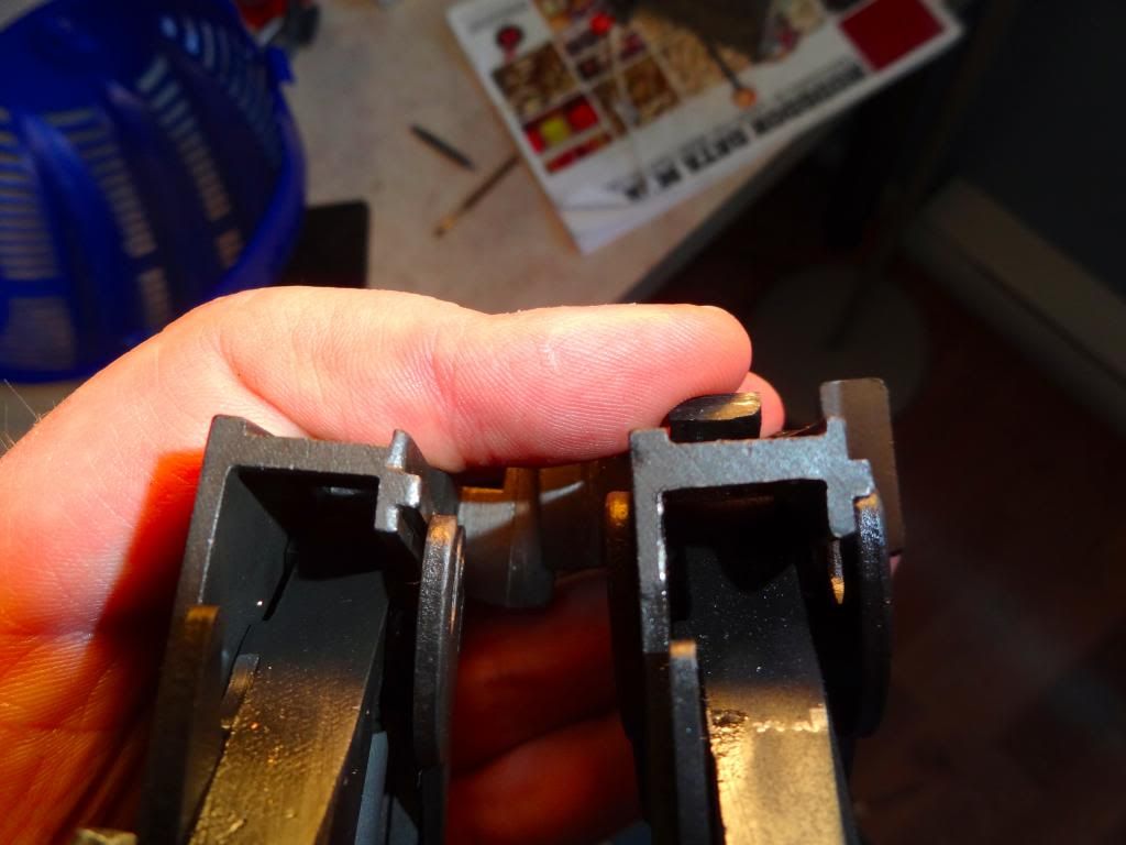

Found the cause of my light primer strikes !! The trigger group housing wall is too thick causing the hammer not to drop fully extended as it should , it will be a quick fix with a small file .. Heres a pic , good trigger group on left bad one on the right .

Wow. That looks like crap. Talk about "hand made"
