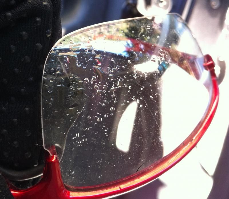

Be sure to do a thorough job of removing all that oil. Apparently, there was a fair amount lurking underneath the rear sight assembly that flew into my face on recoil. This oil stayed there despite the rifle's few days in my safe, standing on its butt. Good thing I was wearing my eye protection.
