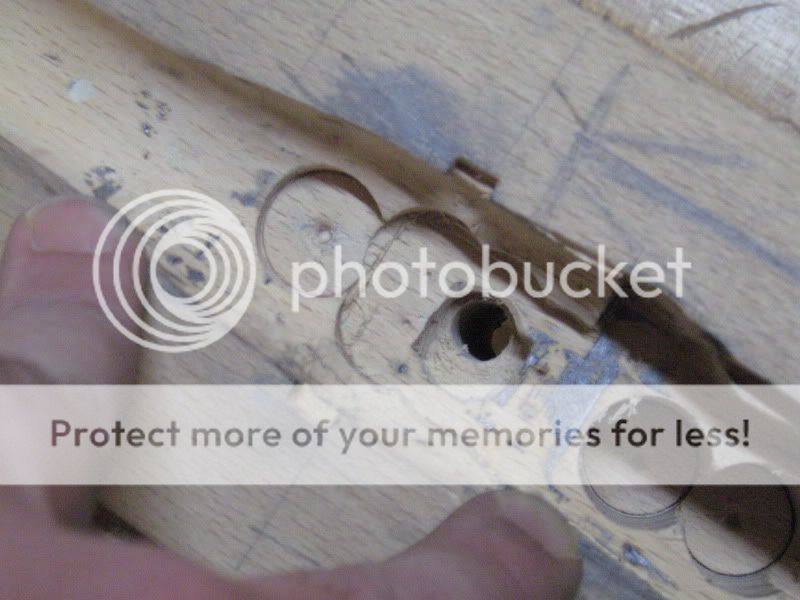

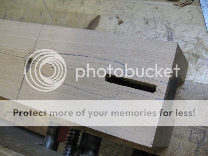

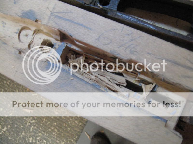

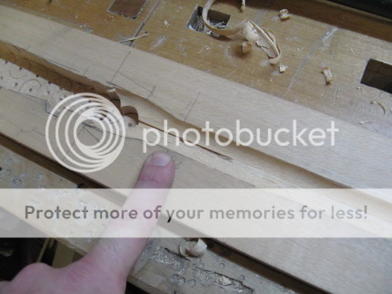

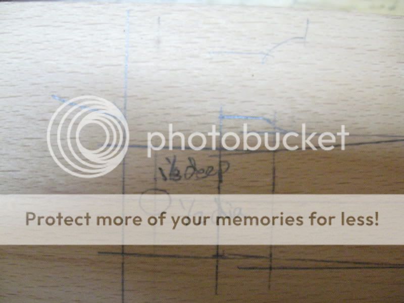

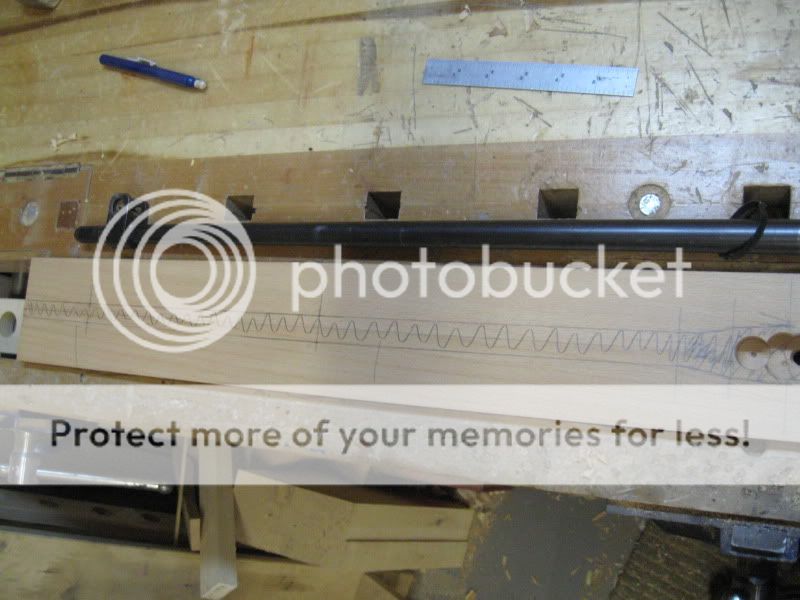

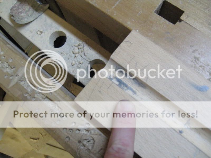

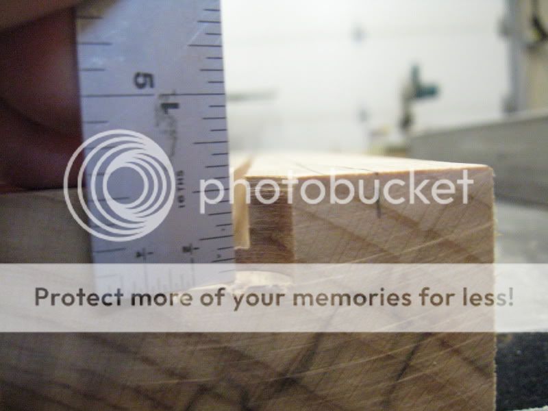

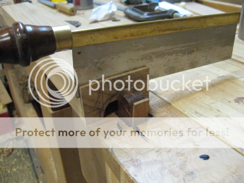

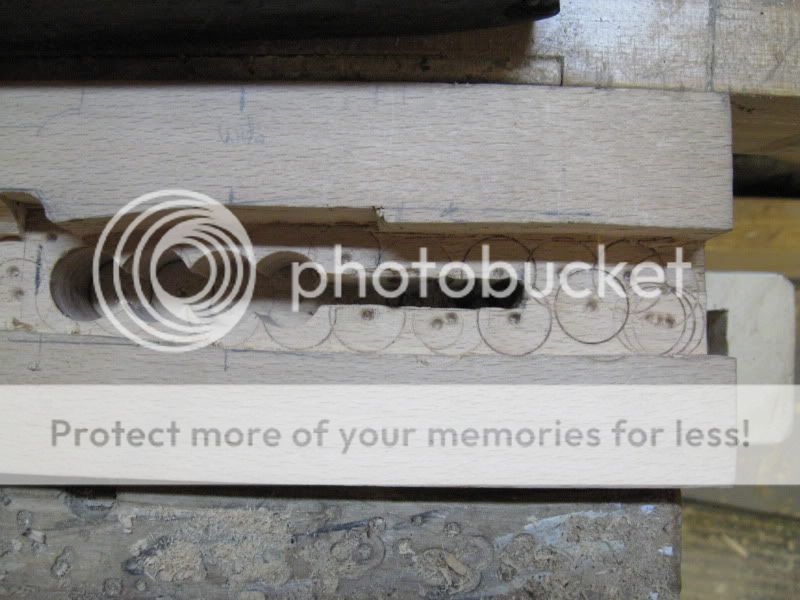

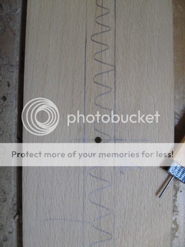

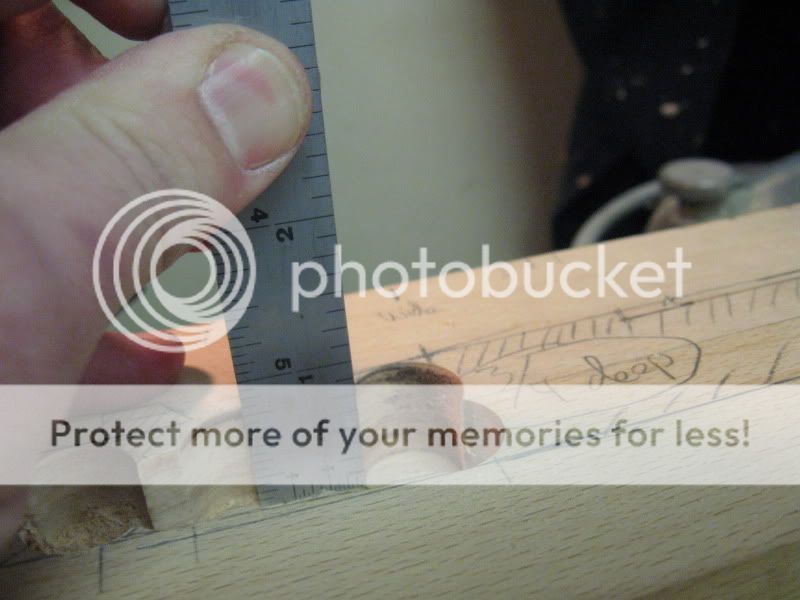

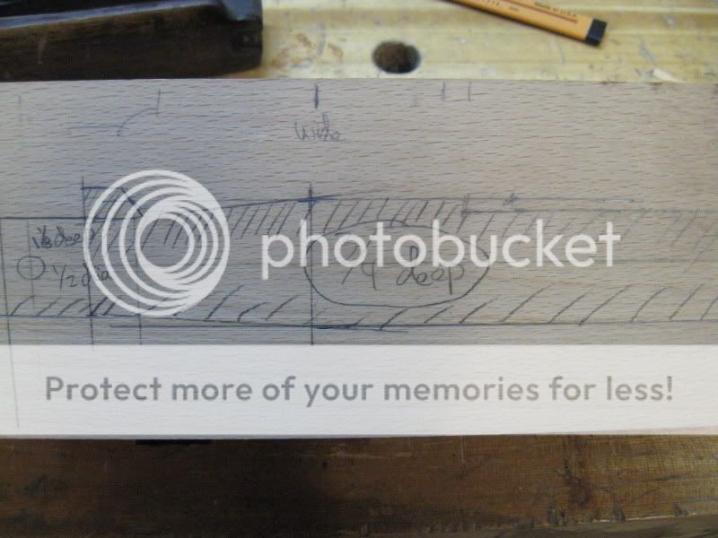

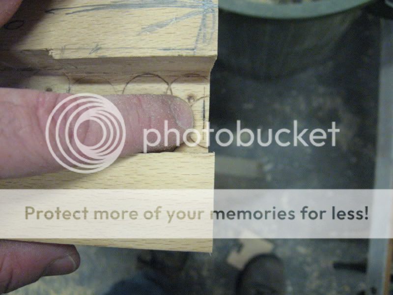

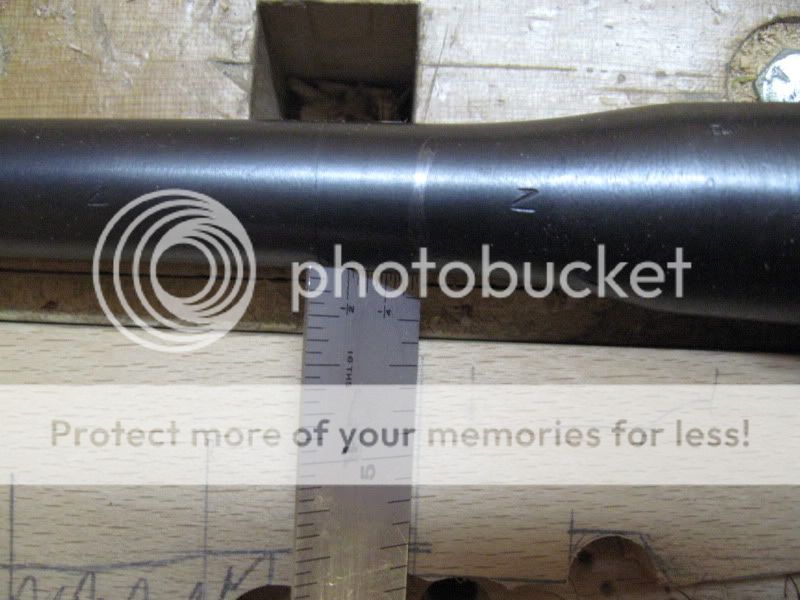

Next mark everything, and take the fostner bit to the press drill to remove wood

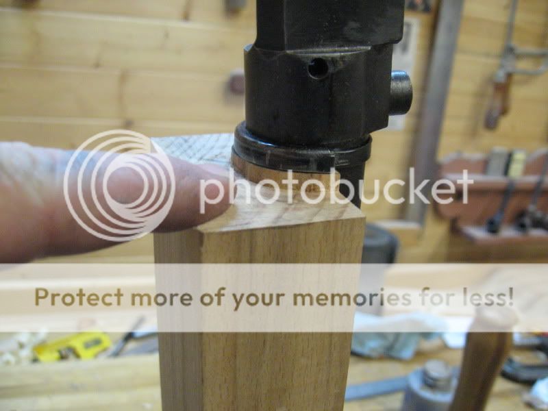

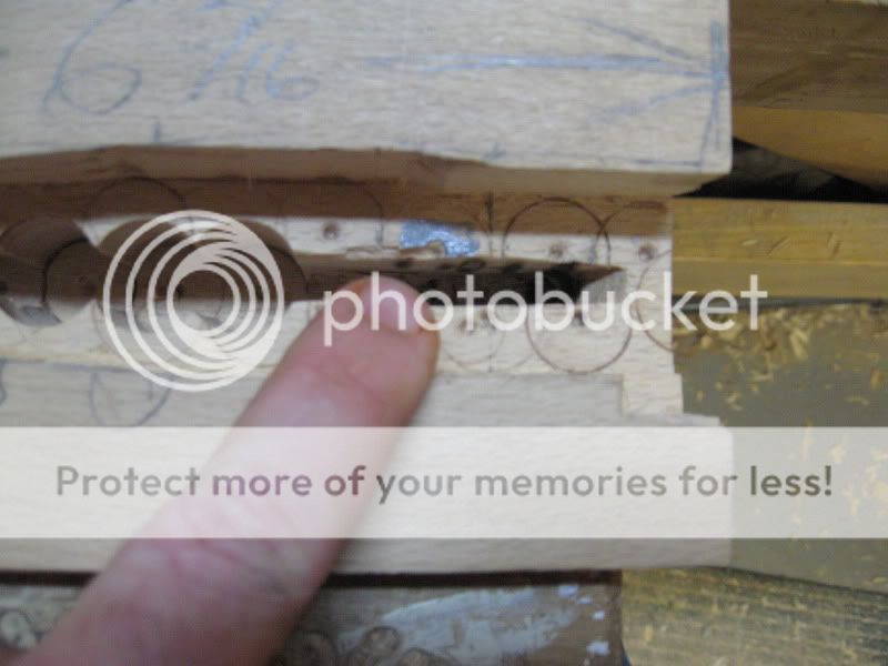

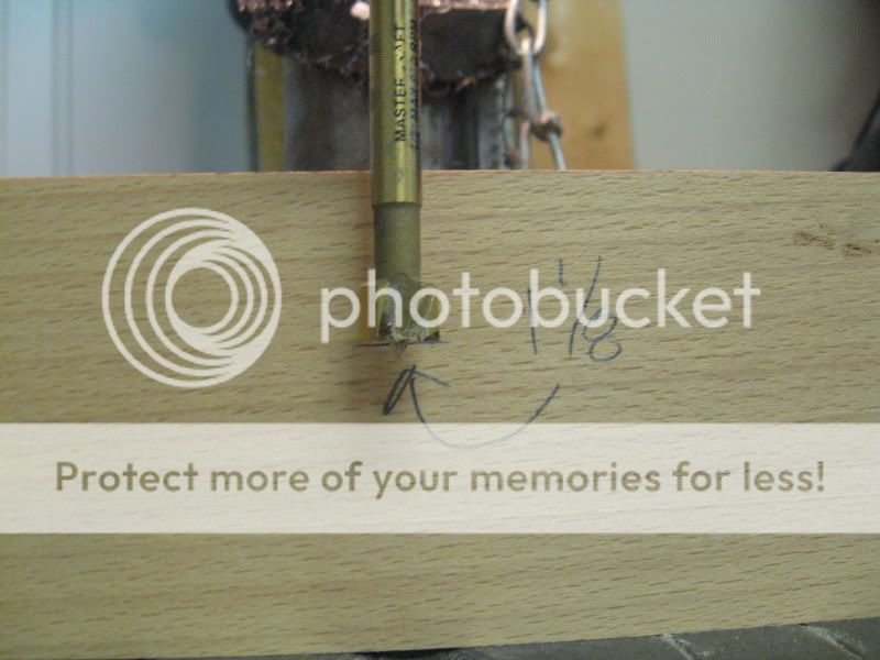

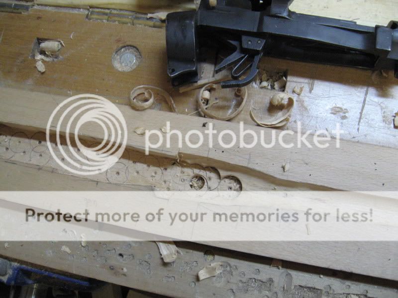

Punch the center of the hole, adjust depth, and do the hole, next take a bigger bit (3/4) adjust depth, and remove wood

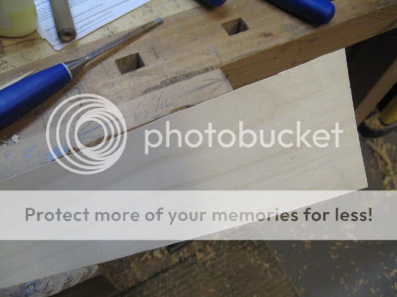

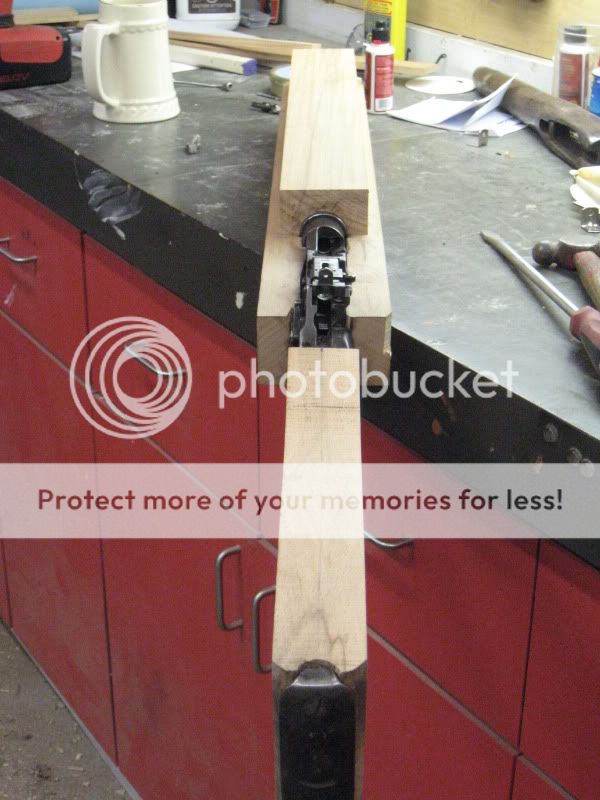

You will end up with this

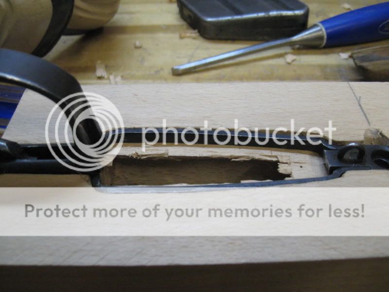

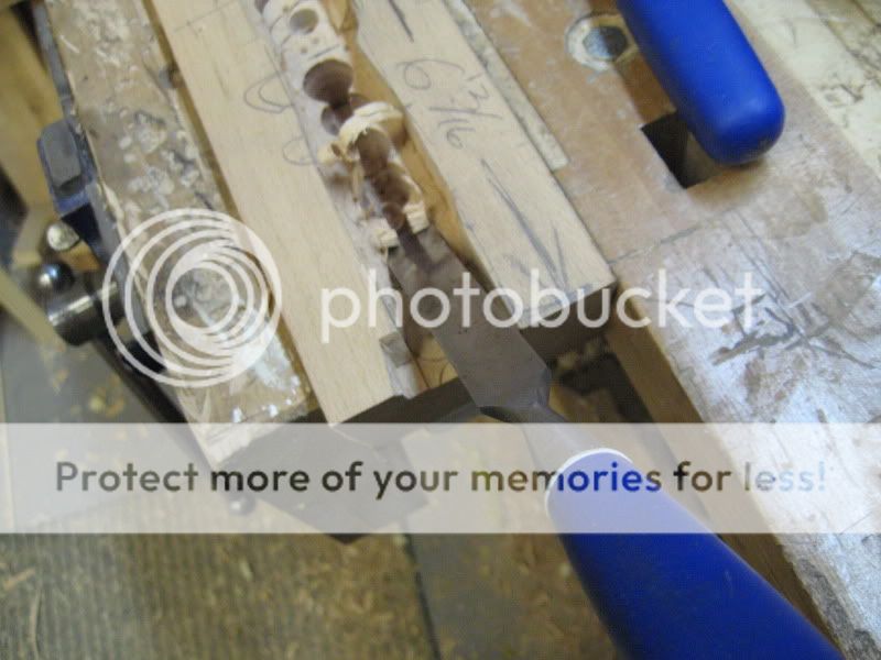

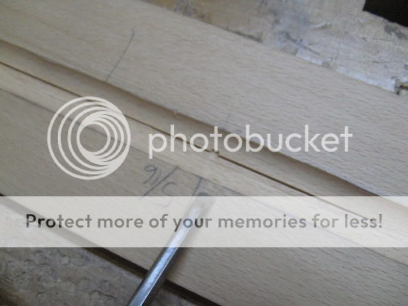

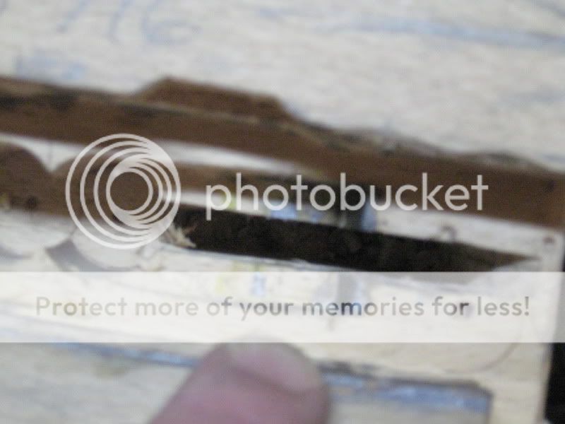

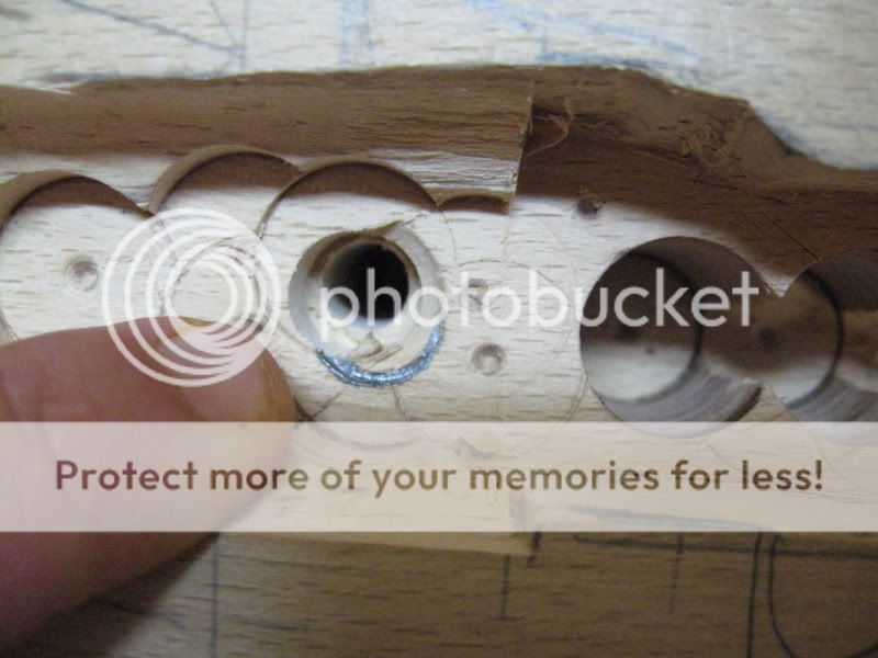

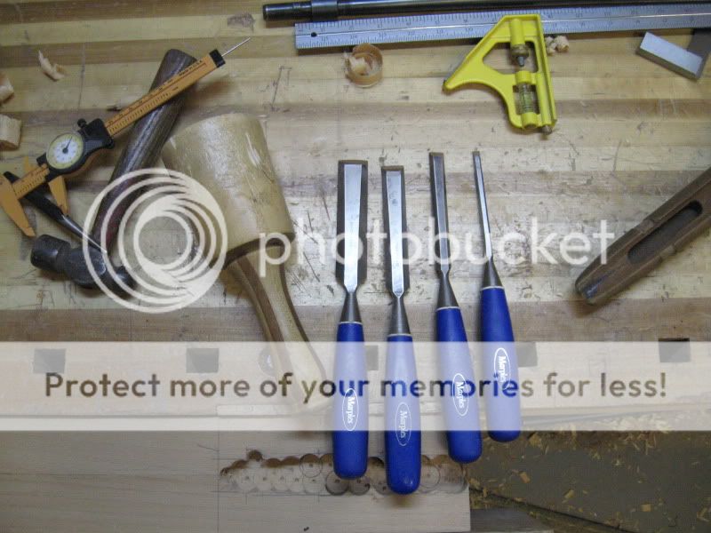

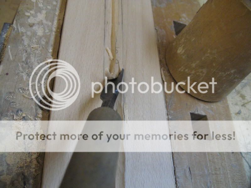

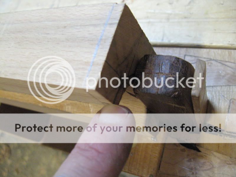

Next, take some SHARP chisel, and follow the line. You will end up with this. Don't bother going precisely to the line, we'll come back later for this.

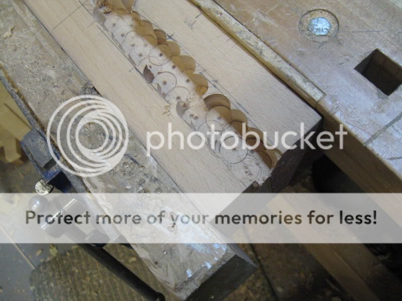

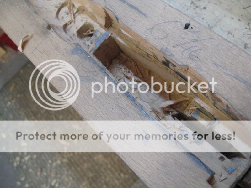

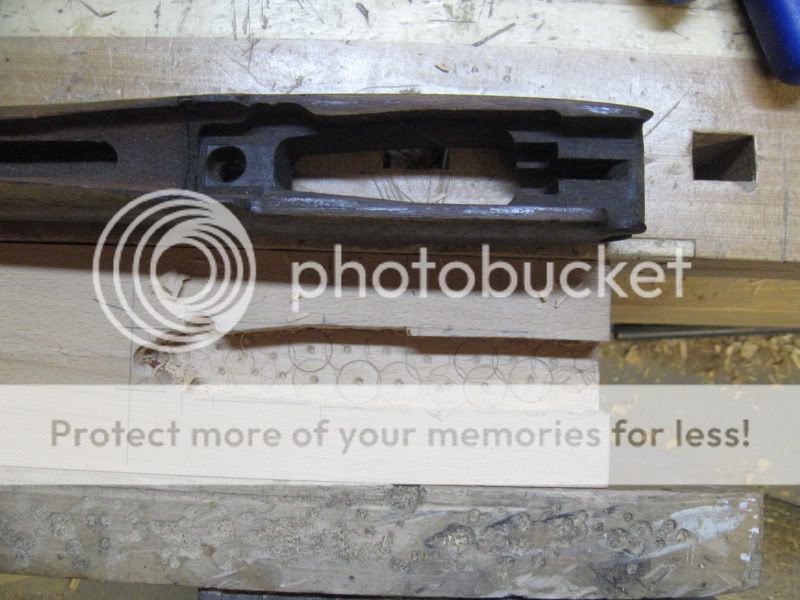

Hope you enjoy this step by step stock making !
Edit : You could go with a router and a jig, but personally, I do prefer the hand work. And it takes me less time doing it by hand that building a router jig.
