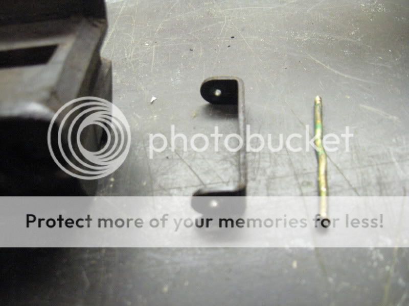

After following this thread for some time, you have convinced me to finally get an Enfield. Who knows, maybe I will make a few furniture sets up for it at some point! But I digress, here is my new baby.
Yup, you read that right, I'm done ! It only need a couple of coats of linseed oil, and it will be ready to shoot.

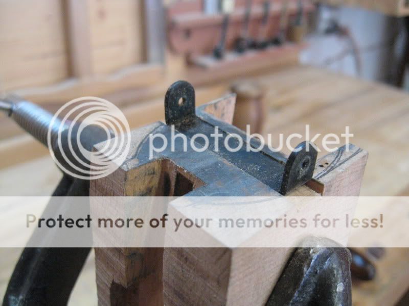

First I removed the reinforce piece from the old stock, and I fitted it on the new one

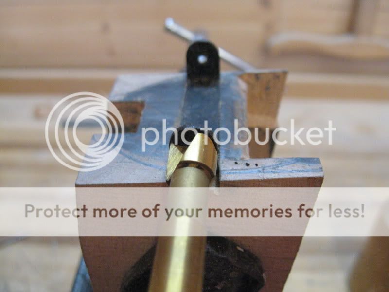

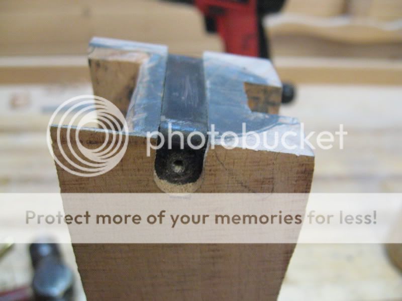

Next to do was to fit the sling swivel on the buttstock. As per my habits, I used the fostner bit, with a bit of chisel work
Next and last, I shaped the wood with the hand-held grinder with a 60 grit sandpaper. Got to go slow on this. Also a bit of rasp workk was necessary to do the interior of the "handle" on the buttstock

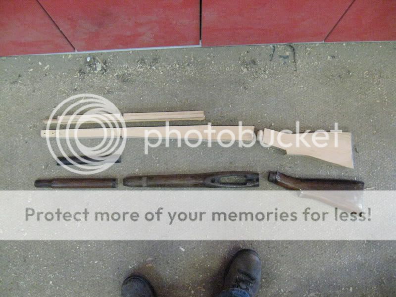

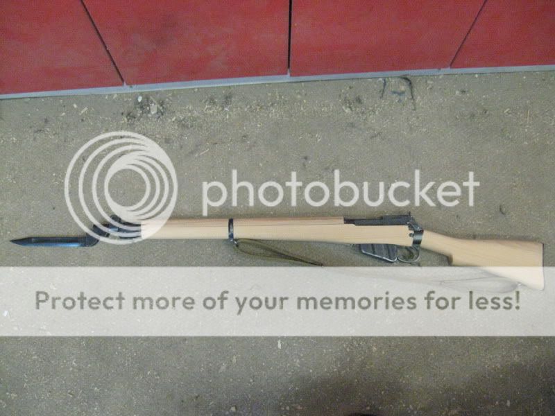

Here is a pic with the parts I used as reference, and a pic of the completed woodset, before finish.
I'll post pics when the finish is applied
I would like to thanks all of you how followed this thread. Thanks to Louthepou for measurements, to Goldidig for the free parts, to Ebruder for the front band, to TradeEx for the bayonet and sling, and the rest of you for your good comments. The final result is a bit "fatter" than an original, but hey, I like it like that.

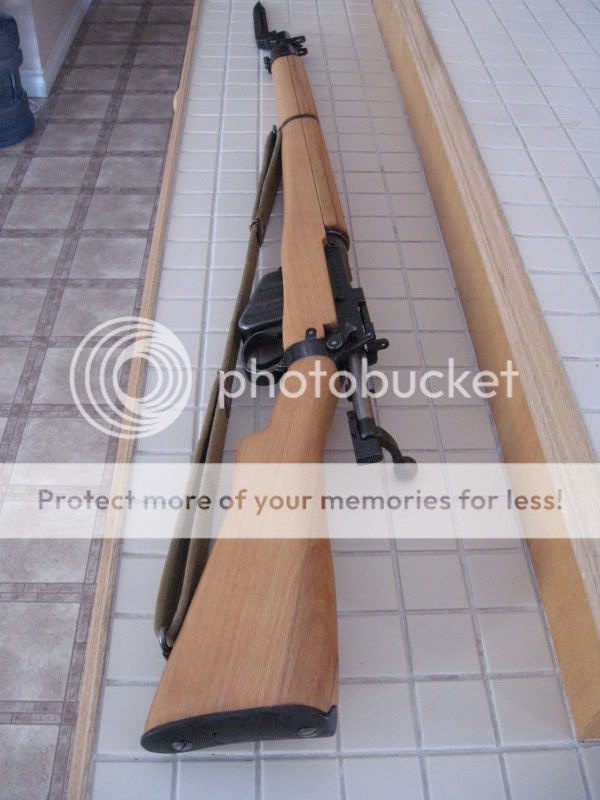

And here it is with a couple of coats of linseed oil. Exactly the color I wanted it.
it took around 27 hours of total work to make everything you see here. I counted my time just to get an idea of how many hours required to build stocks.
