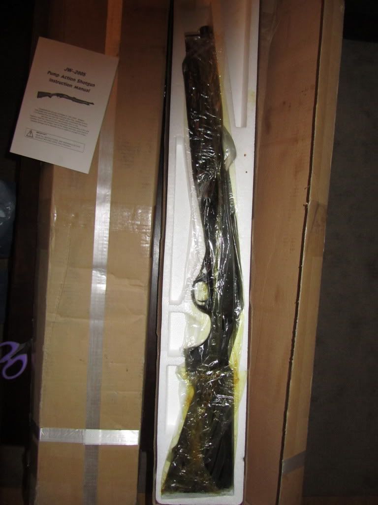

Thanks for the link! Back to getting the gallon of cosmeline off...

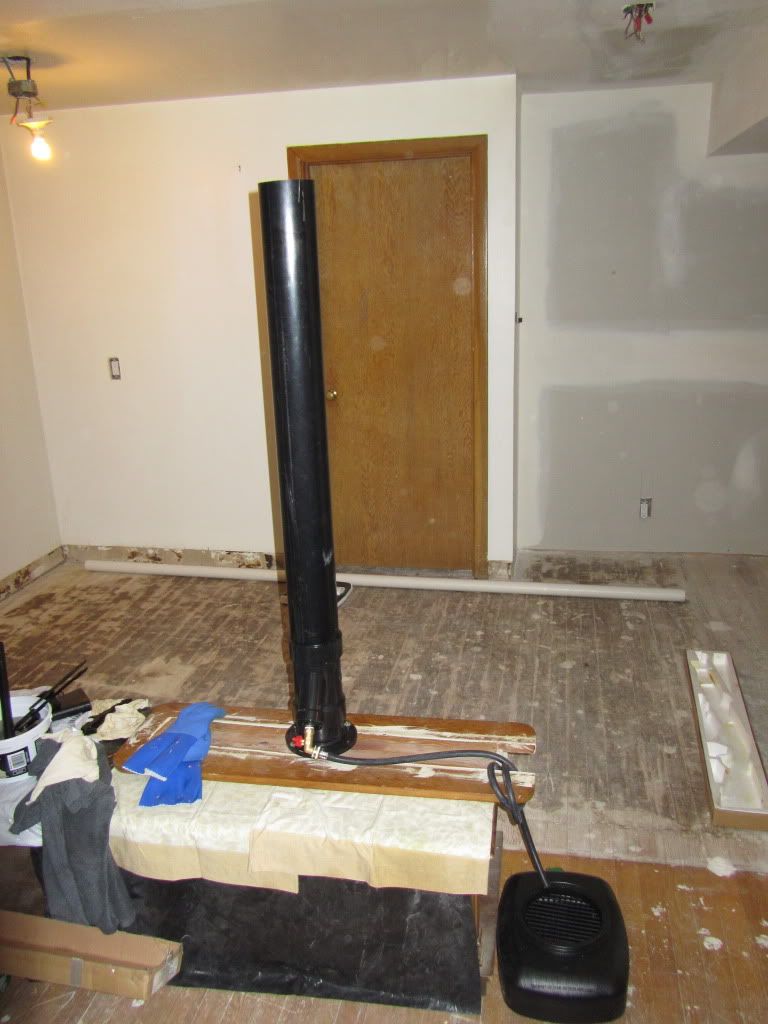

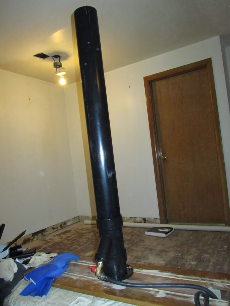

Best advice I can give to you is buy yourself 8 litres of mineral spirits and build a cleaning tank(will last forever). I constructed mine out of a 4" ABS drain pipe aprox 36" long and added a 4"x2"x4" Y connector where the 2" is a Y and placed a 2" to 1 1/2" reducer with a twist in valve and a washing machine hose attached to drain the mineral spirits when done. Capped the end off and screwed 'er down to a scrap chunk of wood for stability. Strip the gun down to the nothings throw the bits and bobs into a bucket of spirits soak 'em, brush 'em let dry. Fill 4" pipe and place frame/reciever on a steel coat hanger and lower down for a thorough soak, you can soak the sheet out of it, and all cosmo melts away. Let dry and then oil the sheet out of it all and put it back together. Mine now runs just as smooth as my trusty 870:) Drain the spirits and filter through cheese cloth and it's very re-usable.

Pulled mine out of the box today. Cleaned it up, Racked it back 3 or 4 times to insure smooth operation and the extractor broke off. Fml.

Hmmm.... the wife is going to kill me if I start ANOTHER side project before I finish the washroom, but... do you have any pics of your contraption? :p
Sure thing, will post up here R:d: Working on the washroom eh ? Strangely that's exactly how I requisitioned the "extra" ;) pieces I needed for my rig lol. Sadly I must admit downstairs bath still isn't finished
Hope this helps, it's tough to illustrate the detail in the pic's
If you have any questions I'd be glad to answer, plus just made a video of it I could send you (if I can figure out how):bangHead:
