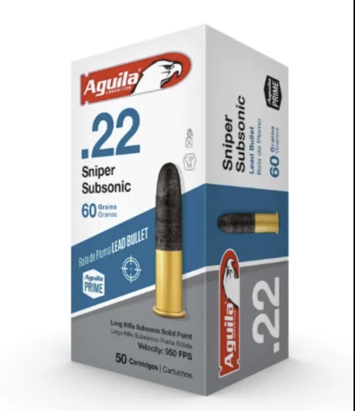

Mine works well with Aquila 60 gr subsonic, that's basically all I shoot out of it.
