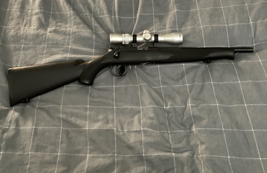

Mine, a 13" hiker purchased in 2015 or 2016, is my steadfast companion and one of my favorite, if not my absolute favorite, guns. It's extremely accurate - I can basically always hit a 6x6 steel plate at 130 meters with a cheap Simmons 4x and crap ammo. I've frozen the gun in -40 and fallen down foothills and gravel roads with it. I've literally pulled dried vegetation out from between the stock and barrel that I missed and had to be in there for many months.
No real issues from it or the scope. Lost the front sight protector in the bush. The scope rings have come loose a couple of times. Loctite won't hold for some reason, but that's probably a ring issue and the fact the gun gets rode very hard. The finish is really resilient for a simple but really deep bluing. Safety was difficult to engage/disengage for a while when new. Fixed itself.
I will note that if you hold the gun from under the magazine it can cause feeding issues. I don't do that anymore so problem solved. This gun is far more accurate AND reliable than my Savage BTVSS (BVTSS?) laminate stainless steel .22. The one thing I wish this gun would improve on from the factory is the muzzle's crown. It's not very recessed and when falling with the gun climbing up or down something rocky (obv. unloaded) I get a little nervous the muzzle will be damaged. Hasn't happened yet though.
If could only own 1 .22, this would be it hands down. I should buy another.
