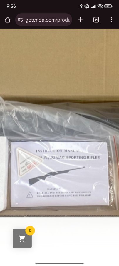

It's literally on the owners manual of the NR-15. Is the 22 magnum version still produced Tenda?

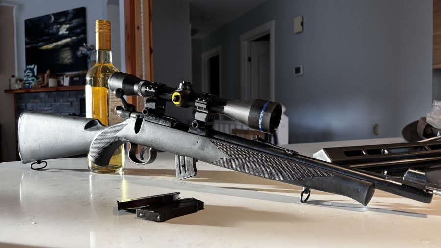

Best bet if you want an easy, light and compact setup is to remove the iron sights and run a micro red dot using a rimfire to weaver adapter on the machined rail cut in the receiver.

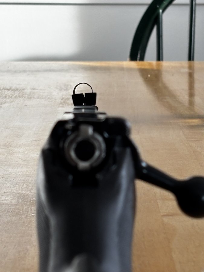

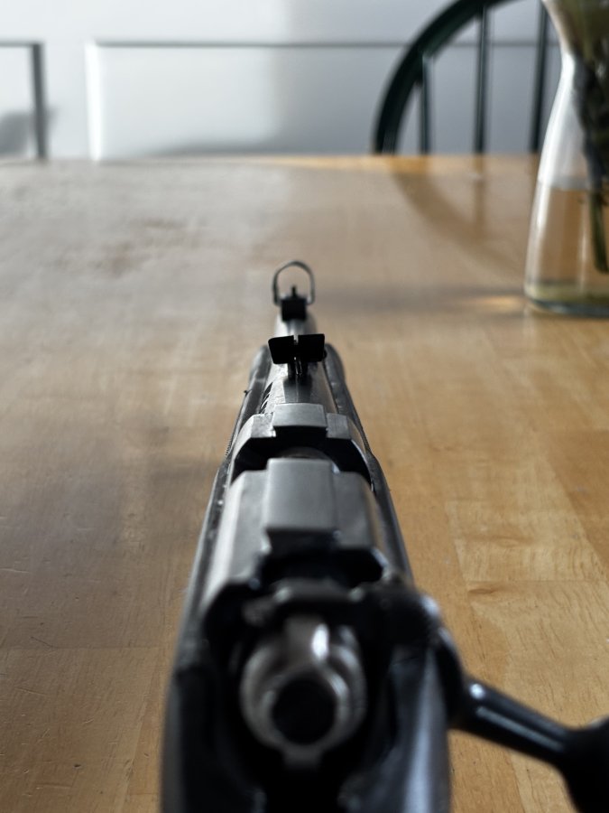

Received my order today. Fit and finish is as expected, but the iron sights are quite poorly oriented. I’ve emailed tenda to ask if all of these rifles are like this or if this one somehow snuck past the factory QC 🤪
Update; since this thing is so crude I’ve simply decided to use a set of needle nose pliers to ‘adjust’ the rear leaf sight. Wasn’t planning on using the stock sights anyway seeing as I have a cheap 4x40 laying around.

Despite the sights being canted, my gun shot accurately. I would try to shoot it before messing with them. My sights looked exactly like wolfd89’s but functioned just fine.
Also I noticed my dovetail is tilted clockwise about 8degrees.
Pretty noticeable when you install a dovetail mount.
Is everyone else's dovetail similarly tilted?
