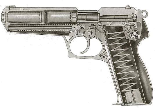

Squeeze to set up the striker. It locks to the rear and is held back ready for release and the spring sends it forward onto the primer. I assume the 77B is striker fired too.

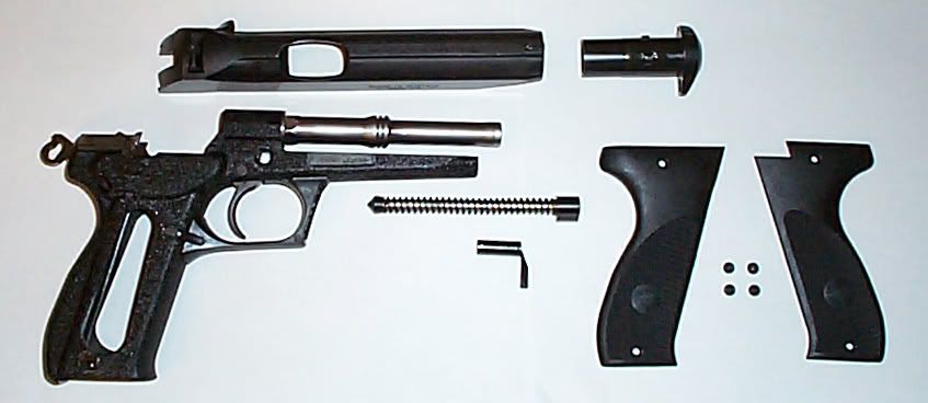

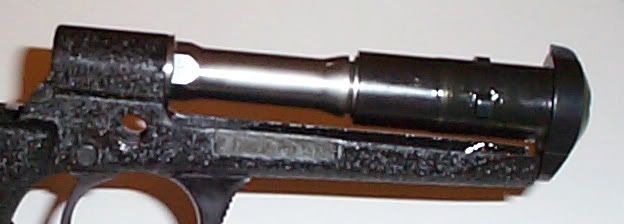

The Steyr GB is a gas brake system. There are 2 gas ports located halfway down the barrel. The barrel just before the gas ports has 3 gas sealing rings. The gas is bled off behind the bullet and fills the void inside the slide. The bushing on the end of the barrel serves as a gas plug. The pressure prevents the side from recoiling backwards until it drops to a safe level (after the bullet has left the barrel) and then the slide can cycle. It is a ridiculously simple system and results in a pistol with very few parts (someting like 30 less parts than a Beretta 92F). My GB with the comp has logged over 80k rounds with NO jams of any kind. Never had a hiccup either. Like all gas retarded pistols using lead bullets can lead to a kaboom as the gas ports get clogged and can lead to dangerous pressures. Always use jacketed rounds inside a P7, M77B and Steyr GB.

Thanks for the pix. I believe you are the first poster ever to post the real goods. We do need targets and groupings though.
I'll try to post pictures of groupings in the next little while. Going to try to take it to the range again on Thursday and drag the digital camera along. The way that the trigger guard cocker is made it is very very unlikely that the slide can drag it back and with the blocker there, there is no chance of losing a finger.

A FA GB would be interesting. Would be a beast to control for those 18 rounds though! Your arms would start straight and end up fully bent with its recoil. Would be easy to stay on the target, esp. with the comp! The comp is very effective and dual purpose. There is a threaded insert in the end, with the insert in it is a full comp and with it out it becomes a flash suppresor that
reduces ALL flash from stiff loads. Very neat design.
