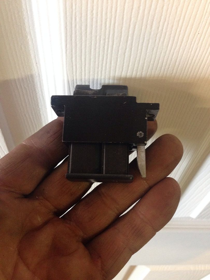

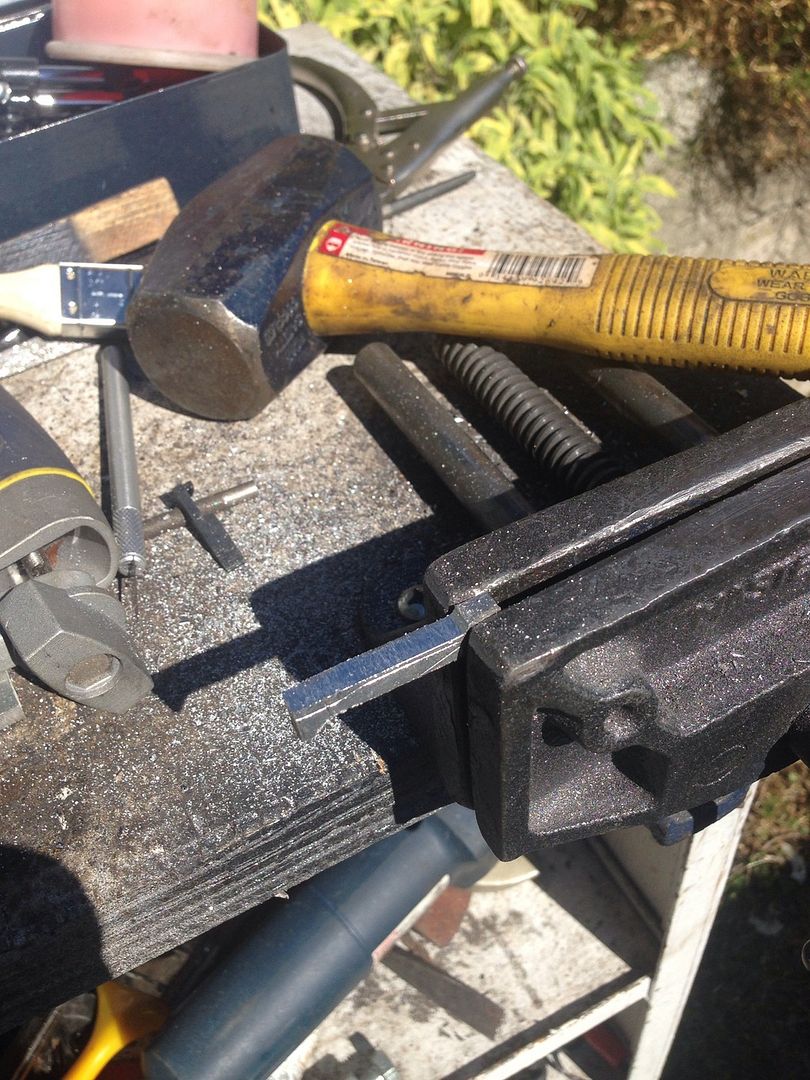

This leads me to what I have been working on for the last little while. This mod has been a very long time coming. It was the very first thing I wanted to change about my rifle. That d@mn mag release lever stabbing me in my soft and supple hands when held offhand. Coming up with a design I like is another matter though. I have gone through many prototypes in search of what I have in mind. I am close to what I envisioned, but the thing is such a PITA to remove that it takes forever to remove and shape through the various shaping stages. I snapped a few pics here and there, but I will post up the finished design step by step soon. The pics here show a version made out of 6061 aluminum, but steel will be used, as the final version will be an extended 90 degree lever style.
Now,

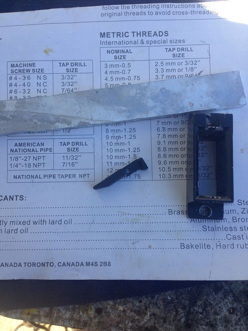

There is a wee spring in the mag well housing that is unreal to get back in. I invented several new, never before heard curse words due to this unholy spring. It is lame factor 5 in my opinion and90% of why it takes so long to remove and check the fit. Also, the fatory lever is very machined with much file work needed, so aluminum just made sense for the trials.
I will be modding my mags to fit flush as well. One could shim the trigger guard I suppose, but that would be just silly really.

Here is the wee jerk, the mag well and the 6061. You can sorta see ( if you zoom in) on how much machine/file work is needed to make one of these. A steel unit will take hours.
Here I am starting to shape it.
During one of many trial fits. You can see the housing is taking some wear from the trials. The housing itself is not steel for those that are interested.

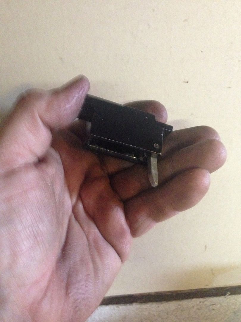

So, this shows with a mag in place. It is about 1/8in shorter than the stock one. You can see in the pic the slightly shorter (in comparison) lever to the seated mag. Why not just file down the stock one you say? Well, not sure what design I wanted, but filing down the stock one would just make a lame pointy lever less pointy, but still as lame as before. There is another critical advantage for the actual mag fit as well. Making your own gives you the advantage of custom fitting the lever to the mags. My factory lever fit like a hot dog in a hallway in the groove of my mags. Just sayin'.
