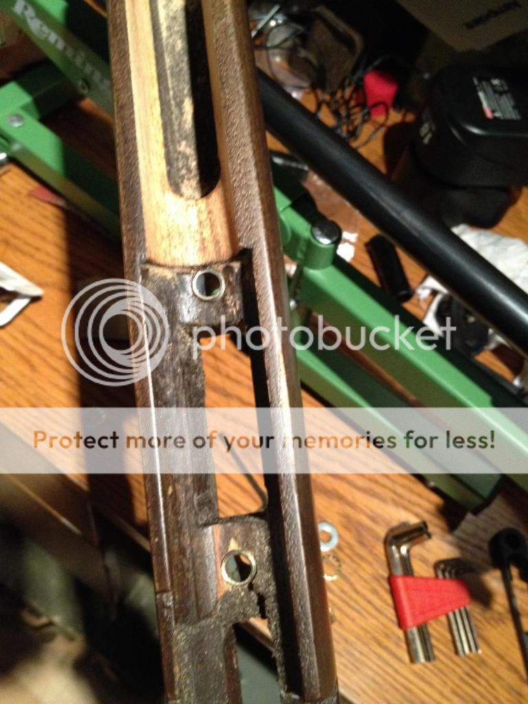

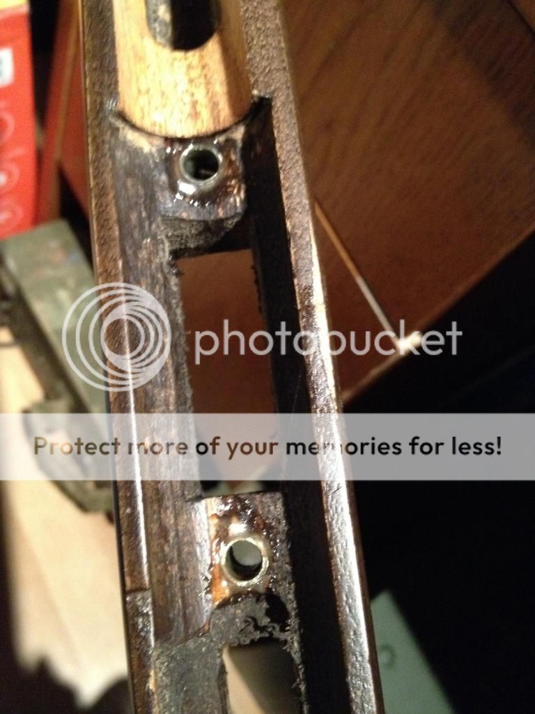

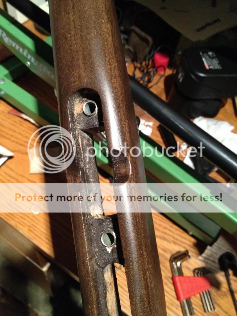

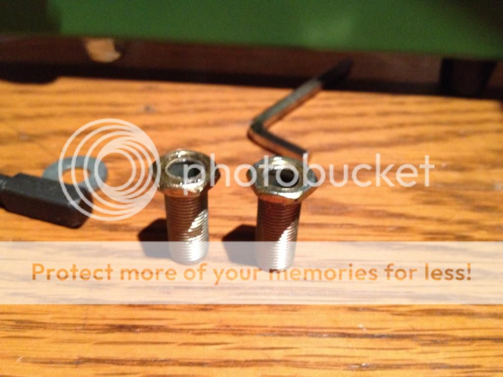

I bedded mine with Devcon, as I had lots on hand. This was my first bedding attempt and it went pretty well. I think I over did the release agent a bit, but pretty straight forward.

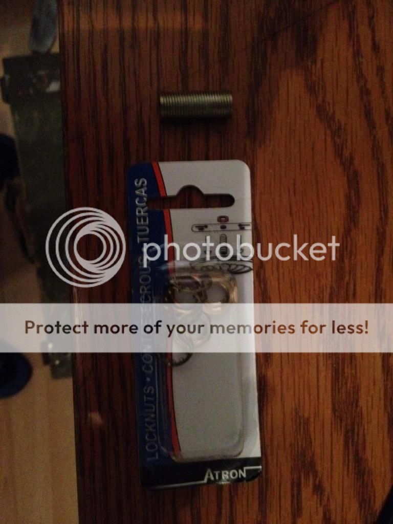

In hindsight, I should have pillared as well, rather than filling down the bolt shaft with epoxy.
Free floating the barrel was as simple as a round file and some sand paper.
