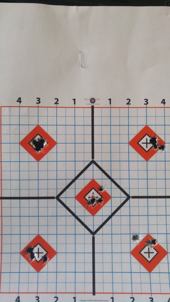

I have pillared and floated this, polished the trigger (~1 - 1.5 lbs) and played Rem Subsonics, Eley Practice, Eley Subsonic, Fed AutoMatch, Seller & Bellot Standard and Lapua Centre X, (prior trials with numerous other brands). Tightest most consistent groups come from Eley Practice for me. Currently have a 4.5-16x FFP Vortex on it, as I could only hold around 1/2" (3/4" actual) with a Nikon 3-9x thought I'd check out the magnification issues. Over the last few days I have run a brick of Eley and all hovers around 1/2" at 50M at 14x magnification. I have another target rifle that is typically sub 1/2" and ran it the last 3 days and it is holding sub 1/2" for me. The groups shown in the picture below are very typical, 3/4 shots in ~1/4" hole followed by a single or double flyers. I think I will redo the bedding for interest sake to see if I can get this hold in the 1/2" grouping. If nothing else this rifle has proved an interesting lesson and relatively "cheap" fun in accuracy/marksmanship.

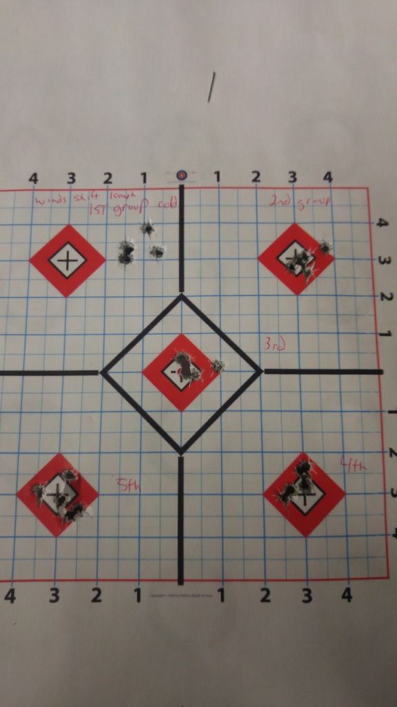

1 square = 1/4", the wind had shifted 10mph 3 to 9 o'clock ~ this morning from yesterday.
I checked my bedding and all appeared well, but the hex m6 bolts felt a bit "sloppy" fresh hex bolts and torqued it all back together. I discovered if am willing to destroy staple removers they have a perfect fit spring as a replacement trigger spring. Paint job was stolen from someone earlier in the thread.
I am now a very happy camper having run 10 - 50M 5 shot groups, 5 of which were sub 1/2", 3 just at 1/2" and two just over 1/2" (~6/10") winds were light 5-8mph with occasional switching gusts but pretty steady from 9 o'oclock. I believe higher/better magnification would resolve this.
Excellent results!
