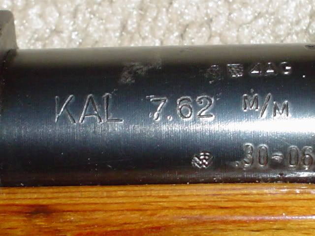

I assume you mean the M954. If so, they were NOT manufactured in Brasil. They are DWM and Mauser made M1908's and M1935's that were the most badly worn rifles in inventory at the time (1954). The Itajuba arsenal stripper the actions, scrubbed them, parked them, installed new barrels and usually new (lower quality) stocks, and stamped them M954. They did NOT manufacture any Mauser receivers. They are a brazilian made rifle only in the sense that a Finnish Mosin is a Finnish made rifle.
That matches the one I had. It had serious headspace issues, and the stock looked like it was used to drive railway spikes. It also had a very soft action and a gunsmith who was attempting to remove the barrel colapsed the action just a bit over the bolt locking lugs.
The action seemed to be just a bit longer than the 8x57 and there is no cutout for the nose of .30/06 bullets in stripper clips.

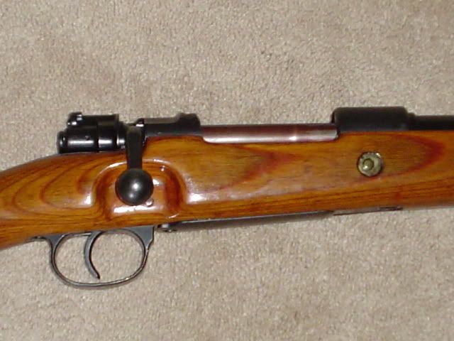

FR8's a great little gun. Don't have one of those either, Coyote Ugly?

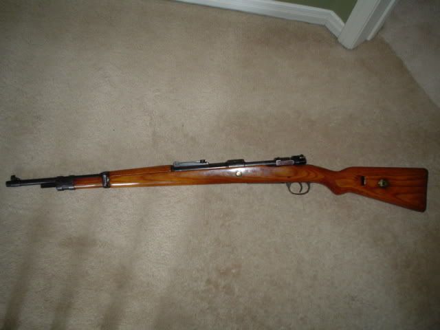

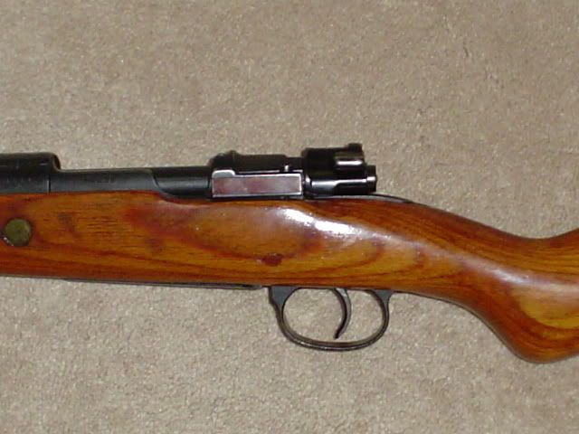

How's this one Stevo? ;) It's one of my favorites, and all original.
a
BTW: that's not technically a German military K98k. It appears to be either a Standard Model (export model) or a Karabiner Fur Deutches Reichspost. I can't tell without a shot of either the sidewall or the bolt handle.
It's pretty, but it's not collectible by your definition since it's not German military issue.

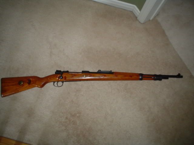

A real German issue military K98k looks something like this:

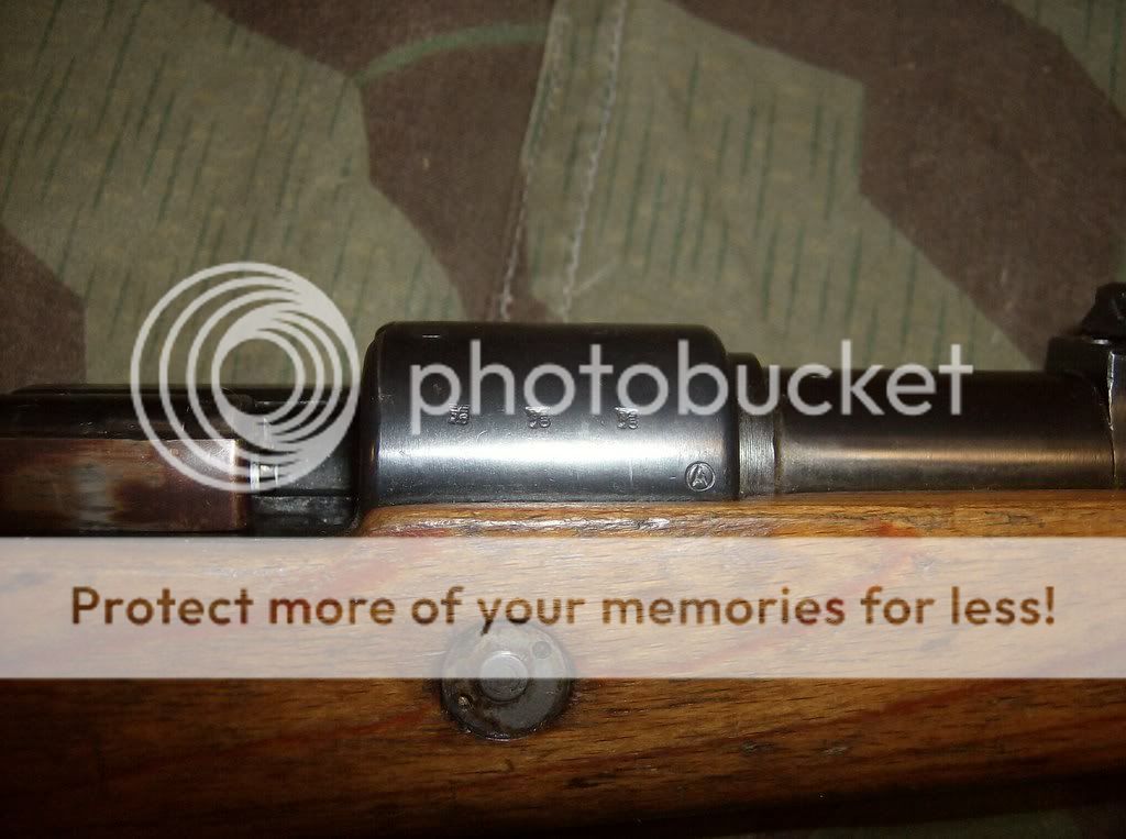

And here's some receiver detail of the Norwegian K98k's you dislike so much, in this case a less common air force model:

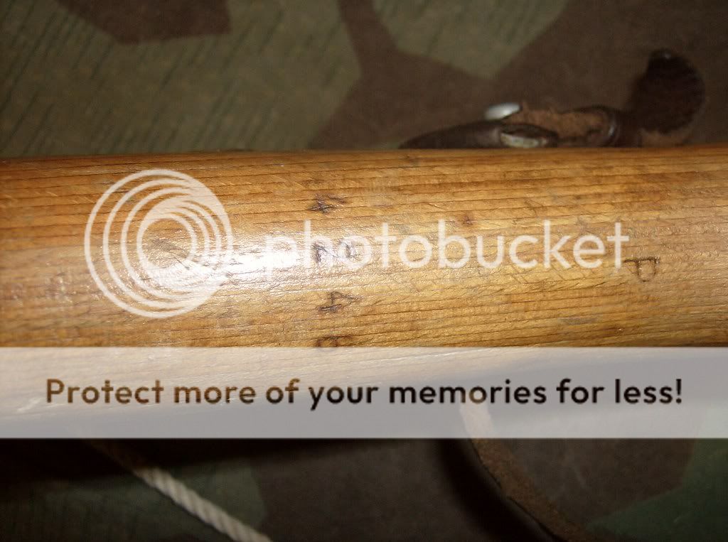

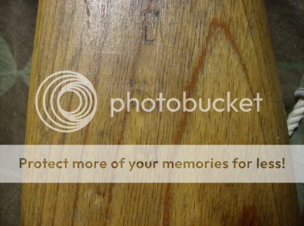

From personal experience (yes, I've fondled MANY of these guns over the years), about 50% are covered with a thin coat of varnish put on by the norwegians, presumably to make the stocks more weather resistant.
NONE of them are oil soaked and none of them have cosmolene under the wood, just thin gun oil. I've not seen a rusty one direct from surplus either FWIW.
About 50% of them were sanded at some point, likely because the stocks were beat up enough to require sanding when the rework was done. FYI, the Germans also scraped and/or sanded stocks at rebuild.
Also, about 60% of them have a hardwood re-inforcing dowel through the trigger web about where the bolt dish cut is. This is also Norwegian army done, much like the milled flat on the receiver. Frankly, it's an intelligent modification that the Germans SHOULD have done as stocks frequently split there.
Here's some random P&S examples that clearly aren't sanded nor stained as you claim:
Perhaps you should consult books or the owners of these guns and not vague internet posting on another forum. Doing otherwise tends to make you look like an unreliable source for future reference.
