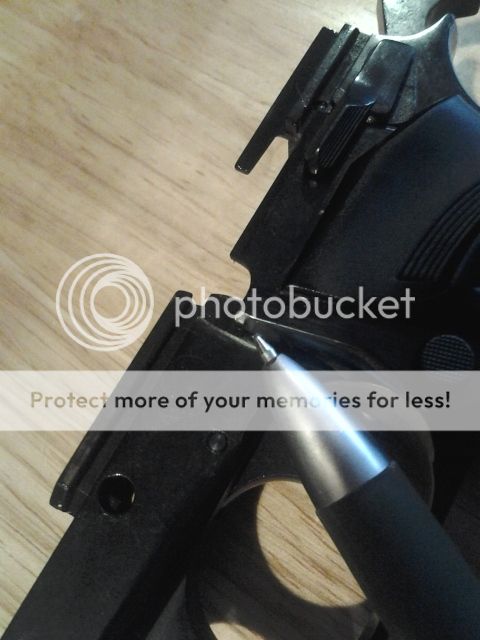

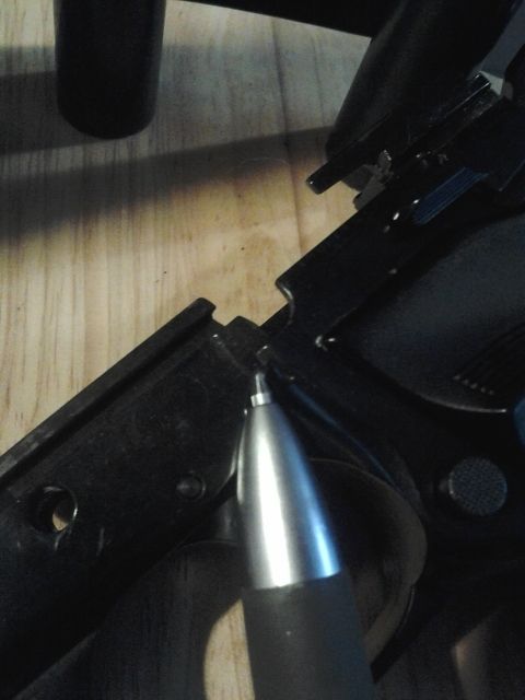

Yes, I am following the takedown procedure. However, I have found what seems to be the problem. There seems to be a bit of a metal burr that is preventing the rearward portion of the lever from clearing the frame. I had to use a thin tool to gently lift the lever over the burr. It probably can't be seen too well in the pictures, but the burr is easily felt with a finger. But, it's a minor inconvenience and hopefully will disappear with wear.

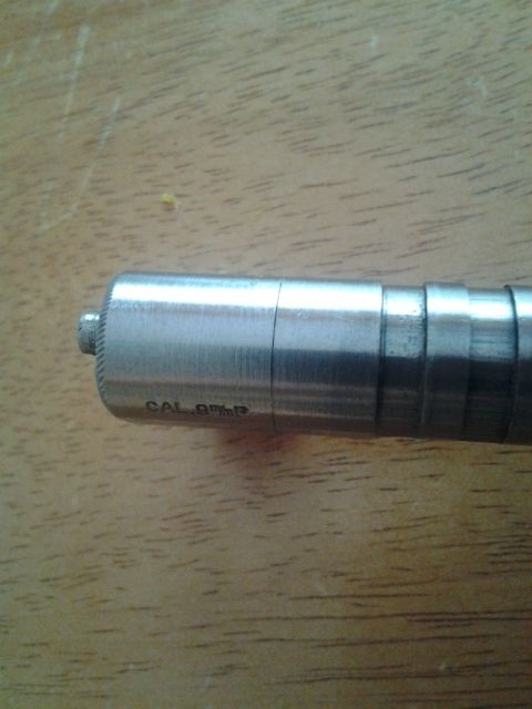

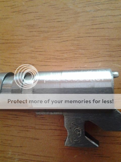

But I am curious about another issue. I have called Questar and sent them an email via their contact page. They were closed for the day, and so hopefully, I will hear back tomorrow. But, I am going to post an additional pic or two here of the issue for reference just in case they didn't make it through cyberspace via Questar's contact page. The issue is...is the following a crack in the chamber area, or a machine mark? Running a fingernail across the line, results in the nail catching.
Design of the gun requires user to lift the slide release up (towards the top of the slide) while pushing it out from the other side. Once slide is locked by thumb safety in second position, I grab front of the gun with my left palm, use my left thump to lift the slide release up and use right index finger to push the rod out towards me. If yours require excessive force while doing this, might as well take it to a gunsmith so he can clear that burr with couple file strokes and refinish.

Raising the release up towards the slide doesn't work. I had to lift the lever out towards me with a covered screwdriver blade to clear the burr. Once literally "over the hump", the lever was able to be easily removed as per the manual and your description. It's small, but tactile and just big enough to prevent the lever from clearing the frame.
