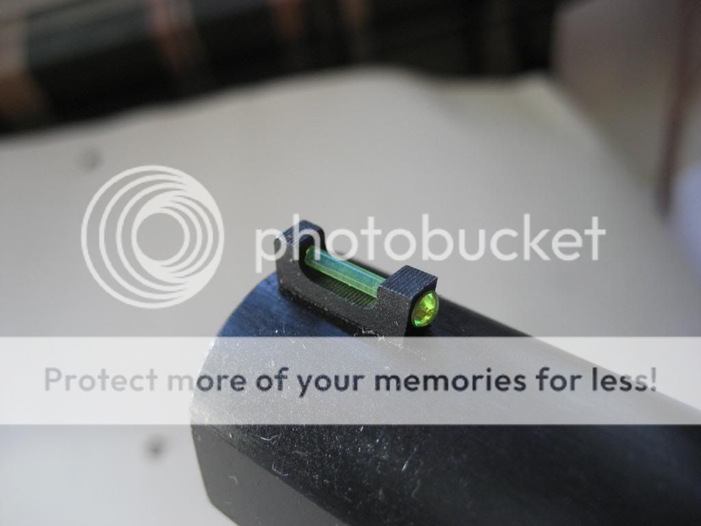

Lots of options. I switched to fibre optic.
