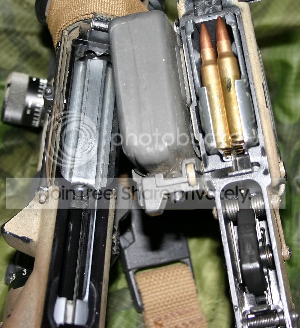

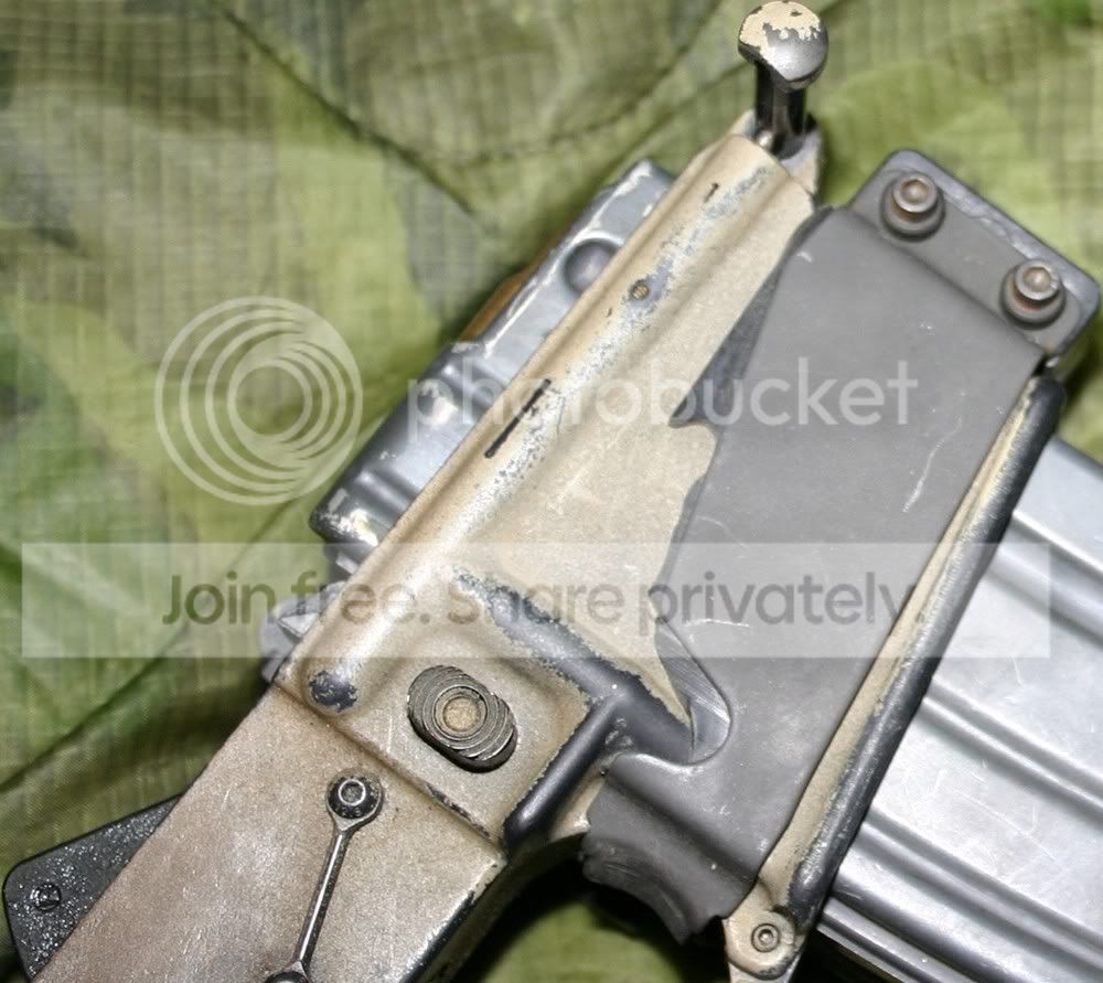

I took some pics of my rifle to explain this.
Without the upper on the rifle - dimensional play allows for some slop on the mag - magwell fit
As can see in the two pics the mag can rotate a bit (2-3mm from the upper and lower limits on the front of the mag)
With the upper on the bolt actually stabilizes the mag.
The channel on the bolt carrier allows the rounds to pressure the bottom of the bolt carrier - but the mag feedlips do not really touch the bolt carrier (the bolt can drag across them though)
