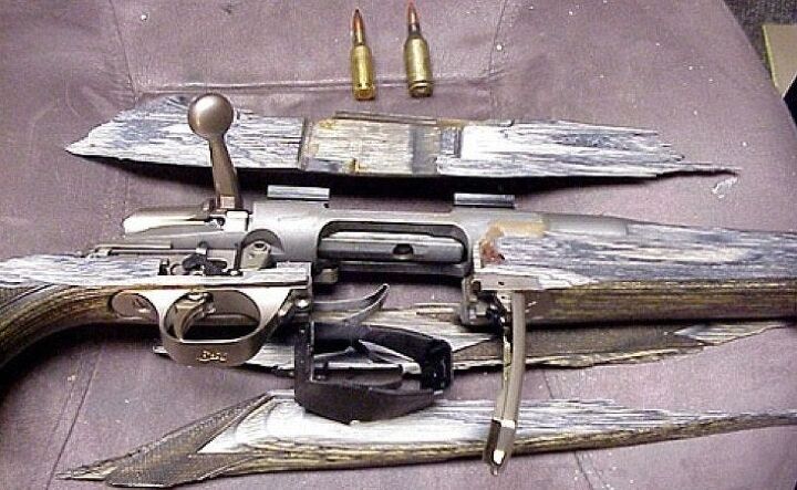

Anyway, what makes you think that extractor will fly anywhere at the first place? You THINK it will? Lets watch barrel obstruction tests:
Do you see ANY extractors flying anywhere? Couple of rifles exploded to bits (Rem 700 is one of them ironically) - I don't see any extractors flying.
A-bolt totally explodes - bolt to receiver as we see practically intact:
http://www.thefirearmblog.com/blog/wp-content/uploads/2013/07/A-Bolt-disaster-660x406.jpg
Savage blows up - bolt is holding just fine:
http://s273.photobucket.com/user/marshalette/media/gun%20stuff/muzzle4jpg.jpg.html
But its all bs because you saw a Rem 700 chambered in 7mm rem mag ( 3,200 ft x lbf energy ) firing .303 Brit ( 2,630 ft x lbf energy = 20% less ) and it was fine. ONCE. And you never did it again with anything else, but you THINK it proves that Rem700 has a DESIGN advantage over all other 2 lugs.
