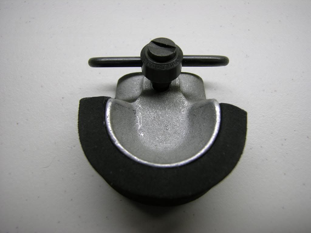

Yes they are different .The C3 used a an alloy hand stop that had apiece of foam that was glued to the area where the web of your hand went.
The C3A1 used a plastic handstop with a spigot for the PH bipod
The hand stops are quite diffrent.
The C3 is cast aluminum with a 5/16" thick foam pad glued to it. The same thing can be found on the Parker Hale 1200 TX except it's bright and the C3 has a "parkerized" type finish on it. I've only seen a few of these. You won't find one of this in a retail store.The sling swivel is marked "Parker Hale" and screws into the stock rail in one of 11 positions.
On the other hand the C3A1 is a black nylon molded handstop machined to accept the bipod spigot. It fastens to the stock rail with a special screw which provides a pocket for the QD swivel shown in one of tps50701's posts. The bipod then affixes to the spigot.

Yeah, I know all about the PH Handstop and bipod, since I own both, but I didn't know about the C3 one being different.
It sounds fragile... Would the foam ever wear off, or the glue get weak?
The C3 foam is a closed neopreme material....very rugged......no visible wear and well bonded to the handstop. I've had no problem with mine. I've got one spare.

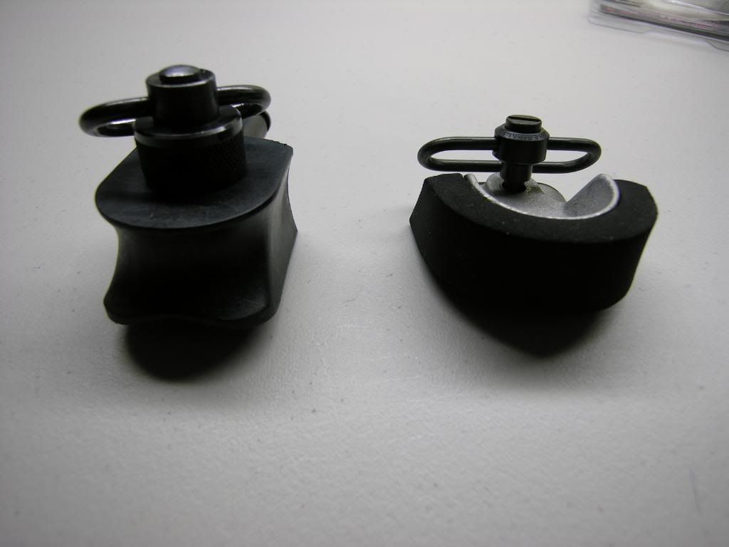

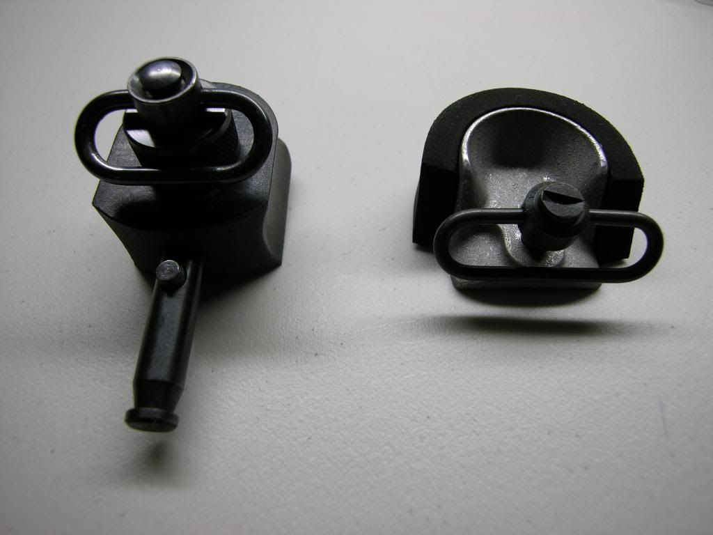

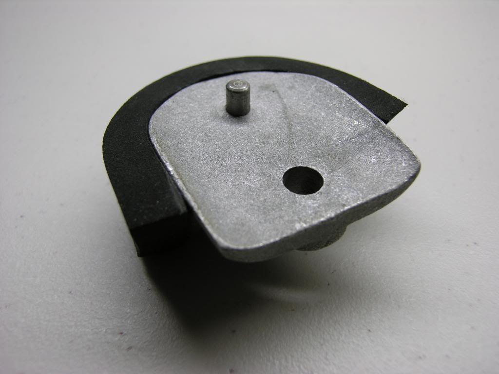

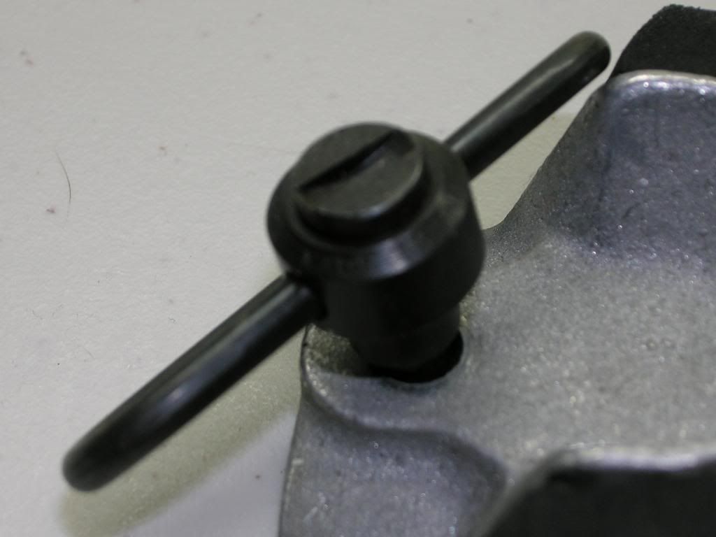

Here's the pics as promised guys:
C3A1 Left - C3 Right
C3 Handstop alone
The CF did use the silver ones as well as the blackened aluminum

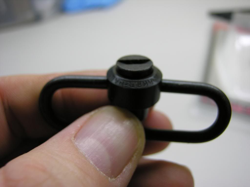

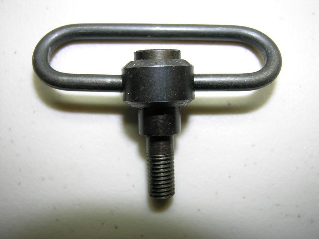

C3 Sling Swivel
Hope this clears up the confusion.
