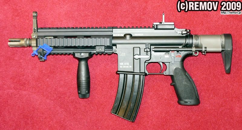

This is supposed to be the Canadian PDW. As I recall you have experience with this sort of thing - that micro FA, right?
That doesn't look like either of the CF PDW's that I saw but they could have experimented with a bunch of different stuff. The big problem with an AR based PDW is the buffer tube, which is difficult to get rid of. Our system is buferless so we were able to reduce the length of the "buffer" tube by the length of the carbine buffer plus the compressed spring. It took a bit of work to get it to cycle reliably but the system works perfectly now. It is lots of fun to shoot and gets lots of looks for being so small. People can't believe that an AR can be that small. :)
