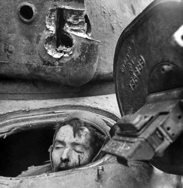

I've got a difficult time believing that ONE tank can fire that fast and hit 3x in the exact same spot - at least back in those days when the gun was laid manually. One tank shooting that kind of group AFAP under stress?? I don't know about that. It's hard enough to do that with a rifle never mind a tank gun. That said, you're the tanker, not me. I was Field Artillery.
The Panther might have been stationary, in a fixed position or immobilized.
The war diary of 3rd County of London Yeomanry (Sharpshooters) for the time reports an inspection of a destroyed Panther on 21 June 1944 (which does not appear to have involved that unit) and then an engagement on 10 July involving seven Panthers (six of which were destroyed).
The war diary for 4th County of London Yeomanry (Sharpshooters), however, reports that on 11 June 1944, they encountered two Panthers, one disabled on a road and the other providing cover. 2Tp C Sqn flanked and destroyed the Panther, while infantry destroyed the second Panther with PIAT.
(Note that these units were later combined in August 1944 to the form the 3rd/4th County of London Yeomanry (Sharpshooters)).
The theoretical maximum ROF for the 76mm in a Sherman was 20 rounds/minute. That being said, it is unlikely that in a real world situation, that 20 rounds (a round every 3 seconds) would be achieved, and if so, not for any sustained period. 15 rounds a minute would certainly be possible, especially with adrenaline being involved. That would mean that 3 rounds could be popped off by a single tank in 12 seconds. This all depends on the skill of the loader of course and not adjusting the aim.
I'm thinking anti tank gun, myself.

One Allied tank, three quick shots; one German tank, two quick shots....
While the write up regarding this wartime picture says it was struck with HE (Chemical Energy) I feel the damage, and lack of damage, is far more consistent with the target being struck with a Armour Piercing (Kinetic Energy) round. The gouges look like others I have seen in the past is where the AP projectile scallops out a divot of target armour and the dramatic transfer of Kinetic energy on the target results in the target steel shattering. Further to support this is the lack of secondary damage within the target area note that the round bin is totally undamaged by blast or spall (only valid if the turret was as depicted in the 12 Oclock position as in the pic). There is no evidence of HE spatter or spalling on either the target armour or hull fixtures and the lack of zimmert coating in the impact area looks localized due to KE rounds and the vibration/resonance of impact....
Ditto! That was my first thought--three 'shot' rounds, but despite my skepticism, I had to accept the story from the Brits (apparently not a first-hand account). No evidence of detonation. Not HE.
'BANG!'...'BANG!'...'BANG!' "Target! Cease fire!"
