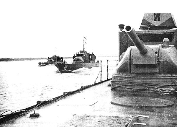

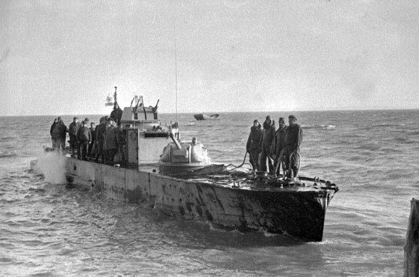

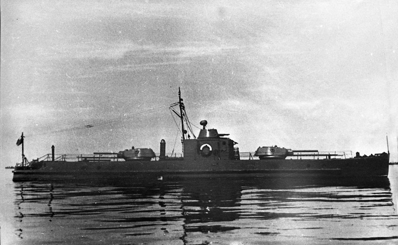

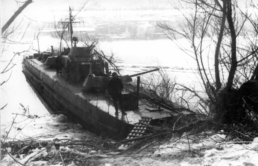

Russian armoured gunboats of WW2, or What to Do With Surplus T-34 Turrets:
