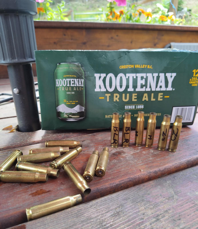

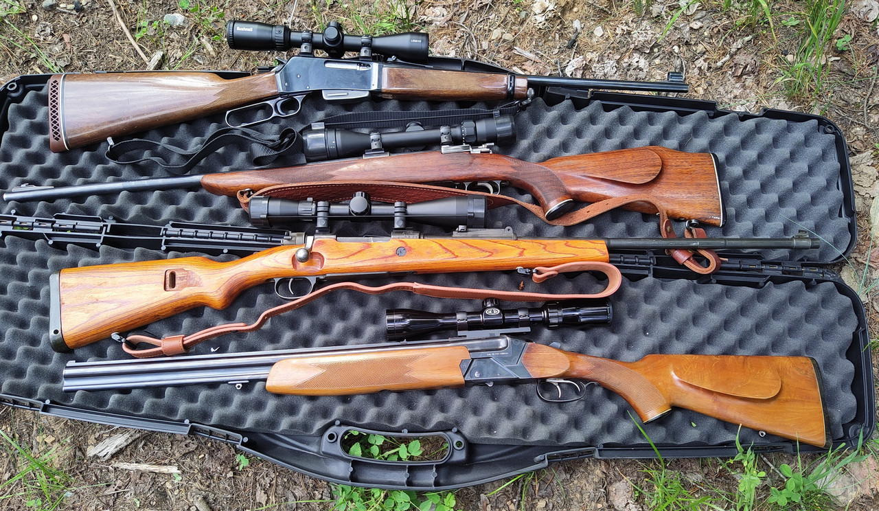

Had a bit of a field day. All the unsized brass fit in all the chambers so Im thinking I'll be ok loading for the 4. The problem rifle is still keyholing.

I didn't try to close the bolt. Just slipped the case in the chamber by hand. Went in easily. Also tried the bullet in the different cases. All were about the same tightness. The blr case was just a hair tighter

As far as testing for fit - I notice several of your rifles appear to be Mauser 98 based. If those have original military extractors, you are not going to feed a round into the chamber and close the bolt - the original military design will not let you - the round HAS to come up from below the bolt, in order to "control round feed" - that can be defeated, if someone has ground the leading edge of the extractor claw - that removes material and likely makes that original claw weaker than original design - but then that mod does allow a "single" push-feed type loading.
If that is original extractor - is easy enough to remove the bolt from the rifle, then snap a round onto the bolt face - with the rim behind the extractor claw - it will probably "click" to do so - is typical that the round stays there - then reinsert into rifle and close the bolt. If you have that type of extractor, you ought to know about it. If you wanted to fire "just one round" - you would have to snap that single round into the magazine, then close the bolt - you will "jam" if you put that one round directly into the chamber. Many commercial Mauser types had their extractor modded at factory when they were made - but a subsequent owner may have installed an unaltered mil-surp replacement.
One is a Mauser 98 Israeli rebarreld to 308 Nato the other is the Marlin w Belgian FN mauser action. I've read about the extractor mod but haven't checked for it. Ill take a look and also try the taking the bolt out and loading the empty case on the bolt.
from what I understand the chamber size is the same for nato and 308 win. The brass wall thickness is different
Doesn't look like they have been moded. And the bolts on both Mauser do not close with the cz and blr case. The last 1/8 or so is too tight. So will still need the full length sizer. Both Mauser will interchange and close and eject but might be a bit tighter

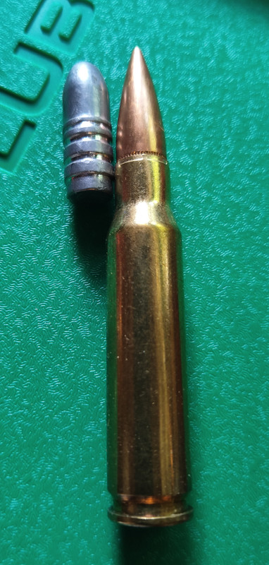

Planning on just using cast bullets. Now I'm wondering if there are different size 308 molds
Is possible that various molds will throw different diameter bullets - might be maker's tolerances, or the caster's melt temperature or even the alloy that is used - can all make the bullet slightly different size coming out of the mould - is why a "sizer" is so often used with cast bullets - force a cast bullet through and all are the same size. For a 308 Win / 7.62 NATO, would be common to use a .309" sizer, or even .310" in some cases - I suppose some people even go to .311" size. Although I have not done so, is also possible to make cast bullets larger diameter versus "as cast" - by powder coating - but, so far as I know, still need or want to size those bullets - to assure they are actually round, among other reasons - that is often the step where the gas check is applied and crimped tight - also usually when the bullet lube is applied, if it uses that.
Is several sizing systems - Lee and NOE make a push through sizing die that goes on your loading press - with a push rod that goes where the shell holder normally fits - that forces those bullets to whatever size that sizer is - often used with powder coating or a Liquid Alox type lube ("tumble lube"). Lyman, RCBS and likely others, make entire separate machines called a "lube sizer" - need a specific size die and specific bullet nose punch for the bullet that you chose to use - usually that injects lube into the bullet grooves at the same time. I think Star makes or used to make a similar one, except on a Star the bullets go into the sizing die nose first, not base first, like Lyman or RCBS, so a Star usually uses a flat or dome faced push punch. All systems have the capacity to seat and crimp the gas check, although each does that a bit different than the others.
Becomes the issue about how big is the neck part of your chamber - relates to how fat you can size your bullets and still chamber them - was a thought among some to size the cast bullet to the throat size in your chamber - others will advise to size your cast bullet .001" or .002" larger than your groove diameter- those two thoughts might amount to the same thing. Since you are trying to do this for four rifles at the same time - is likely you need to figure out which is smallest chamber neck and load for that - it will then fit in the others.
