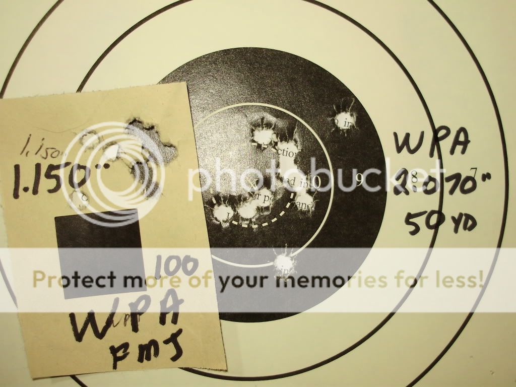

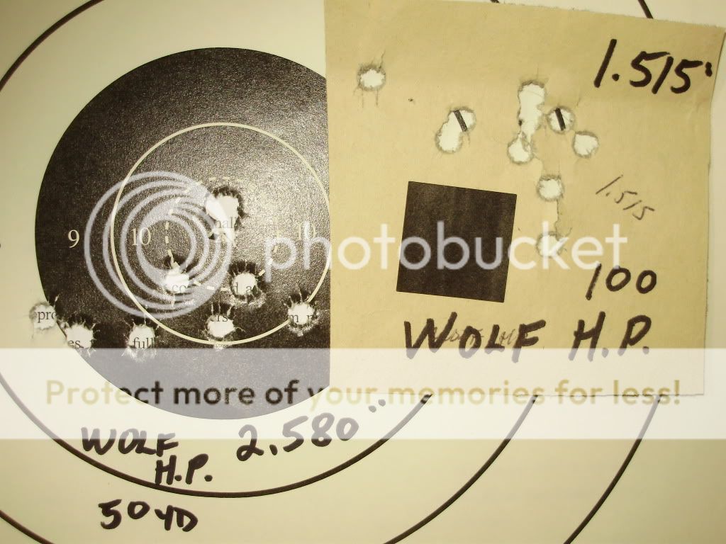

I am satisfied that this test is a fair test of the grouping ability of the ammo. The next question is “How does it shoot in a real rifle?” I decided to test it in my CZ858, since it is more accurate than my SKS. The other half of each 20 round box was shot in the CZ858 at 50 yards. I wanted to do it at 100, but found that the SPARC red dot covered the round pistol target aiming mark. At 50 yards the little red dot fit inside the aiming mark perfectly. The aiming resolution was not as good as a scope would have been, but I think it was fairly accurate.
In the CZ test the 50 yard groups (average about 2.00”) were about the same size as the Remington at 100 yards (average about 1.9”). I only fired 5 different brands of the milsurp ammo in the SKS. I wish I had shot the Polish, too, to see if it also shot poorly in the CZ. Maybe next time.
In these pictures you can see the Remington 100 yard group and the CZ 50 yard group with the same ammo.
