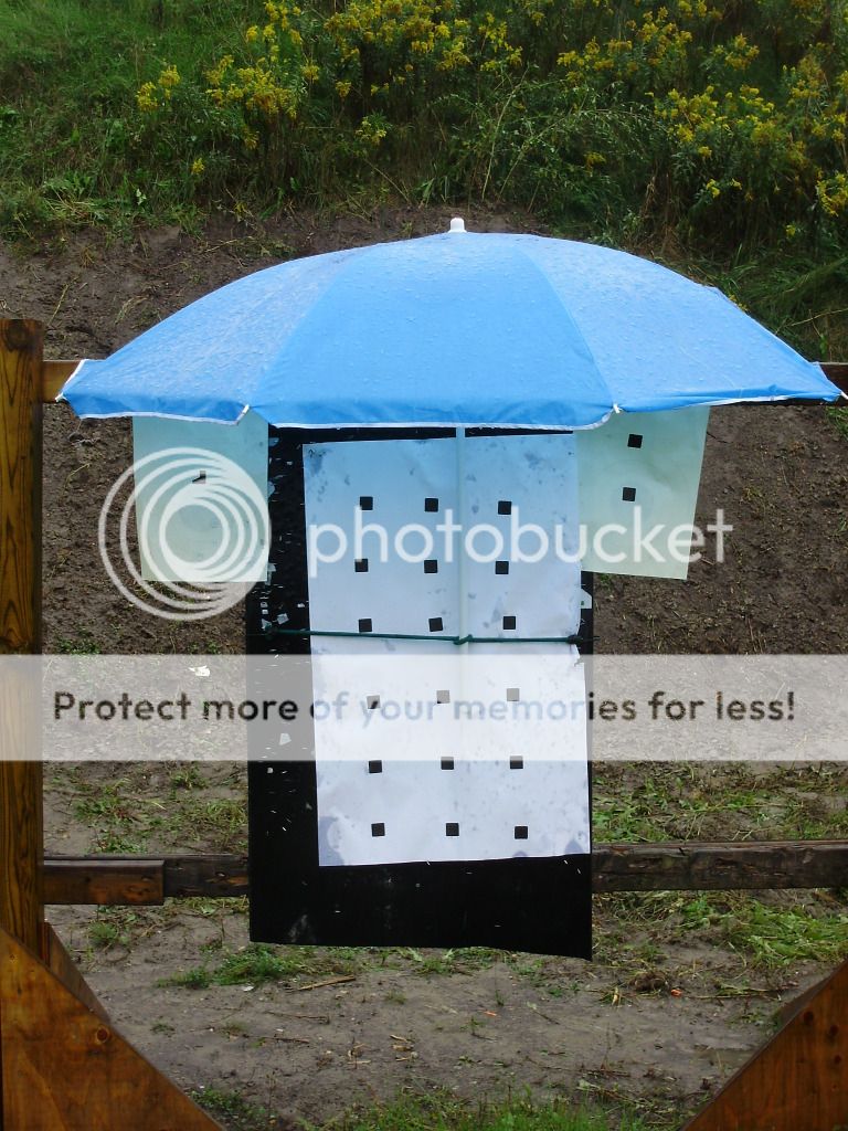

It was raining today. Good news is that meant range was not crowded. No waiting for a bench. We solved the wet target issue:

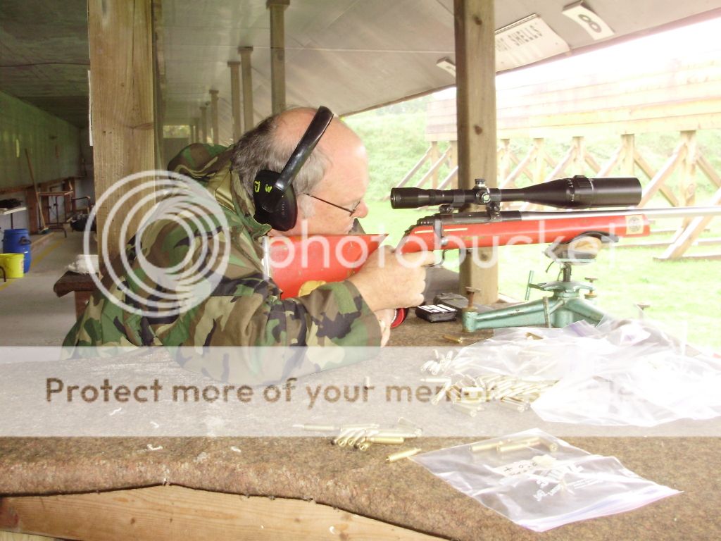

I added a 223 target rifle to the mix as a control test of ammo. If a rifle groups 2", maybe the ammo is only capable of 1.5", at best?? The target rifle has a good chamber, barrel and trigger, so indicates how the ammo performs.

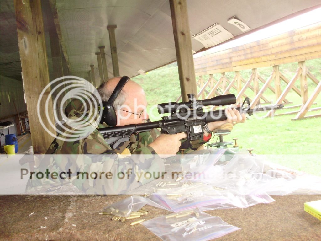

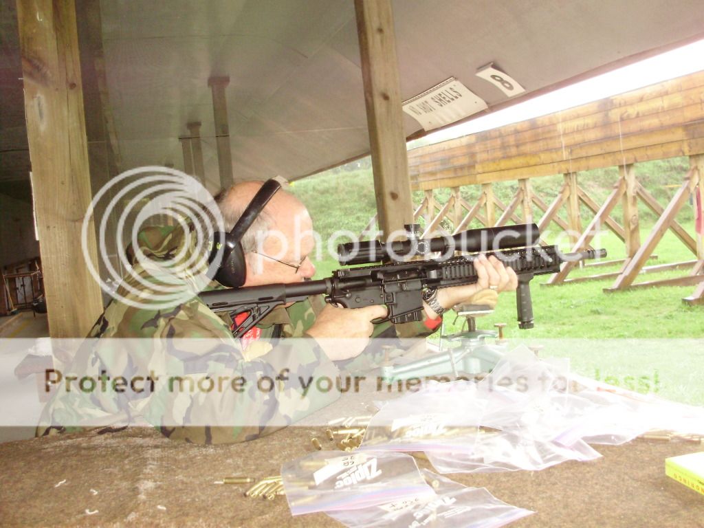

Each rifle was topped with a 20X target scope and rested for maximum accuracy.
The rifles are a brand new Danial Defense V5 (16" brl) with about 200 rounds through it. My Norinco M4 (12.5"brl) is a year old and has about 2,000 rounds. The Norc has a floated barrel (like the DD) and I have added a Rock River trigger.
