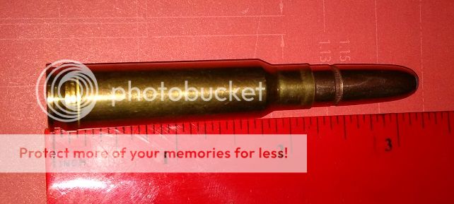

For comparison, the 350 Rem. Mag. SI (Slamfire Improved ;)) boasts a COAL of 3.200". On my to-do list to see how fast I can safely fire 200gr TSX bullets. I would conjecture ~3100 fps.
350 Rem. Mag. SI round with 310gr Woodleigh bullet
