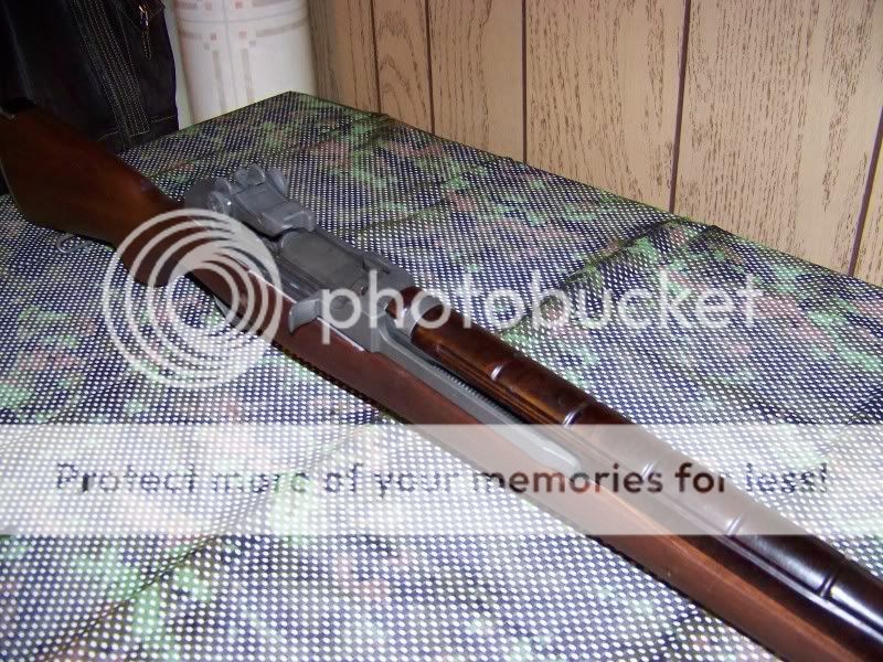

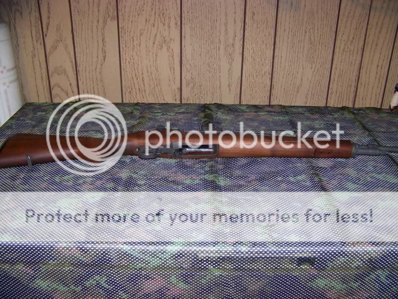

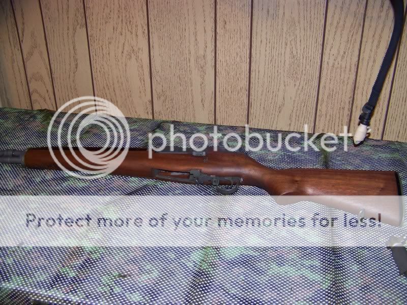

As you can see this is the right side of the rifle on top you can notice a crack running fro the forward edge of the mag well forward 9.5 " to the front ferrule.
There is no Visible damage to the left side of the stock

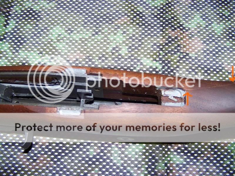

Picture showing upper side of rifle Crack on right side forearm of the stock hardly noticeable

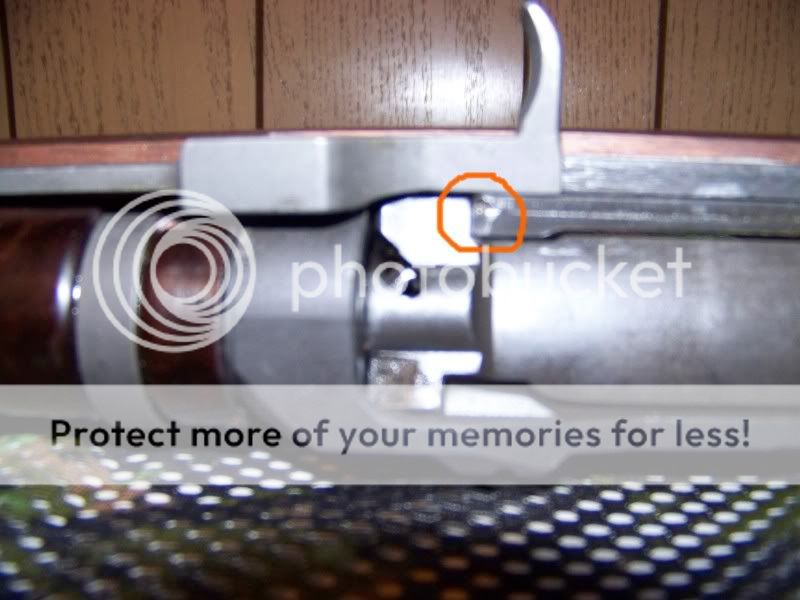

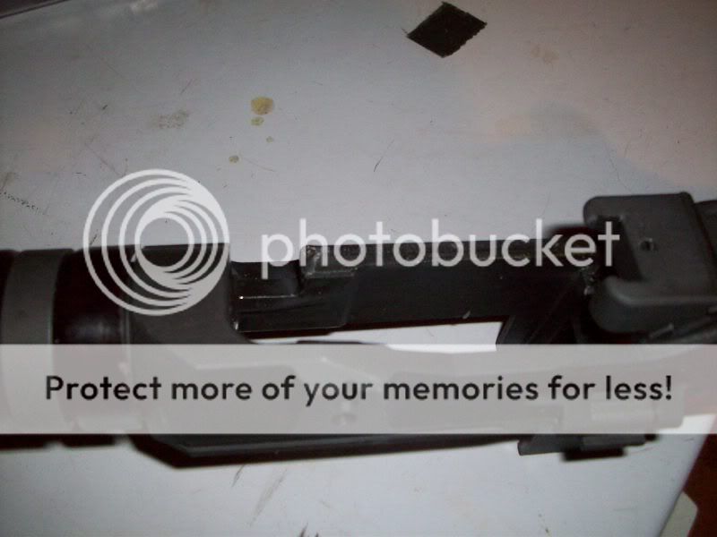

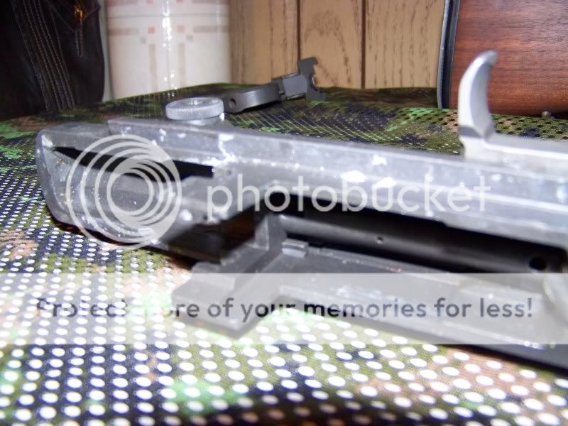

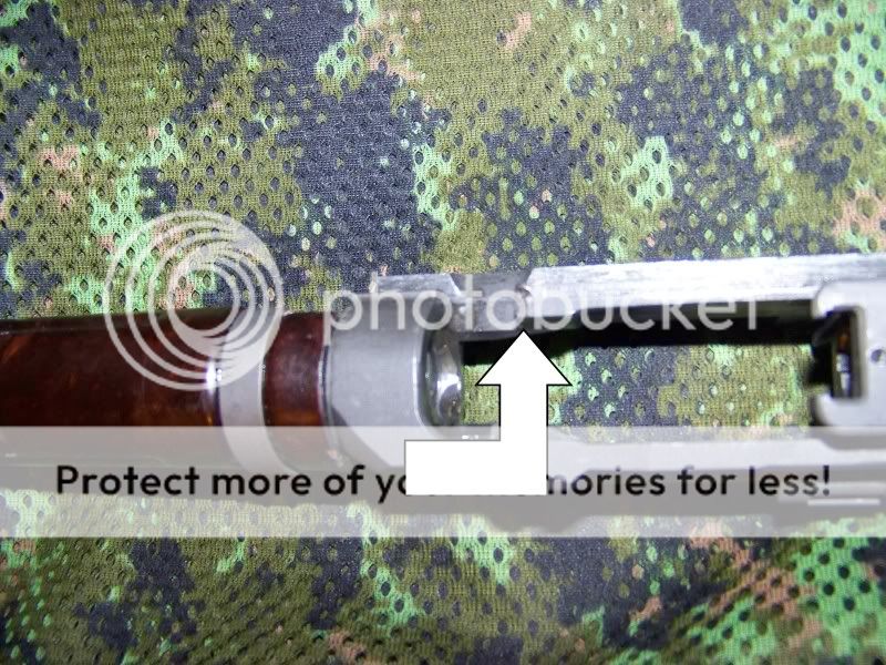

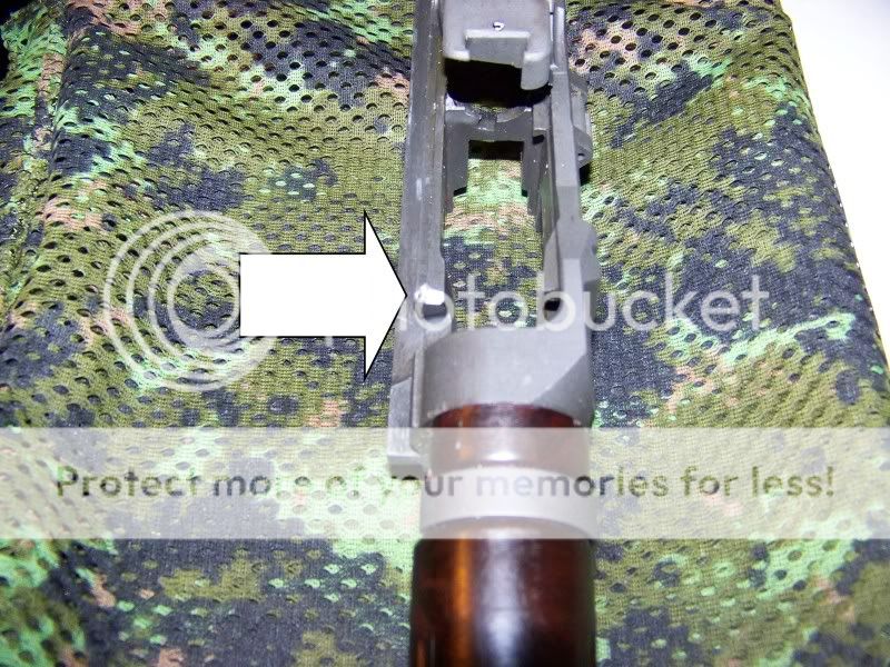

This picture clearly shows the damage to the Right side receiver lug

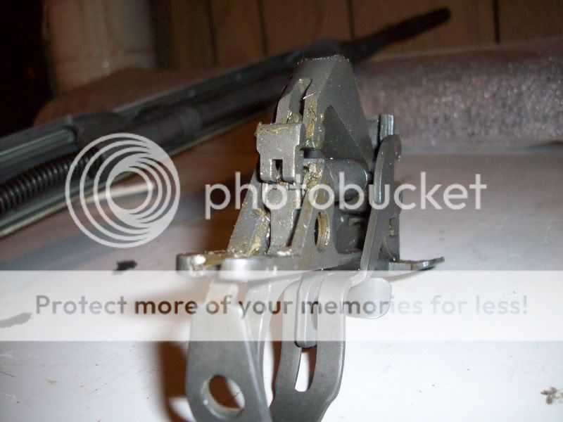

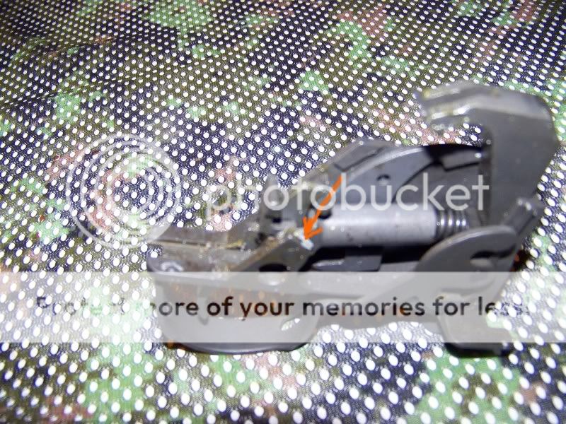

At this point a I removed the trigger group and inspected the trigger group for condition and function
In this picture you will notice several flecks these mainly consist of Brass and Bedding compound the trigger group is well oiled and there was no cosmoline present
another picture showing the above mentioned
Note arrow is indicating a piece of bedding compound

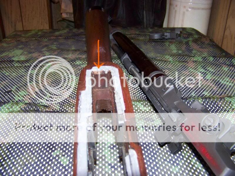

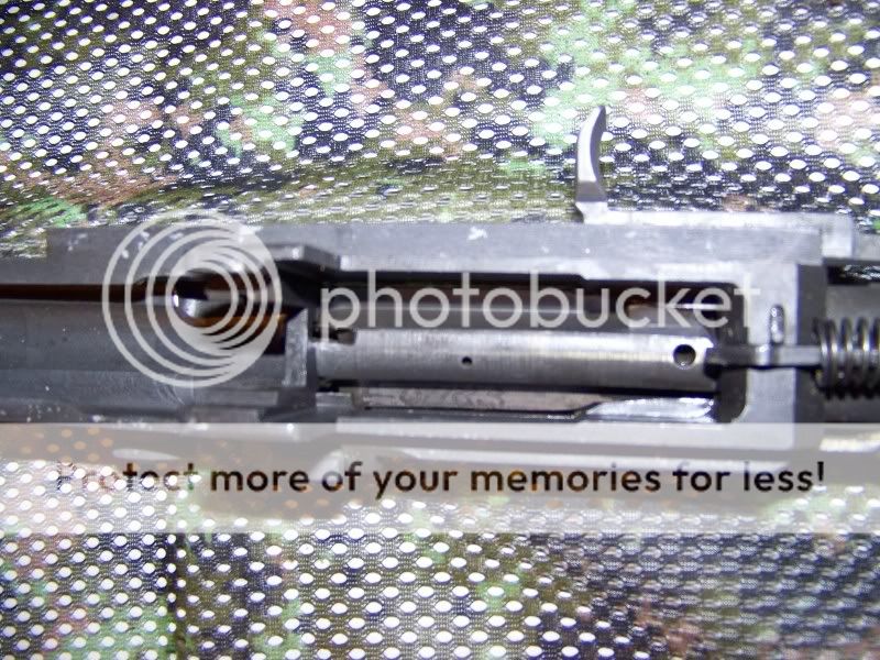

I removed the receiver group from the stock .When I removed it several pieces of bedding compound and one small piece of the wood stock fell out I then removed the Op Rod assembly and the bolt

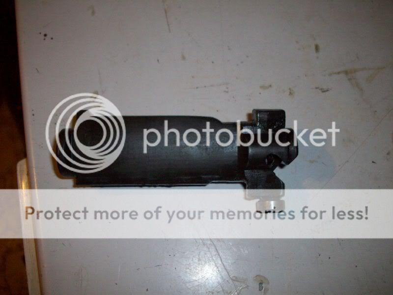

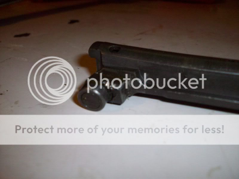

The Bolt

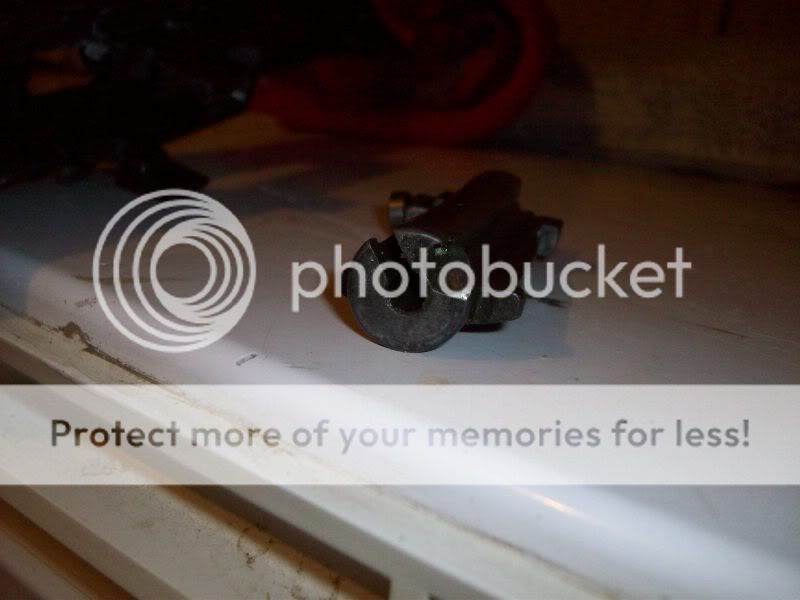

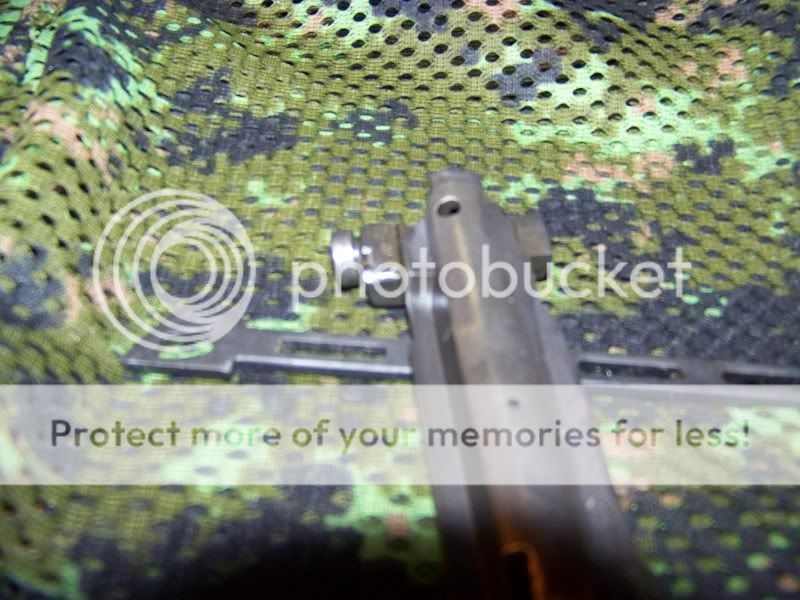

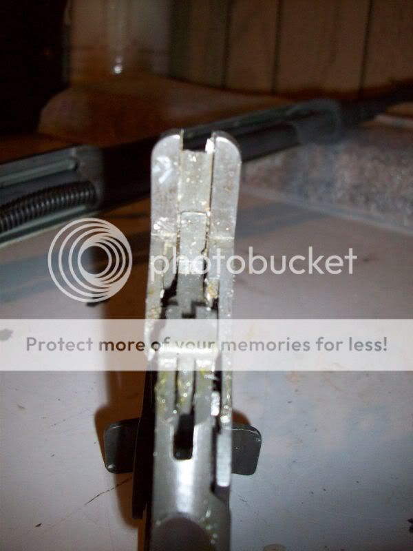

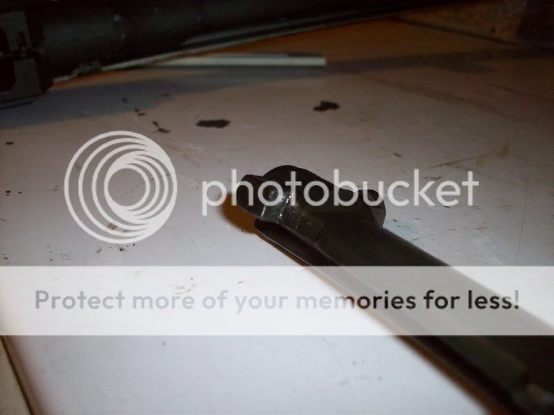

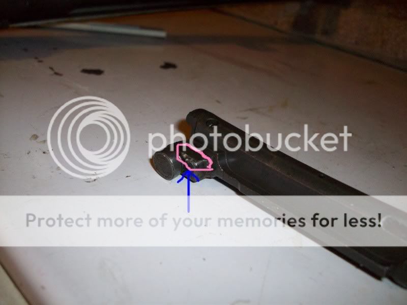

The bolt appears to be well lubed,no cosmoline is present missing Firing Pin , Extractor ,Extractor Spring and Rod, and Ejector Rod .Ejector Spring. Bolt Roller damaged will not turn freely .Damage to the right side rear lug bottom from left to right edge and forward .750 " with a width .075". there is no damage to the left side bolt lug
Indicated area of damage on the Right side bolt lug
Left side bolt no visible damage to the left side Bolt Lug
Top view of bolt
Note bedding compound deposited in the rear of the Bolt it should be also noted that the rear of the bolt is discoloured and had bedding material impacted on to the rear of the bolt.

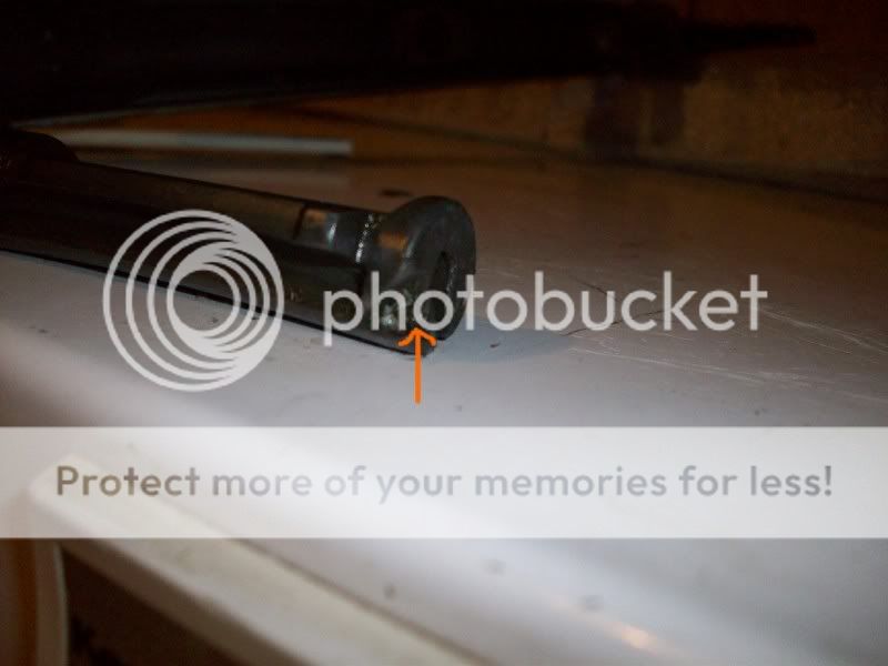

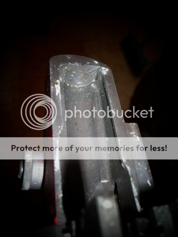

The top of the bolt you can see a bright ring that is semicircular this is a strike indication and just inside this area was impacted bedding material there was also impacted bedding material found in the Heel or rear of the receiver as well .
The receiver appears well oiled and lubed excessive bedding material and small flecks of brass found thru out receiver. noticed impact on the inside of rear receiver heel that consisted of bedding material in the outline of the bolt
Picture showing bedding material present
Picture indicating bolt strike area
Picture of bolt strike area
Picture of top side upper receiver damage to the right side receiver lug
In these pictures as indicated are the damaged areas of the receiver the damaged area .260" wide x .160in length and a maximum depth .100"

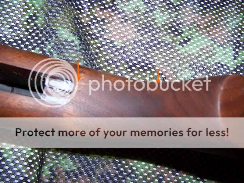

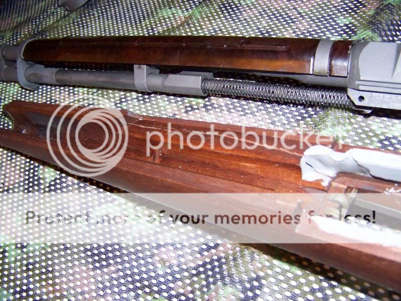

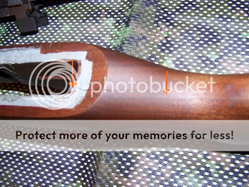

The stock received damage that ran forward of the magazine well on the inside right moving forward 9.5" to the outside of the right side of the stock .Damage to the rear of the stock was found this damage was caused by the Bolt impacting both the rear heel of the receiver and the stock.The crack moved towards the butt stock 2" on the top directly behind the receiver heel and on the bottom from the trigger group the crack moved to the left outward side to the rear butt stock
bottom side of stock damaged into pistol grip
crack from magazine well forward to stock ferrule
top of stock crack by rear receiver
This shows impact damage to the rear of the stock by the bolt .To the right of the arrow is the crack in the rear of the stock.
The Bolt
Top view of bolt
