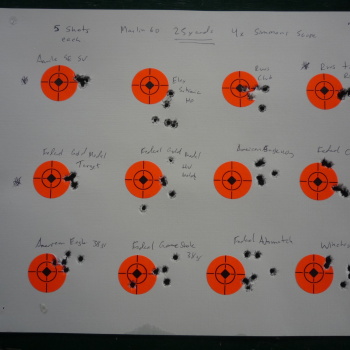

I have a Marlin 60. It's been very reliable with all kinds of ammo except CCI Quiet. Accuracy is impressive. With the right ammo one hole at 25 yards with 4x scope.
