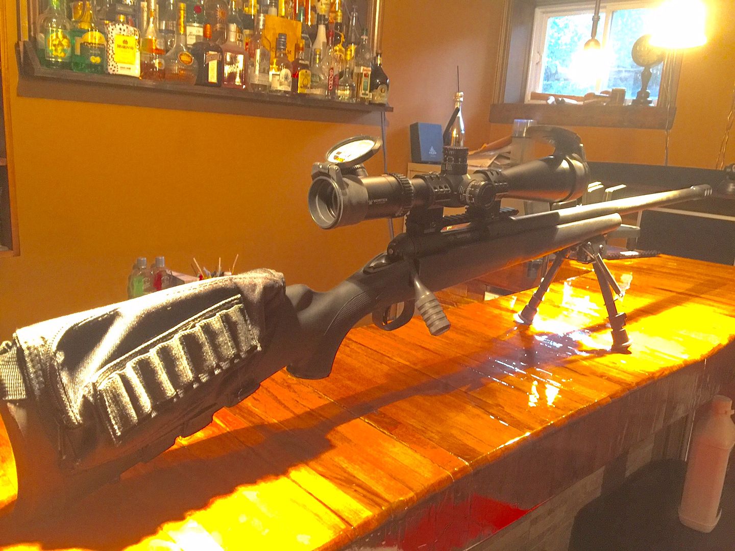

I bought a cheap brake for my TR from Mustard. Haven't installed it yet. Anybody use one of these?

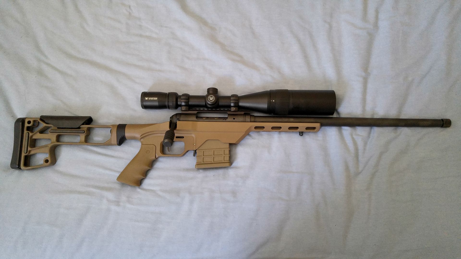

Been look at new stock for the Savage 10TR, built a sub moa load with Varget and 175SMK so its possible with just the standard stock
I have a SIII 8-32 on it as well and a M11 Severe Duty Muzzle Break
Hopefully I have time I can see how it groups at 300-400-500m
Anyone with a new stock for it, any recommendations?

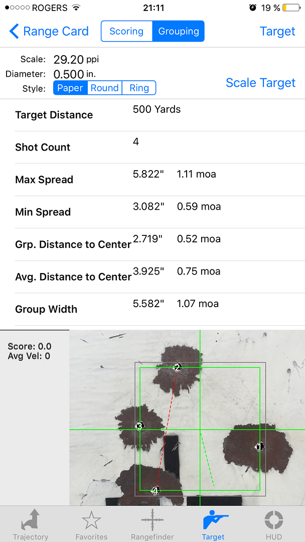

Here's my results at 500 Yards this week-end:
I'm getting more and more used to this rifle, I can surely do better. Hornady A-Max BTHP 168gr in Lapua case withIgr of MR-4895.
